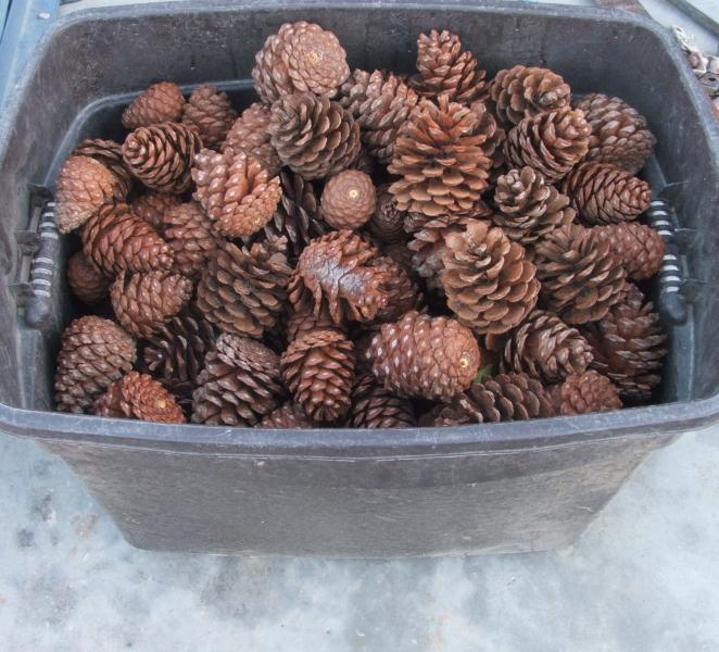

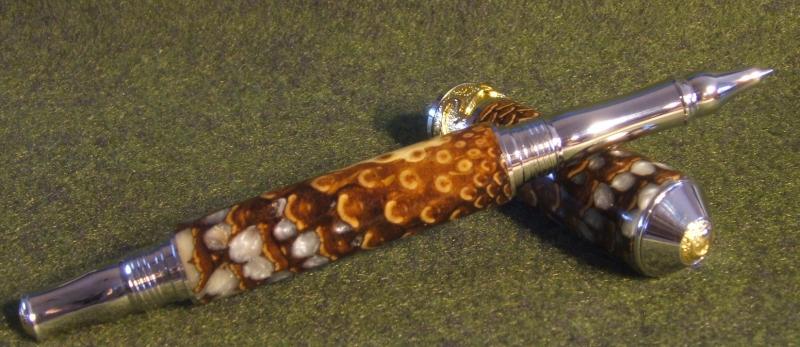

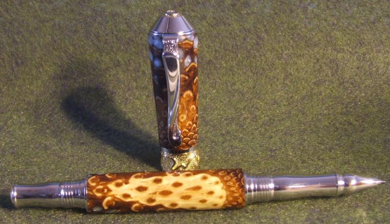

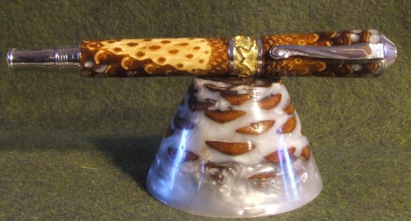

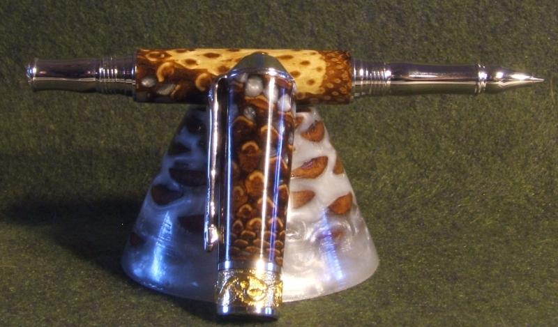

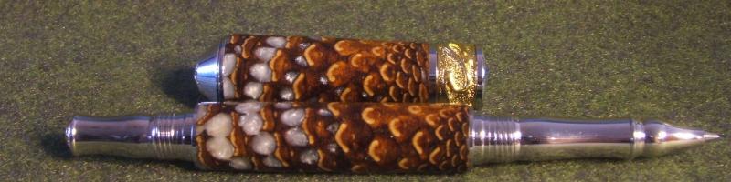

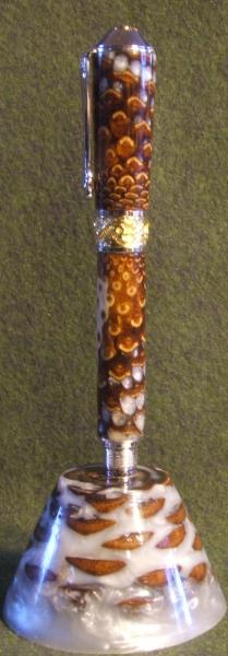

I have a friend that wanted the Sceptor in Pine Cone, and it had to be his pine cone from his yard. Since this is my first one, I did not know what to expect, I knew that the pin was big and the cone was small. So I chose two cones that had opened and dropped their seeds, used CA to stabilize them. After Squaring them up I cast them with white pearl using a PP. I did not want the pen laying around getting beat up so I cast a whole cone in white pearl and using my handy dandy pendent jig turned the base. Both the pen and base have a CA finish. We have already struck a deal, but what do these pens normaly sale for. :question:
Any comments Welcome, Thanks for looking

That is an extraordinary combination! you're getting pretty fancy with your pine cones. Given the cost of the kit and materials, the pen alone should be around 95.00 to 120.00 If your market area still has what we used to call "disposable income" around here it's all been disposed of. I'd think the base should be worth another 25.00 or 30.00 so I wouldn't feel bad asking around 140.00 for the set.

I work in SE Texas and there is no shortage of pine cones here. Is there any documents here that cover the stabilization of pine cones? BTW, that is an INCREDIBLE pen!!! Is the base made of pine cone cast in alumilite?
Yes it is Alumilite, and all I did was add white pearl powder to it. I used a 4 oz serving cup (plastic) like you would get in a restaurant but the alumilite got so hot the cup distorted, but it held. and the cone was fully opened and had dropped it's seeds.
