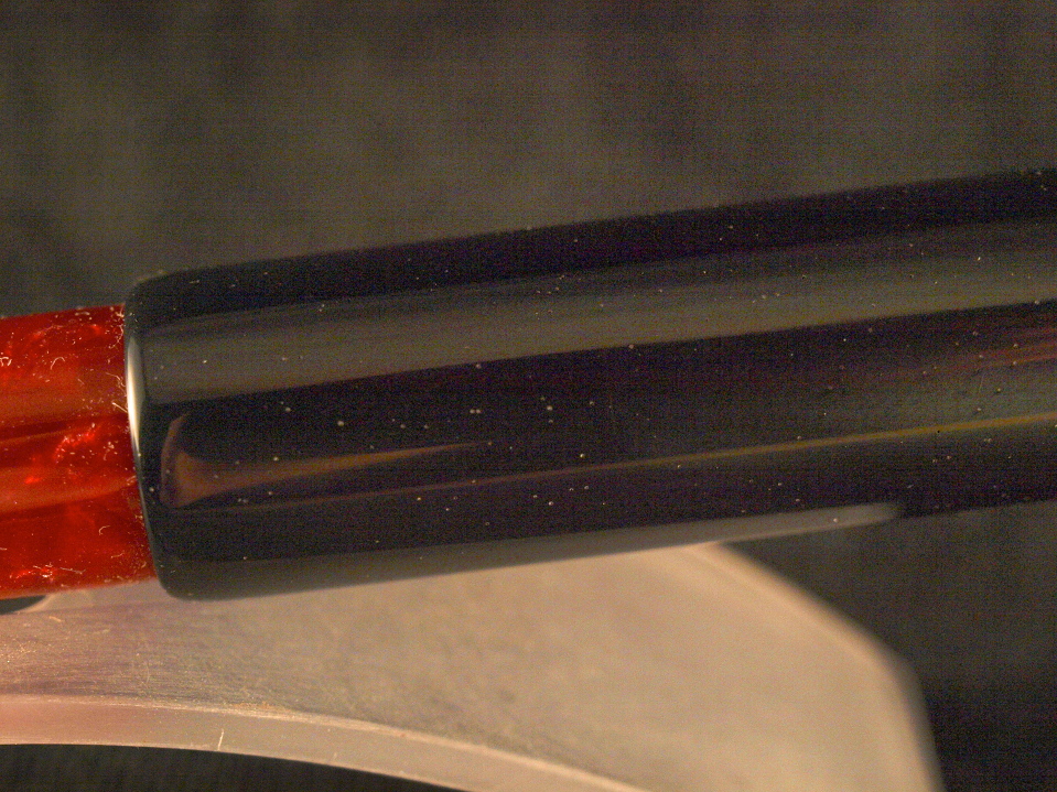

I just finished an Alumilite black cap. I has a lot of pinholes in it. Does anyone have recommendations for fixing it? Can I fill it in with CA and finish like a wood blank?

Ca will work . Might need several coats of medium after a thin , depending on size and number of holes . If you see an area where the sanding dust appears to be clinging to the blank , you have probably sanded through the CA at that point , as the CA and the Alumilite hang on to the dust differently .
