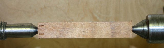

BTW, the last few I've made I used a dead center and live center and it is working fine. When I wrote the pentel article I could not get this method to work for me...but I suppose my turning skills have improved over the years. Take a look.

After I get the process patented I'll sell you the instructions but until then my lips are sealed.:D:D[:p][:p];)

Originally posted by leehljp
Don,
Could you teach me how to turn a block so that it is square as you pictured above? I could eliminate my table saw! :D
