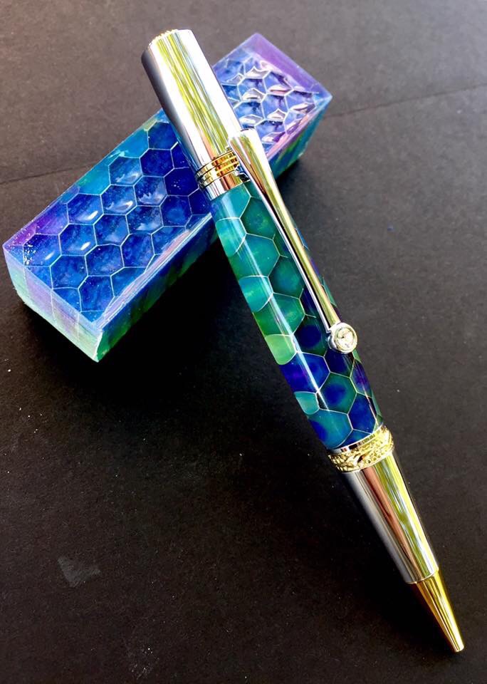

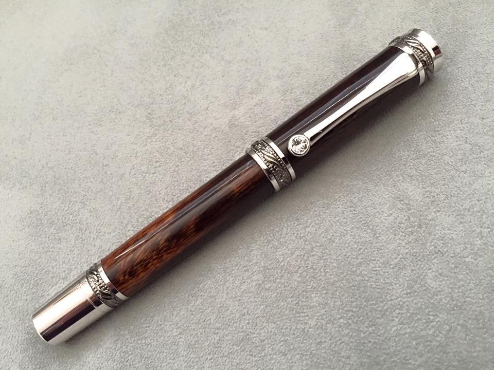

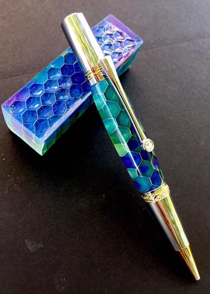

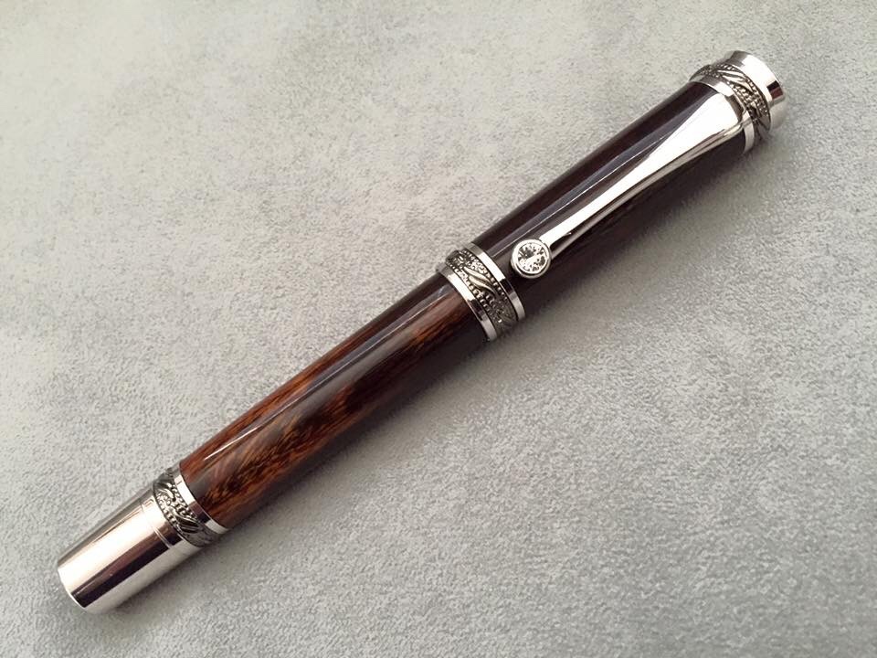

Yes there are a few kits out there that have swarovski crystals in them for decoration and at times it is nice to change them out to match the blank better because you are limited on what they sell. They have become known as pimp crystals because they pimp up the ride. :smile::smile::smile:
