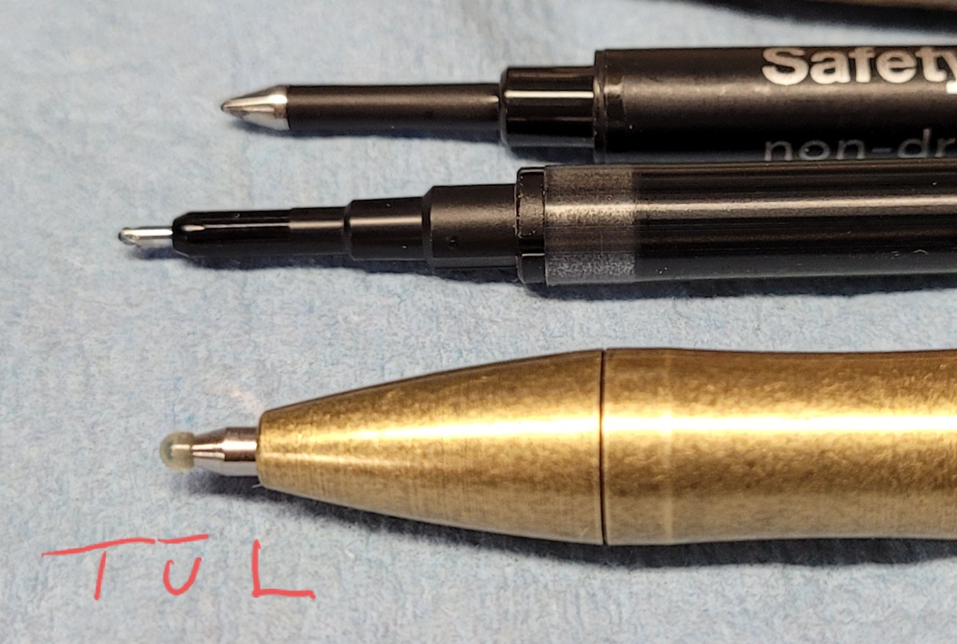

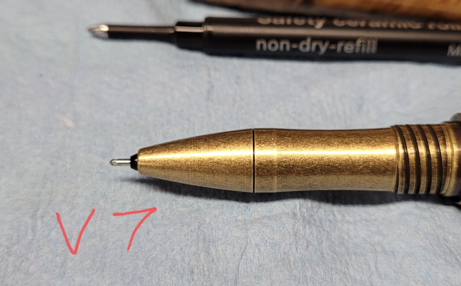

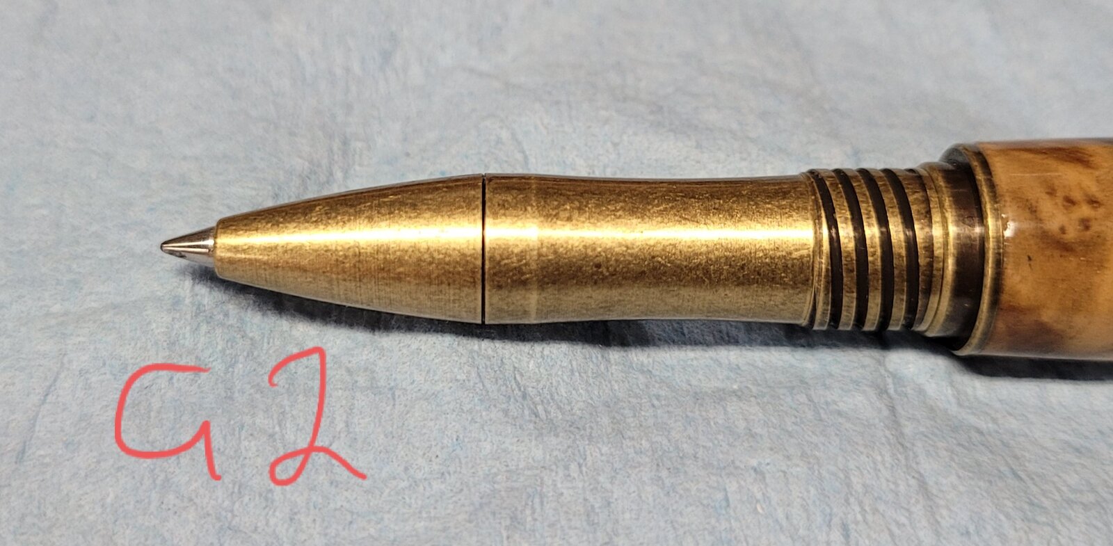

OK, I am a little slow, but here are the results in pictures. The G2 is the same length, but seem to have a less sharply angled cone at the tip. The slight cone, more like a chamfer, on the V7 sits in about the right spot, but that needle tip... not terrible, but definitely not pretty in my opinion. The Office Depot brand will work, but I don't like the extra length on it. Nobody is going to buy a hand made pen only for functionality.
