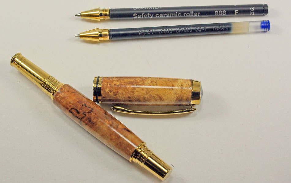

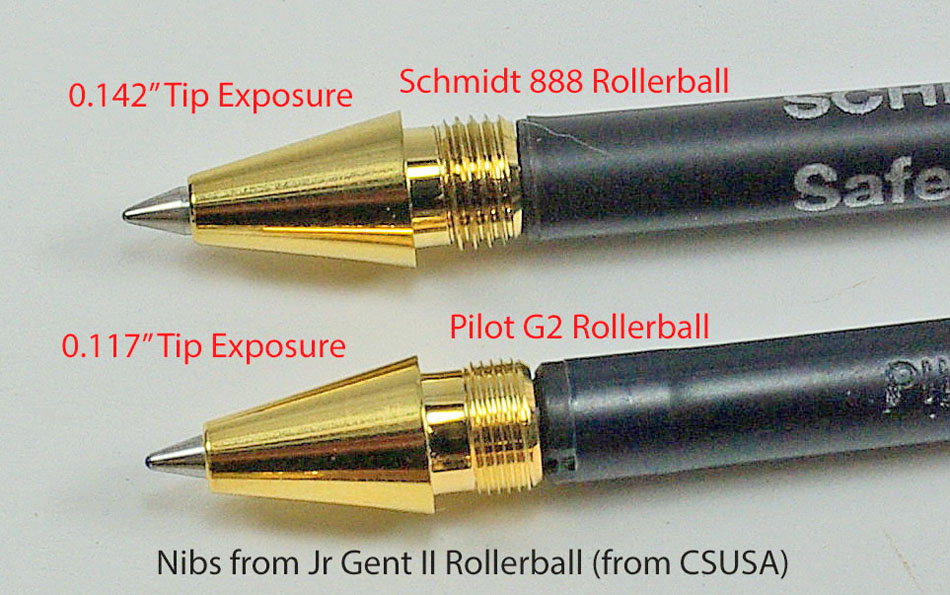

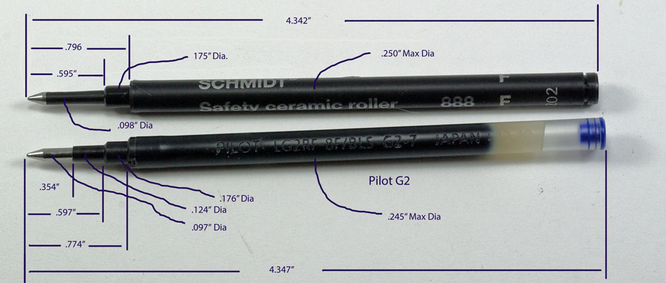

I have been searching many threads here on whether a Pilot G2 Gel rollerball can be used in a pen which would normally use the Schmidt 888/5888 refill. As many have found out, it does fit, however there is a subtle mechanical difference that may matter to some. The Pilot G2 extends beyond the tip of the nib by 0.020" less than the Schmidt. The pen I used was a Jr Gent II from CSUSA. It's a seemingly small difference, but is noticeable.
I documented the two sided by side and posted the pics in case it would be of interest to anyone contemplating the same situation.

Did you like how the G2 wrote? When I tried it I thought the G2 was not as smooth as the schmidt.
I'm not very experienced with rollerballs and couldn't really feel any difference. I wanted to try the Pilot refills since they don't need to be capped and may open up other possibilities.
People like what they like. Some people are in love with the g2. I like it too but not necessarily more.
I usually tell people that it will accept the g2 if they prefer.
The tip exposure doesn't bother me any.

One reason to get Pilot G2 is finest 0.38mm model which is much thinner then 888/5888 Fine (0.6mm). And I'm asked about it sometimes.
