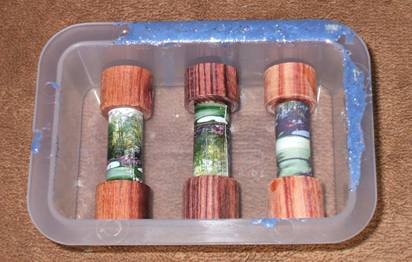

Like this?
<br />
Printed this on photo paper, cut down center of blank, glued around and cast resin as Don suggested. Have also printed pictures and patterns on label stock, stuck to tube and cast clear resin around.

Originally posted by BRobbins629
<br />Like this?

I turn the blank round, but proud of the bushings. For the Euro style pens, the indent O.D. is approximaely .100" to .150" below the final O.D. of the pen.
Turn
<br />
Mount Picture (shown on lathe, but I take off to mount)
<br />
Cast
<br />
Roy99664
