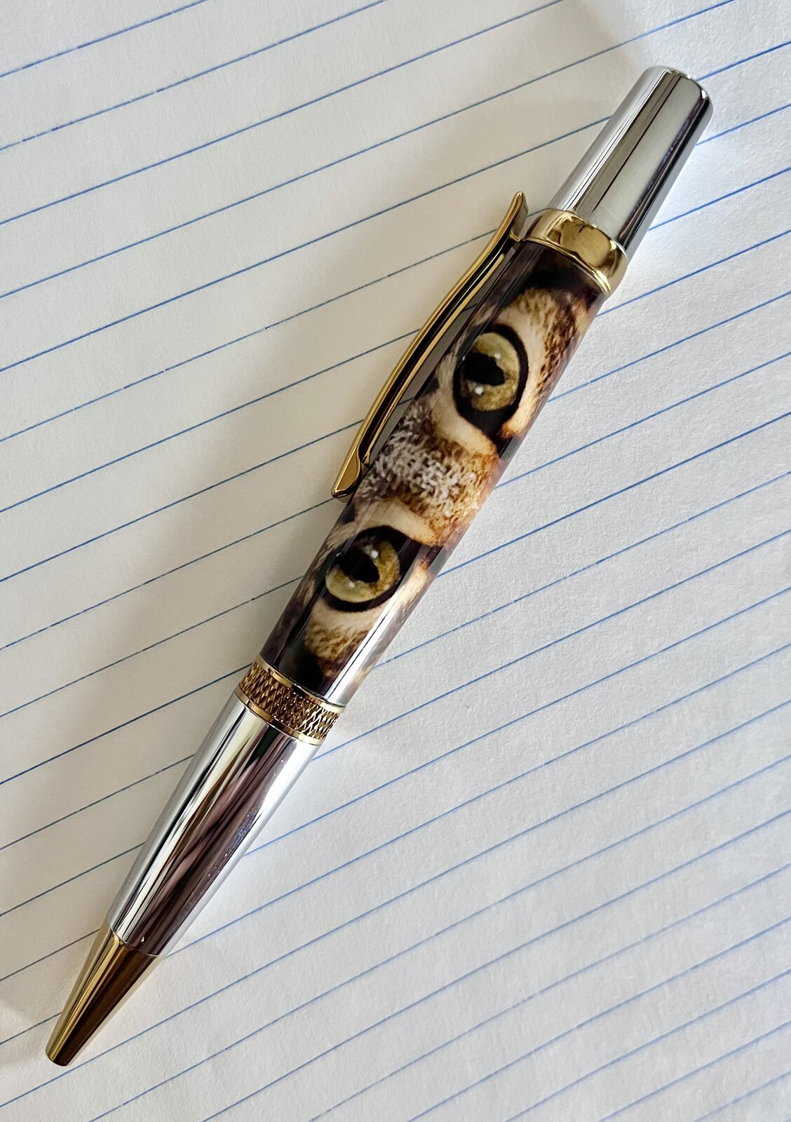

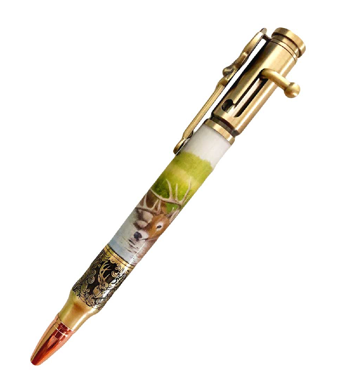

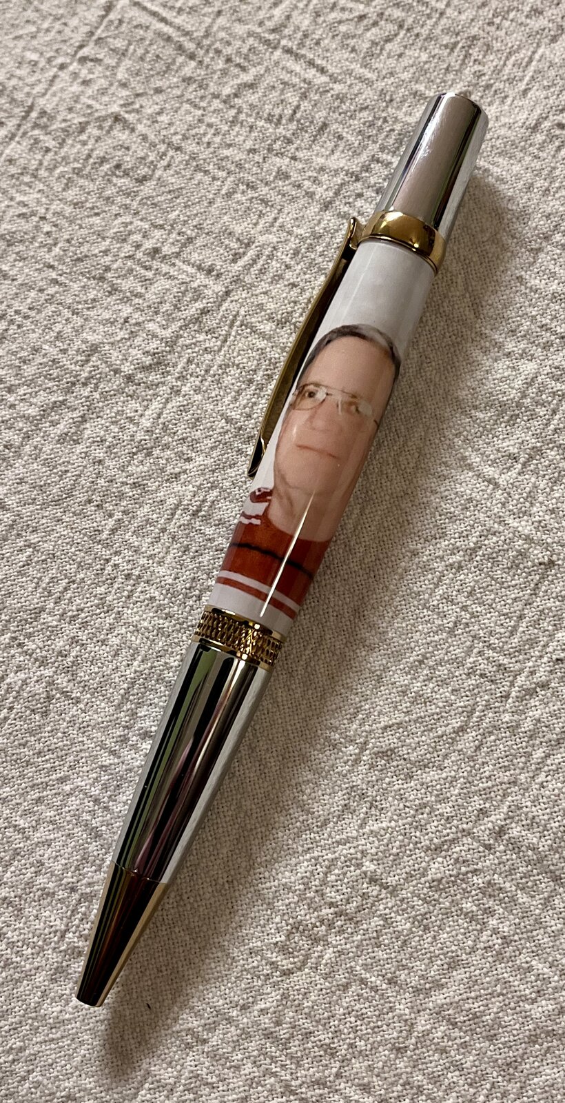

Label casting has been popular for many years and lots of people do it with logos, pictures and other images. Marks video is exactly what you need to make your images work in resin. Casting them is the easy part. Just be sure not to touch the edges with your fingers while putting them on the tubes and leave an overlap of 1/8"-1/4".
It's basically clear casting over a printed label. Sky's the limit. I would recommend using alumilite clear slow if you're new to casting.
