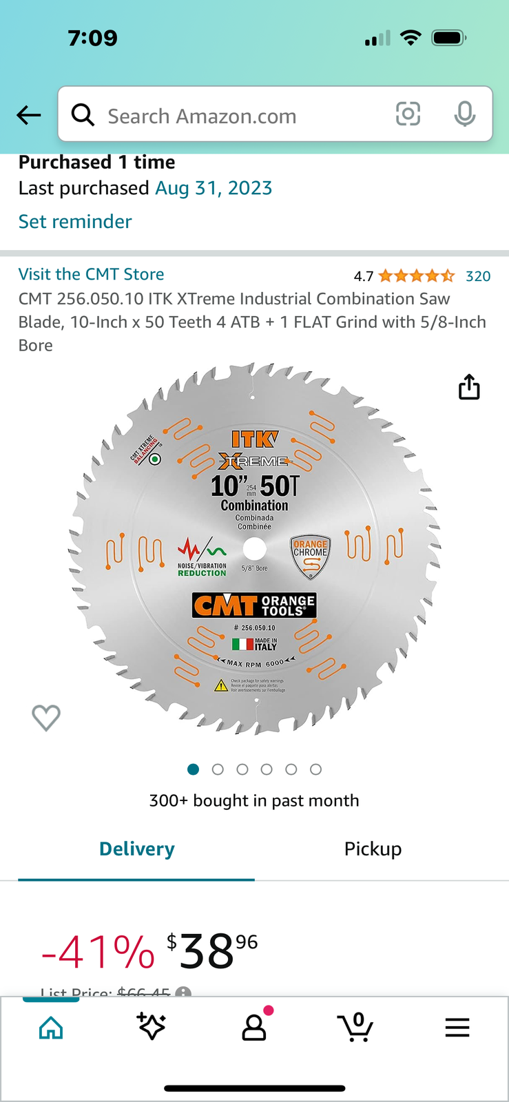

I seen these and decided to give them a try, after reading positive reviews. They are sharp and cut clean, however they are not as stiff as Freud's. I wouldn't recommend these from CMT.

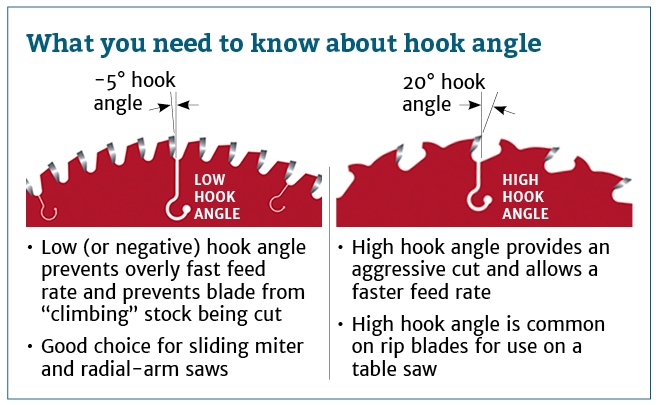

Look at the teeth and see how they lean back slightly. That is called a negative rake blade. They also make zero rake blades. A tablesaw blade will say crosscut not cutoff, or it is a rip blade . It will have a positive rake. Negative rake blades are used on mitersaws and radial arm saws because they are safer. remember I called a mitersaw a chop saw, they are also called cutoff saws. A tablesaw is never called either. Yes many times the Freud line will have info on the blade or the packaging telling you what they are meant for. The negative rake blade can be used on a tablesaw but many times is used to cut plexiglass and nonferrous metals like aluminum. They will cut slower and require more effort to push materials through . On a mitersaw or radial arm saw the blade is moving and not the wood. so the effort is not needed. You bring up circular saw and that is different than a tablesaw and a mitersaw because you are using a fixed blade but are moving it into the wood so you want a positive hook blade. Can all these blades be interchangeable, yes they can but will perform differently on each tool. Again as you started this I told you there is many different types blades out there and most are specialty blades. An ATB (alternate top bevel ) is the tooth configuration . The HI ATB blades have steeper angle teeth that cut at a different angle into the wood but are prone to dull faster because of how the teeth are sharpened. The steeper the angle a blades teeth are the more it grabs the wood. There are blades for all kinds of cutting. For what you want a good 80 tooth crosscut ATB blade is the way to go for a fine cut. they run around $70. A 60 tooth blade will also do a great job. They are a little less$$ If I have to make real precise cuts I go with the 80. I use Freud. I also recommend thin kerf blades.

Here is a comparison of blades between Miter saw and Table saw:
Miter saw Blades with negative rake lessen the chances of picking the board upwards as it cuts. This is because the blade is on top and cutting backwards from the cutter.
The short answer: On a Table saw - a negative rake would increase the chances of a kickback because it would tend to have more lift the board, where as a positive rake would be pulling the pulling the board downward on the cutting stroke.
John; This is absolutely true! I had a slide miter saw that needed the blade sharpened. Despite putting explicit instructions that this is negative rake saw blade the guy put a positive rake on the teeth. That saw bucked like a bronco! I had to replace the blade because there was not enough carbide to put the rake back.
With so many different style blades and teeth configurations, it is imperative to find a good place to have blades sharpened. They have to have the proper equipment to duplicate the shapes of the original teeth. They have to be able to grind consistently and accurately or else they will throw the blade off balance. They could damage the brazing and the teeth can become projectiles. I had such a place and recently he never reopened after covid and that was disappointing. So I would have to do a search for a new place when I need blades sharpened. I save a bunch of blades to get sharpened at one time and have to say I have quite afew.
Hank backs up my response to you Jon with his link and comments. How a blade is presented to the wood determines the configuration of a blade. This is why in another post here I said many people use a tablesaw blade in a miter saw and yes have been lucky to get away with it but it is not safe. they make different blades for reasons or else they would make far less blades and just interchange them. The same goes for bandsaws. That is why I said do not bring bandsaws into this discussion. Good luck.

I am seeing the hook angle specified on some of these now. Interestingly, its not specified on all...on some, like Diablo? I am now a bit wary of the Diablo blades I was looking at, as they all say "Miter, side miter and table saw", and as far as I can tell they don't specify hook angle. I did find a couple of Frued blades though that are ATB, thin kerf, positive hook angle. They are labeled "crosscut" rather than "cutoff"...
I am not quite sure what positive hook means though. Positive hook is what as far as rake? Negative, or positive?
https://tungstenandtool.com/blogs/news/what-is-rake
Not sure of any more I can tell you. Hook and rake are the same terms. A rip blade will have a greater hook or rake angle than a crosscut blade.
