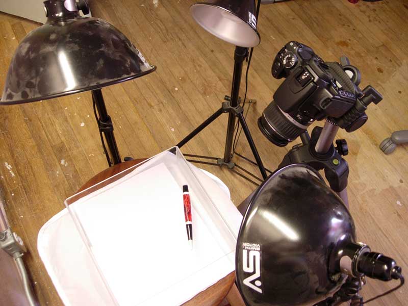

Pic of pen pic setup

This is the setup I described in my previous post showing Plexiglas stand and approximate lighting positions.

Originally posted by Jerryconn
<br />Is the stand made in a "U" shape? I can't really tell. Thanks
Yes, the whole thing is probably just shy of three inches tall and about 8 inches square.
kiddo
May 5, 2006
201
California.
Originally posted by stevers
<br />With no diffusion,(IE light tent) don't you get glare, shadows or reflections off the shiny parts?
Yes, you get all kinds of reflections and shadow and glare. That's what makes something look real and three dimensional.
If you lived inside a huge light box, everything would look flat and kinda two dimensional. Things like metal would look dull and flat and glass would look like translucent gray.

Originally posted by alxe24
<br />Nice set up. Is that the Canon XT with with the 18-55? I'll play arround with that arrangement.
What kind of lights are you using? Are you using Photo Shop for the lab work?
Thanks for sharing.
Alex
PS:I recognise that pen. You just posted a few days ago and it looks great.
Yes, thats the XTi with the 18-55 zoom on. I changed the 18-55 for a macro lens with a fixed focal length. That took care of most of my depth of field problems. It is kind of a pain though having to move the camera back and forth to frame the shot.
And yes, Photoshop CS2.
The lights are mercury photo floods. I'll have to screw one out to read the details on it. Will post that info a little later.
