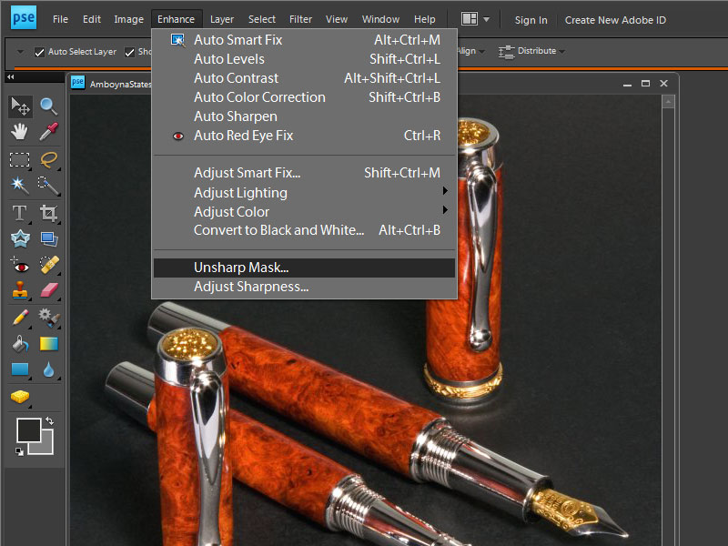

My go-to tool for sharpening photos is called "Unsharp Mask". Click Enhance -> Unsharp Mask.
attachment.php

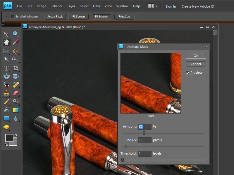

That brings up the dialog box below. Fiddle with the controls to achieve the sharpness you desire. Click on the Preview box as you go to see the result. The effects vary with the size of the image, so it takes some experimentation. For 800 x 600 pixel pictures, I find the settings pictured generally work pretty well.
attachment.php

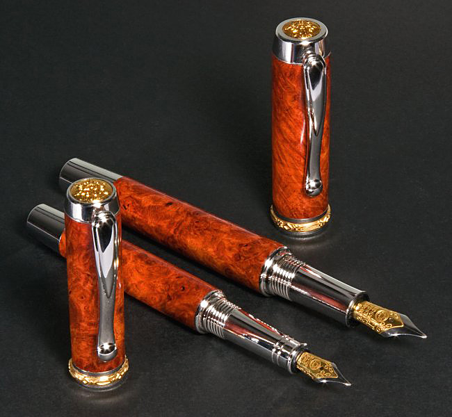

Be careful not to over-sharpen. Sharpening introduces noise, making smooth areas look pixelated. It also exaggerates edges, and can make pen hardware appear unnatural. Sharpen just enough to bring out the details. See the result below.
attachment.php
