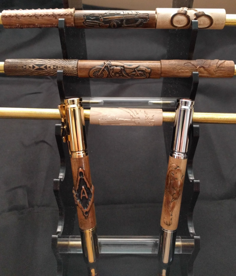

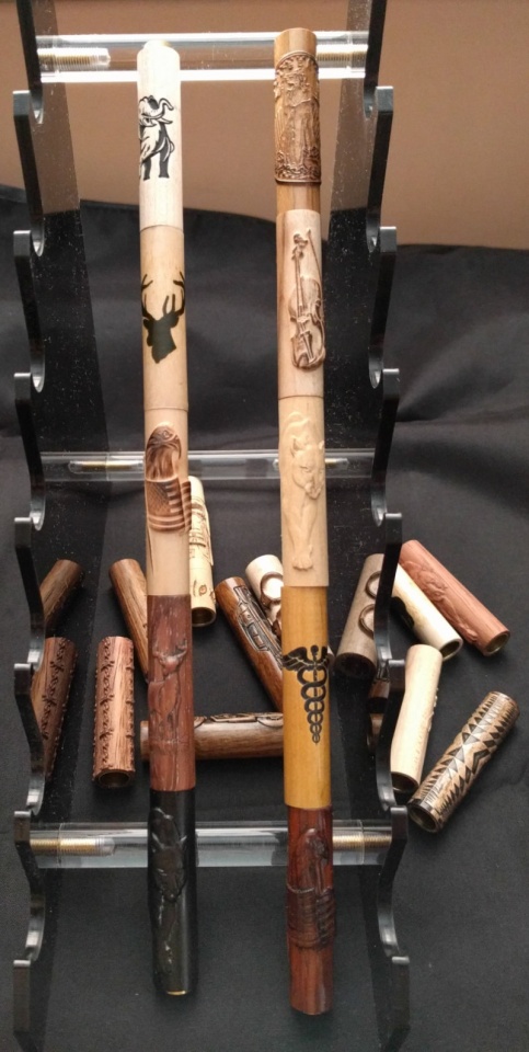

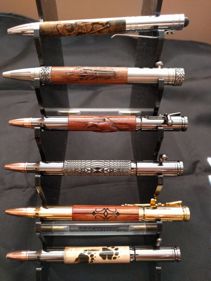

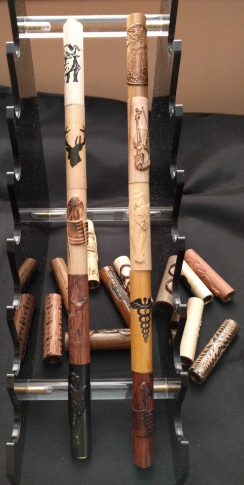

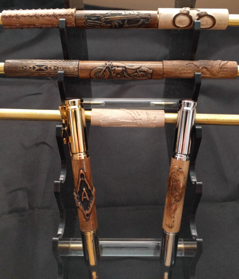

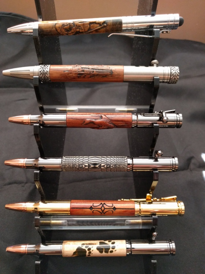

Some blanks and pens I've been working on, test designs, some finished and others only sanded. Not where I want the quality to be but working on improving.

Thanks for input. I agree plan on doing undercuts but like the raised appearance.
JT using a cnc router with a 4th axis to cut rotational work. Took a bit to refine the process to make it somewhat reasonable timewise. Longest time so far is the 50 gold piece, ran a bit over an hour.

Thanks for the comments appreciated. Machine is from plans from fineline automation and cncrouter parts. I purchased some items from them and others I sourced out.

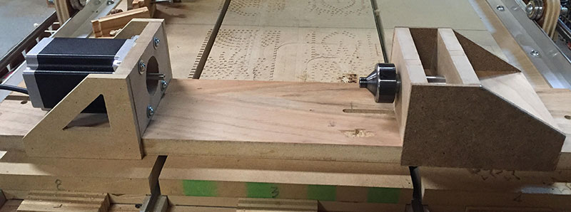

The 4th axis is of my own design but basic concept is same as all.
Software is Vectric Aspire and Vcarve Pro. Relief image from vectorart 3d and vectorclip3d. I also use image and designs from Dover arts.

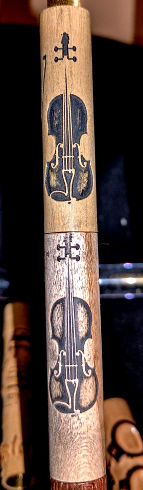

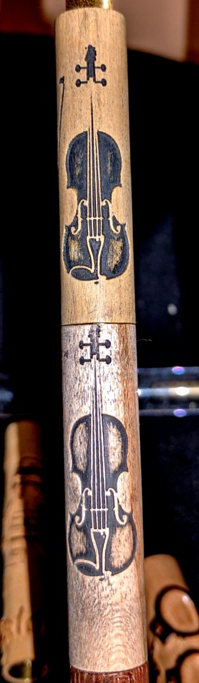

Herb these are for you. Bottom made mistake and didnt center so cut is offcenter. The design and or cutting parameters need further adjusting to get top part of violin strings to cut. Bottom piece has .015 doc and top .025. Top lemonwood bottom maple.

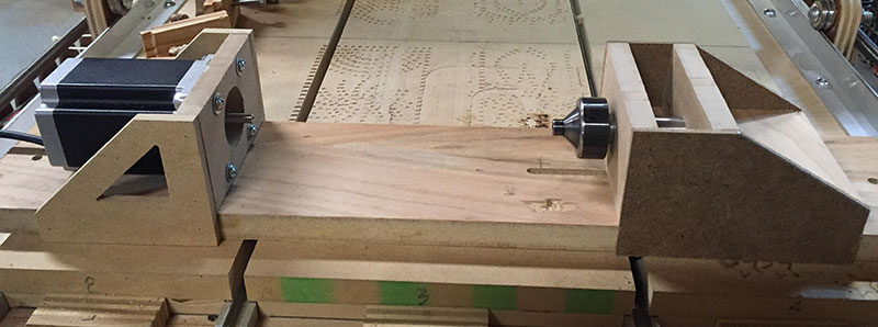

These are very cool. I'm using a self built a plywood cnc with a very basic 4th axis built just for trying out carving on pens. It's just a 1/4" rod coupled directly to a stepper with a tailstock holder for a mandrel saver. I've done some basic vcarving but nothing like this. Also using vectric aspire.

Stan, the last one with the violin would look super if it was cast in either Alumilite or PR. Then the engraving would not have a chance to wear off due to handling and usage.
Elwin
I am looking into the idea. When working with the blanks I have a limited amount of wall to work with. If I do a recess cut I could cut to the tube enhance the cut to stand out then cast. Currently I do not do any casting. I do have some Alumilite on hand thats over 2-3 yrs old. For a 3d cut many of the patterns would lose their resolution. Each design has a sweet spot where the minimum depth of cut is needed for an acceptable image. I may experiment with one today see if I can come up with anything.

Let me add about the workflow. Workholding similar if turning a blank on wood lathe but only 1 blank at a time. Indicate shaft to .001 - .002 over work length and maintain concentricity. I also use the mach 3 digitize function to set cutter c/l. You can either use a endmill and rough and finish turn the blank or turn on the wood lathe. This way engraving cutter will not have to deal with interrupted cuts and hog too much material. I highly recommend using proximity switches, will make your life easier in setup. You also need to have a ridgid setup, my first build i made from 2x4's and now the 8020 aluminum structure. The artwork is a big factor. Aspire has a really good collection, also checkout vectorart3d and vectorclip3d. When I cut a new design I usually tweak the size, position and depth until it looks good to me. Some designs get lost in certain woods and need some form of enhancing. When using acrylics the images get lost and I dont find that material good for use when doing the 3d images. If doing pocket or vcarve designs that lends to using other media to enhance the design and can allow for acrylic blank use.

With v-carving I have turned the blank to finished size and used regular bushings to mount the blank on the 1/4 threaded rod with two nuts either side tightened against the blank to hold it still on the rod.
I'm assuming this would not work for 3d carving since the metal bushing is right up against the blank and the bit needs to cut up to the end. I was thinking instead of using the bushings I would turn a cylindrical shim from hardwood to go between the blank and the rod then use small sacrificial wood spacers either side of the blank to tighten the nuts against.

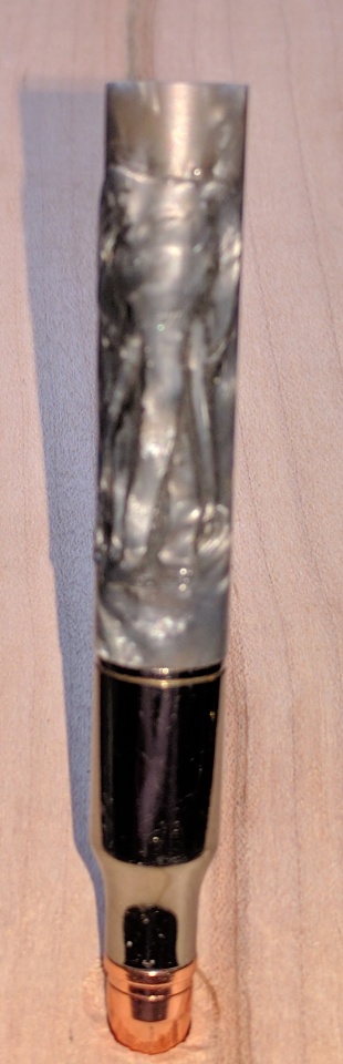

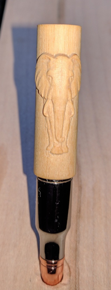

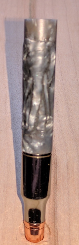

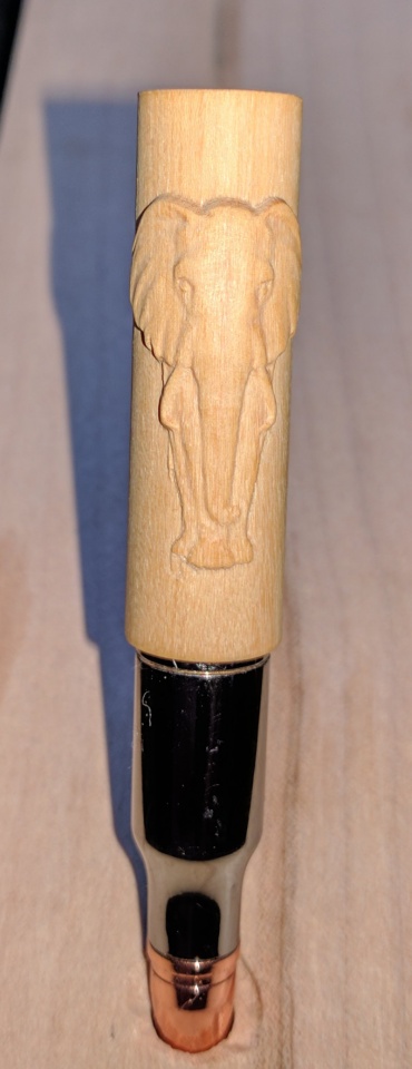

Shawn - Here's an example of an acrylic blank and not working out so well. Not enough contrast. It's an elephant hard to tell, figured grey elephant grey blank. Camera had a hard time focusing on the image. Looks somewhat better in person.

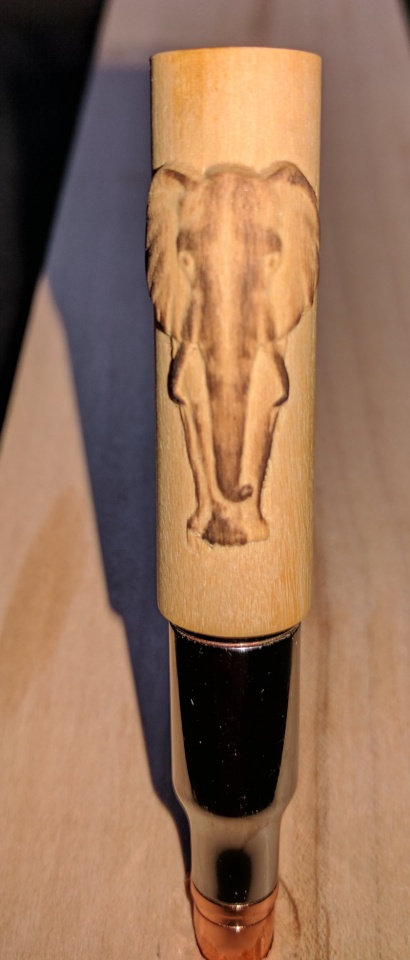

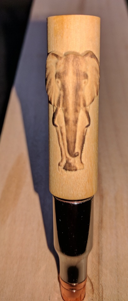

Keep an eye on tip for breakage, at that angle tip is weaker. Gives nice detail though. Here's a blank in lemonwood same elephant off the mill and with some highlighting.
