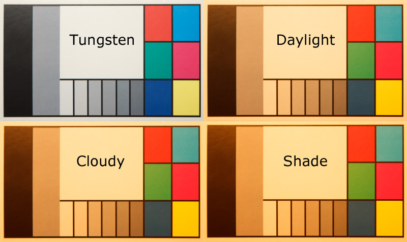

Here is an image containing four photos taken in direct sunlight with different white balance settings. The "daylight" setting is good. "Tungsten" gives the picture a blue (cold) cast. "Cloudy" and "Shade" are close, but slightly on the yellow (warm) side.
attachment.php

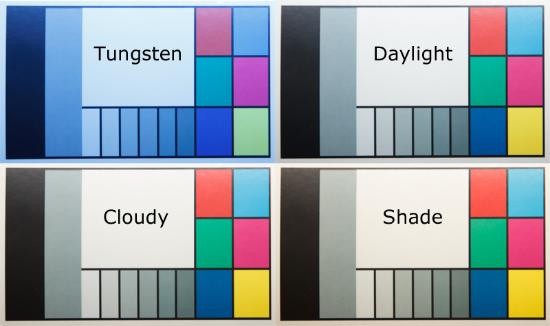

The photos in this image were shot on an overcast day. The "cloudy" setting looks right. "Tungsten" is too blue. "Daylight" is a bit cool. "Shade" is a tiny bit warm.
attachment.php

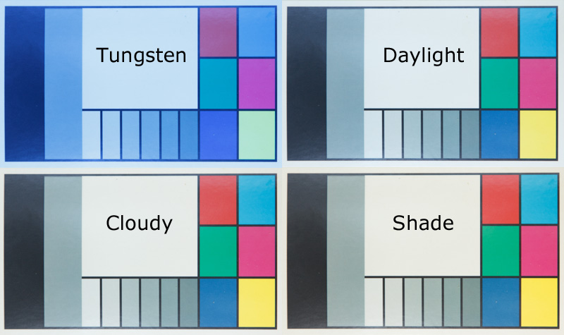

These were photographed in the shade on a sunny day. "Tungsten" is even colder. "Daylight" and "Cloudy" may be close, but have a slight blue cast.
attachment.php

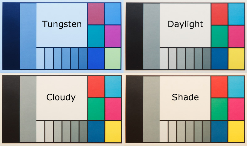

Finally, I moved indoors, and took these pictures under a quartz light. The "tungsten" white balance setting is correct. All the other settings look way too brown.
attachment.php
As you can clearly see, the white balance setting makes a tremendous difference. Getting it right is essential to taking a good pen photo. It is often possible to correct improper white balance in post-processing, but if you set things right up front, you won't have to.
