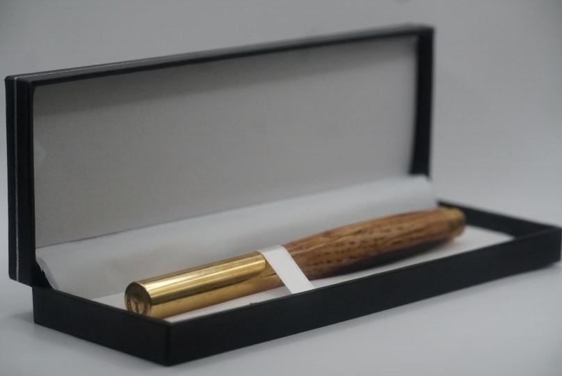

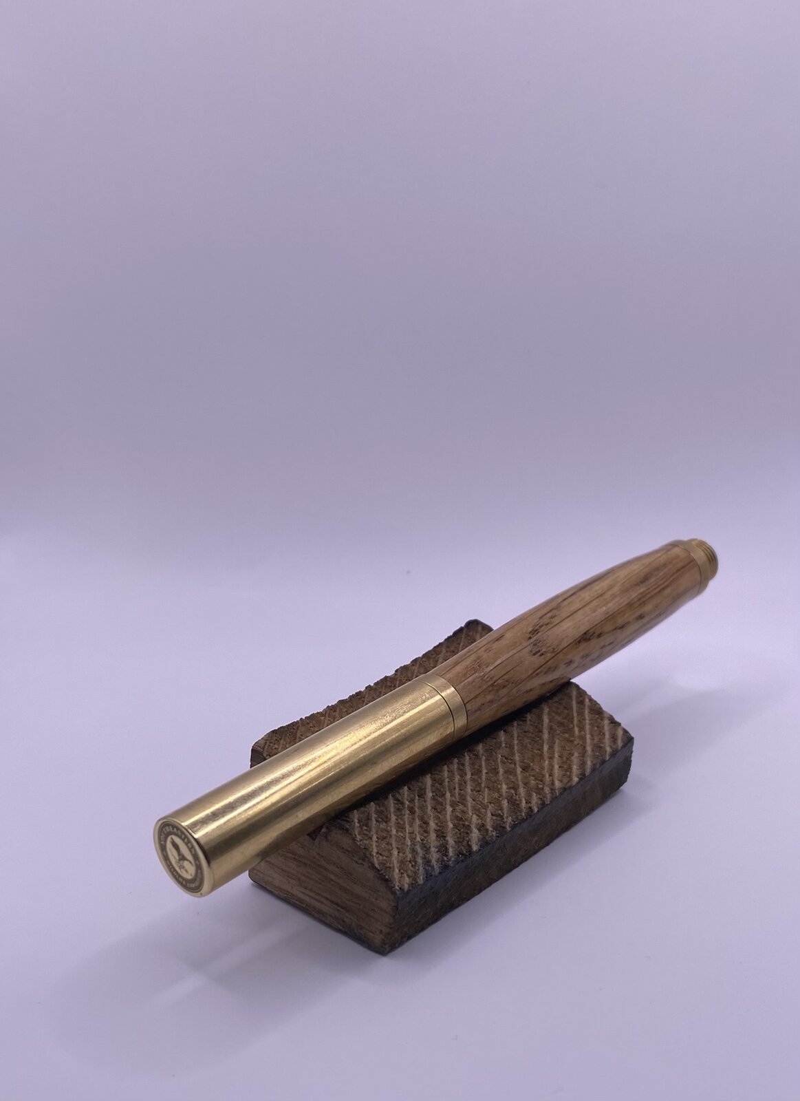

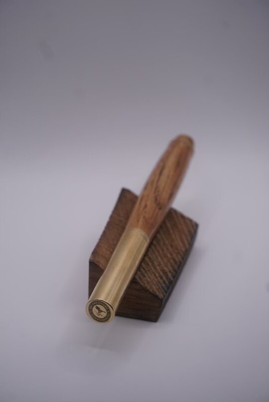

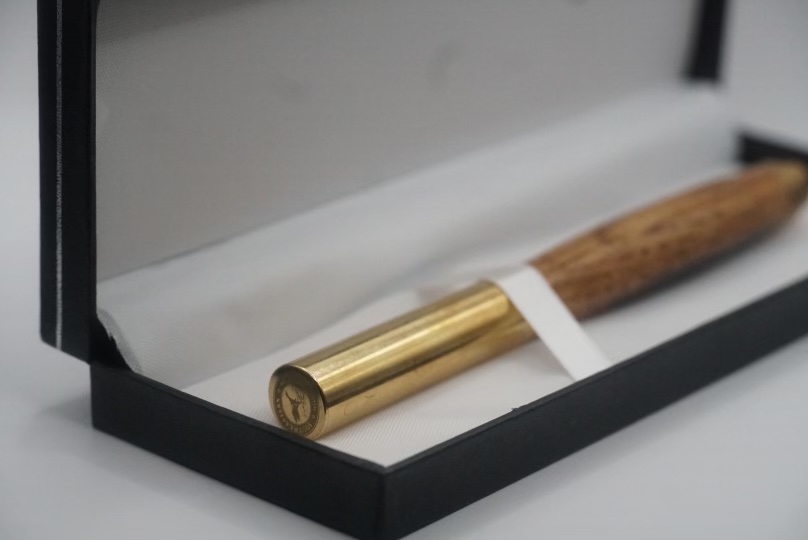

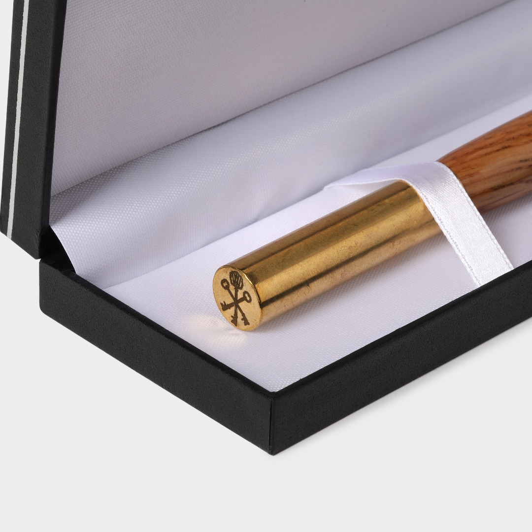

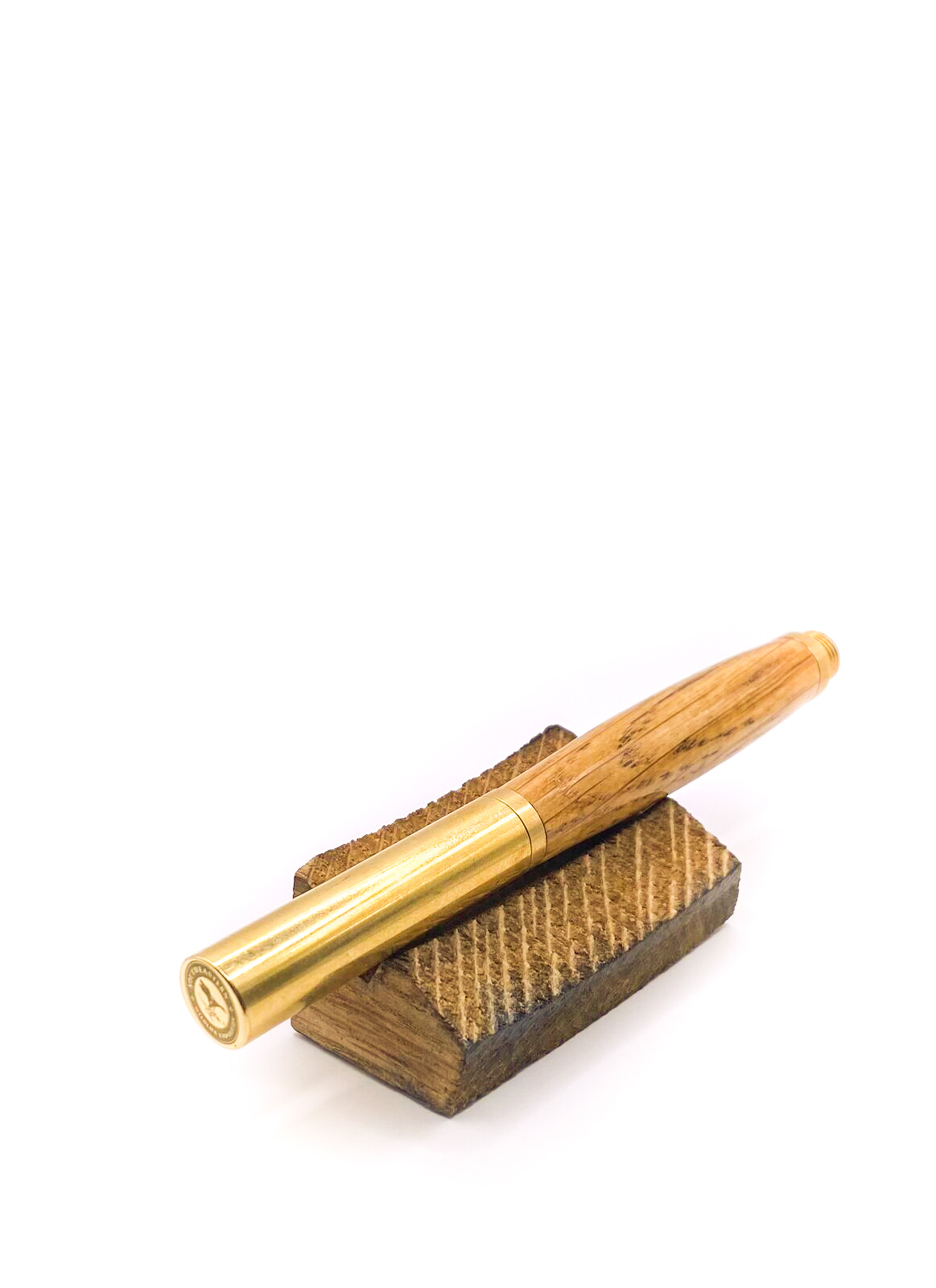

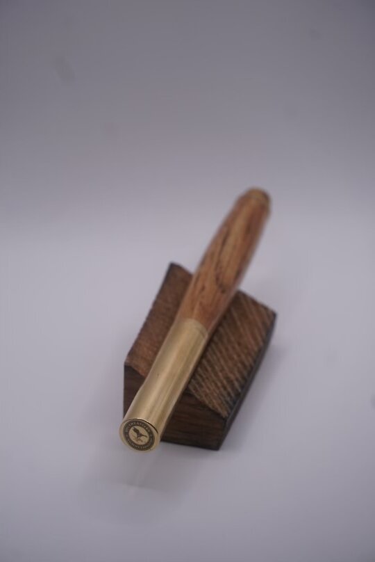

I am needing some advice and frankly just going to rant on my frustration. I am not good at taking photos of my pens so I typically have my wife take them and she does a great job with what we have. We don't have the equipment to take a photo like these first two attached. Having recently moved I found a new photographer in the area and wanted similar pictures taken for a different pen project.

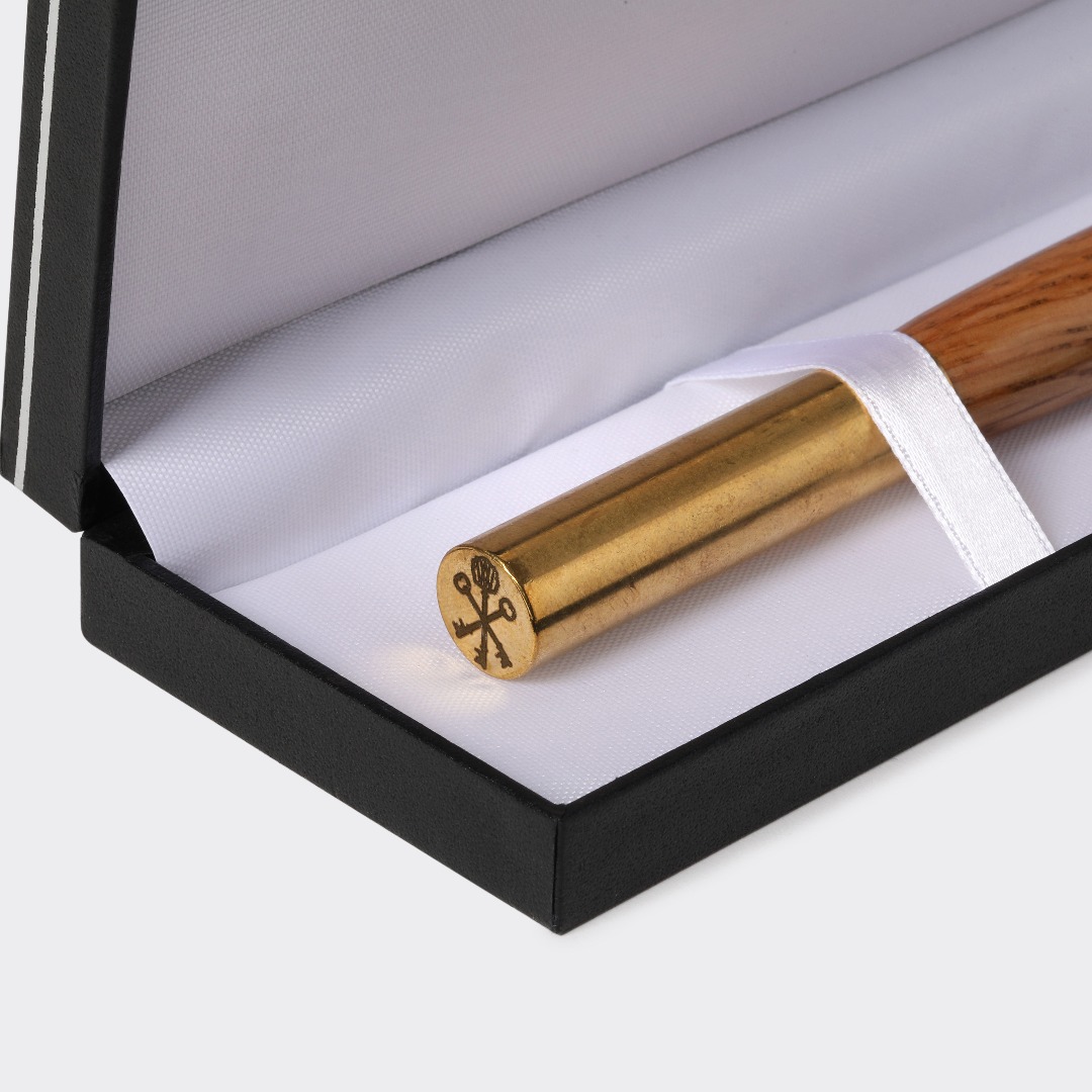

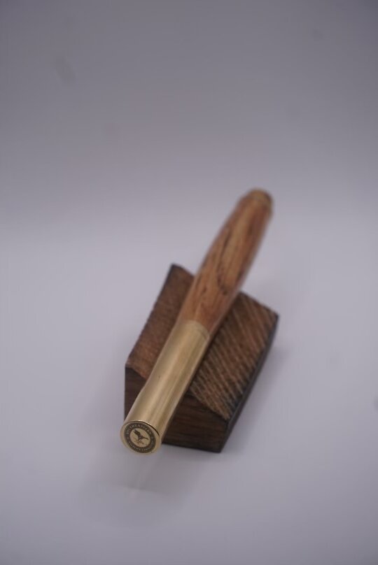

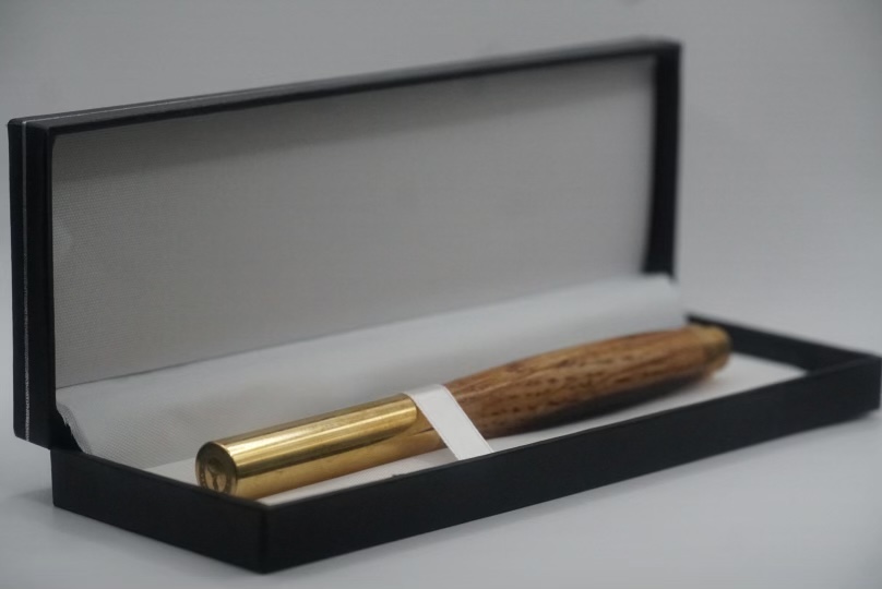

This is what I received as the final pictures. Now I understand taking pictures of pens is difficult but I asked up front if she had the equipment necessary to take pictures like the original and she said yes.

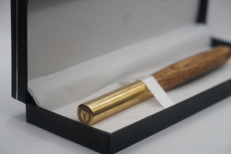

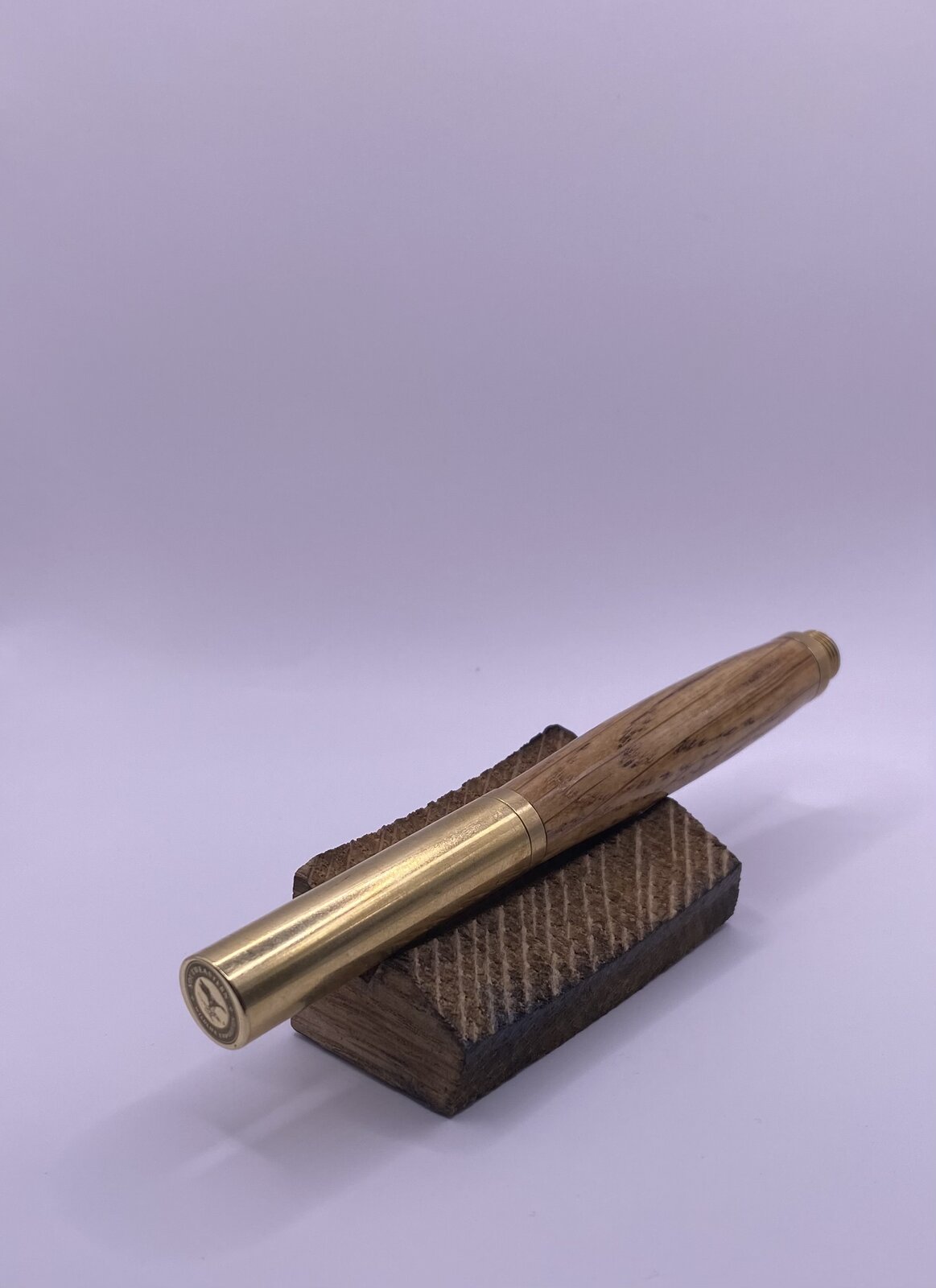

I told her I was disappointed and if she could redo them. She then delivered these and said this is the best she could do. One of them has the Live Photo feature as it's been taken with an iPhone.
Should I be required to pay for these photos? We had agreed on price beforehand and I even gave her one of the pens. If I wanted photos this blurry and unprofessional compared to the first ones I would have done it with my on iPhone. The most frustrating part is I asked beforehand to make sure she had the equipment to do so.

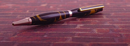

The first 2 are truely professional. I wish I could take photos like that. I do not have the equipment. The ones she took I would not pay for and just let her keep the pen you gave her as payment. One of those word of mouth deals and they always come back to beat you I suppose.

There is a Professional Photographer on every block. Anyone can call themselves a professional and do. The bulk of people calling themselves professionals are educated by youtube and pinterest. As I have said on this site, I was a commercial and portrait photographer for 43 years. I have a degree.
On the other hand, a bonifed commercial photographer usually get 300 to 500 dollars an hour. While that sounds like they are getting rich, I assure you they are not. Most charge for the session time, and that includes the conversion time. Conversion time is usually twice the time it take to photograph. Balance that to an amateur ( who claims to be a professional), the bill is a lot more. If you do not want to pay commercial rates, I would suggest that you look around. What you are looking for is a person capapable of small product photographs. When you are looking, ask to see their portfolio of Product Photography, small products specifically. I would not look at photos of children, animals or landscapes......that is a different skill set, and equipment set. There should be people out there that are capable of doing this adequately. Try some portrait photograpghers that are degreed.....they may have a portrait studio and not specialize in it, but have the skills enough to do it from their education. Covid put a damper on a number of studios....they may be willing to deal a little. While there are some good photographers that work from home, there are far more that will deliver what you just got. Try a full time studio first, then the part timers. After you find someone that delivers what you want for a price you are willing to pay, stick with them.
The photos you recieved were not satisfactory and just the mere fact that she did not see that, is testimony to her skill. The very color rendition and lack of depth of field shows that she is outside her area of expertise. I never liked to bash someone in my own field, but I think it is apparent.

I agree. Not up to snuff. Have you checked the exif data to see what camera she used. With the right knowledge and lighting, an iPhone isn't bad. I'd actually spend more on the lighting and backdrop setup than I would on the camera for this sort of photo.

Does not meet up to Professional quality unfortunately. The other pictures they sent to you were not even taken through a photo editing software. It does not seem to me that they wanted to do any extra work. The color temperature is off and by doing some simple adjustments a lot better picture could of been given to you. Here is an example of what i was about to do in 5 minutes with some photo software.
I would definitely not pay anything for this.

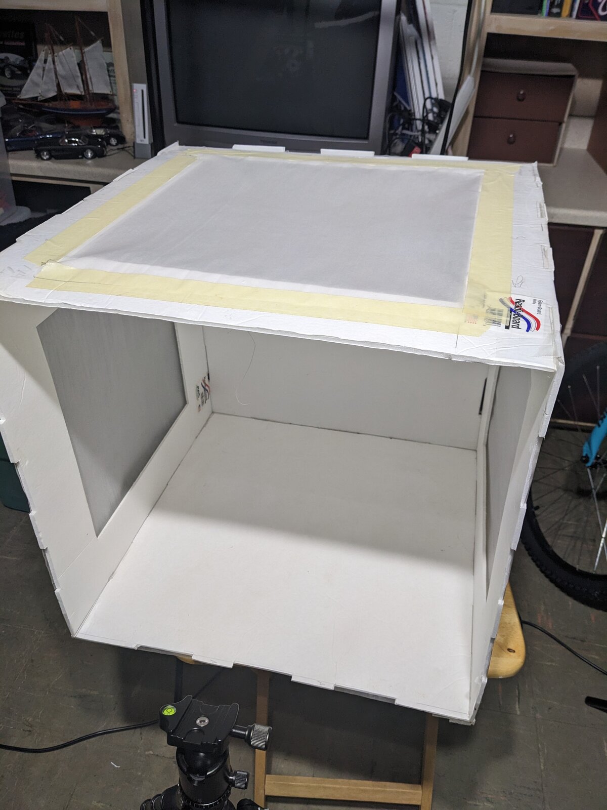

The last photo has the shadow indicating a light source from one direction. I take photos of trout flies with this setup: two clamp on lights from Harbor Freight, curly Q bulbs, wife made two cloth filters for the lights. I have three backgrounds: dark brown, grey and tan. The lights clamp on the cabinet frame or doors and moved for the best lighting. Photo attached.

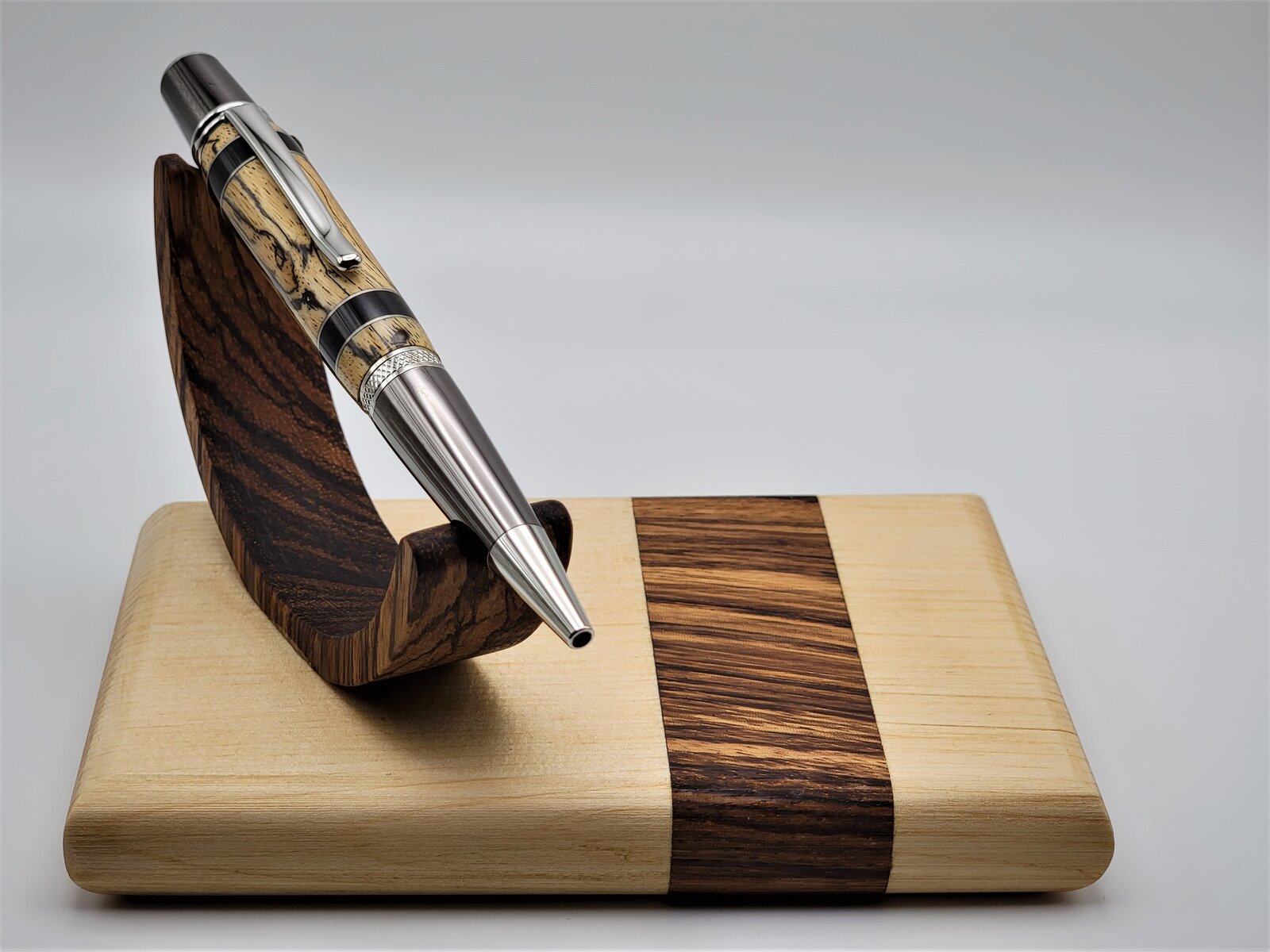

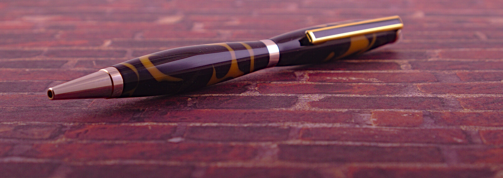

I am FAR from a professional when it comes to photography (or just about anything, really). Since this is a hobby to me I am certainly not willing to pay a professional photographer.
While these aren't amazing pictures, you can produce 'good enough' results with a small investment in learning and equipment.
Simple, but good enough if you are going to put it up for sale somewhere, and I didn't bother with things like making sure the empty space on the edges was consistent.
This was done with my Samsung Galaxy S21 Ultra cellphone (the ultra does come with an upgraded camera) and a $40 light box from amazon (https://www.amazon.com/dp/B08PDP3YSP?psc=1&ref=ppx_yo2_dt_b_product_details).
Take the time to learn about the camera settings, regardless of what you are using. Even most cellphones have a 'pro' setting now where you can make a lot of adjustments. A little time invested here will pay big dividends in your final product. YouTube has a lot of great info.
Secondly, a little bit of post-processing goes a long way. I have photoshop but honestly do not bother with it for pictures like this. I just use the Photos application that comes with Windows and I do the following:
Crop to size desired
Increase clarity slightly
Adjust color saturation to preference
Adjust lighting to preference
It may sound like a lot but the entire process takes me less than 30 seconds per picture, and if I actually spent a few more I could make it even better.

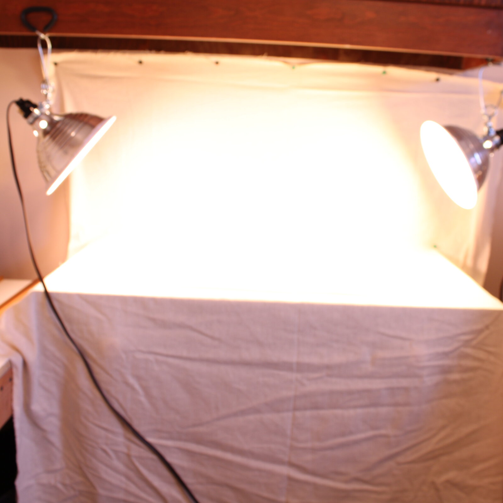

@Woodchipper Thank you for posting the photo of your setup. I've been struggling the last few years trying to find a lighting setup. I bought a light box that came with four halfway decent LED lights, but have never been able to figure out where to put them. I'll have to find a way to suspend them, and only use two, like in your setup. Even if it doesn't work for me, at least I have a direction to go.
Even YouTube/Pinterest searches haven't really helped as far as determining where to put the lights.
jttheclockman
Feb 22, 2005
19,148
NJ, USA.
There are many videos on utube showing how people and even pros handle photo taking with and without light boxes.

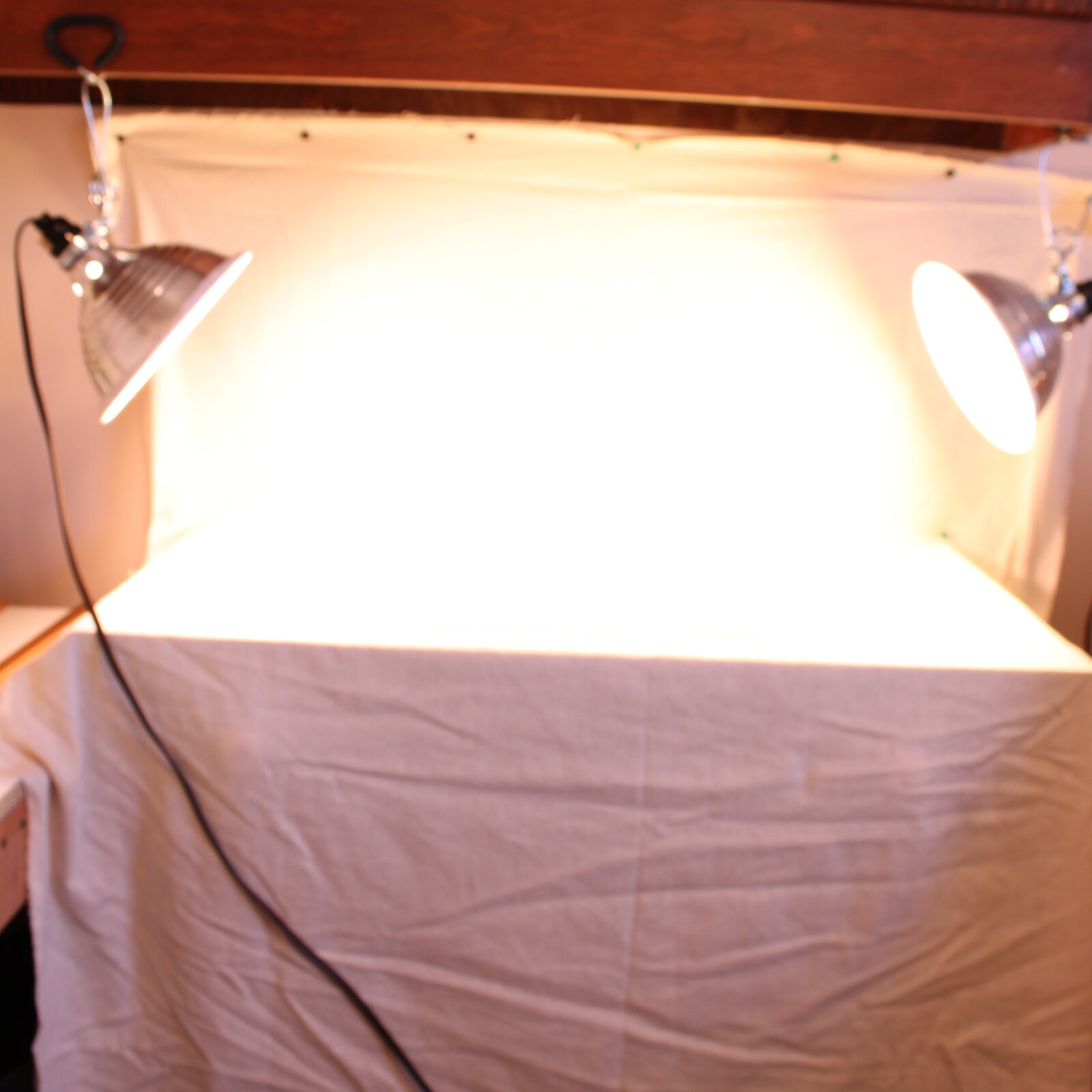

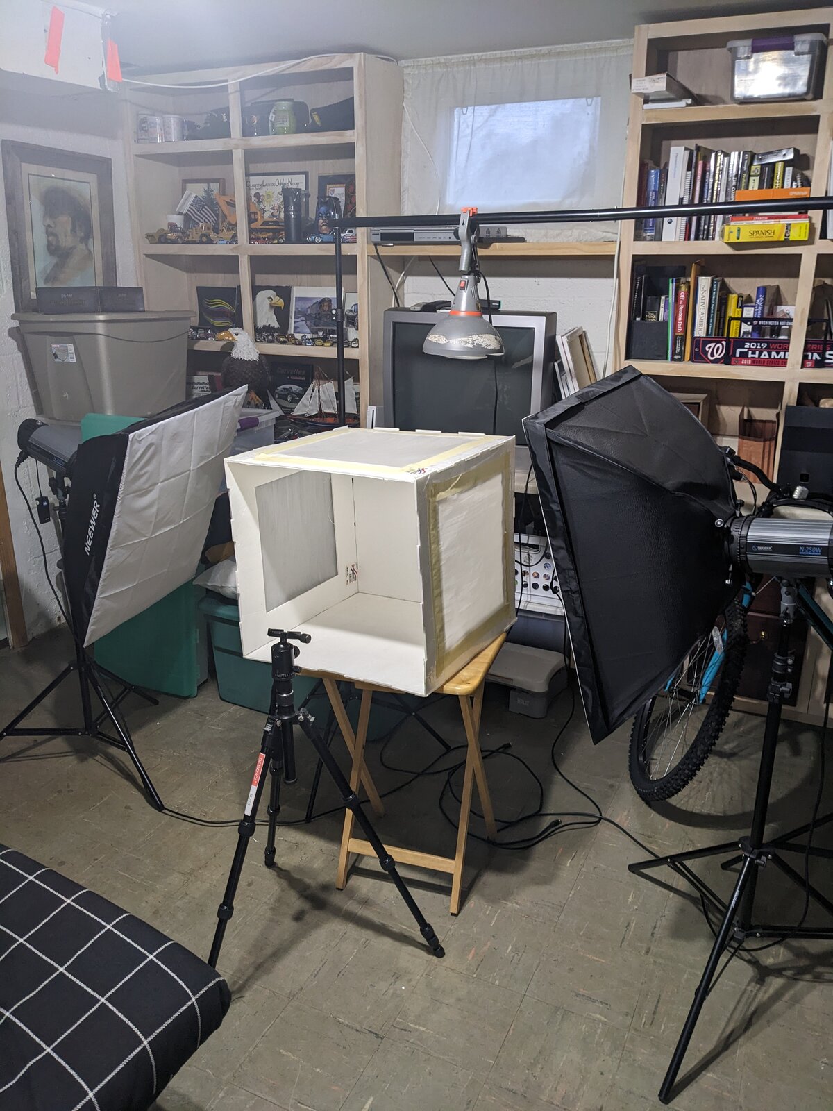

So just to add my 2 cents. This is my set up (please ignore the clutter) A home made light box, two studio strobes and an LED flood light. I use a Nikon D3300 on a tripod with a remote trigger, to reduce any movement from pushing the shutter button. The studio strobes were not that expensive, my daughter uses them for portrait photos. The light box is made from $1 foam boards. You can make it any size, I cut out the sides and top and used tracing paper to diffuse the light. You can make it permanent or folding so you can store it. I try to compose as much of the image on camera before I take the shot, composition, white balance, and exposure. I'm quickly learning that a can of compressed air or an air compressor is essential to minimize dust. I post process my images with open source software, Darktable and GIMP 2. I surf Etsy stores and pen companies to see the type of images they use. I find most of my backgrounds at the craft store scrap booking section. Attached are some examples of my recent pens and photos.

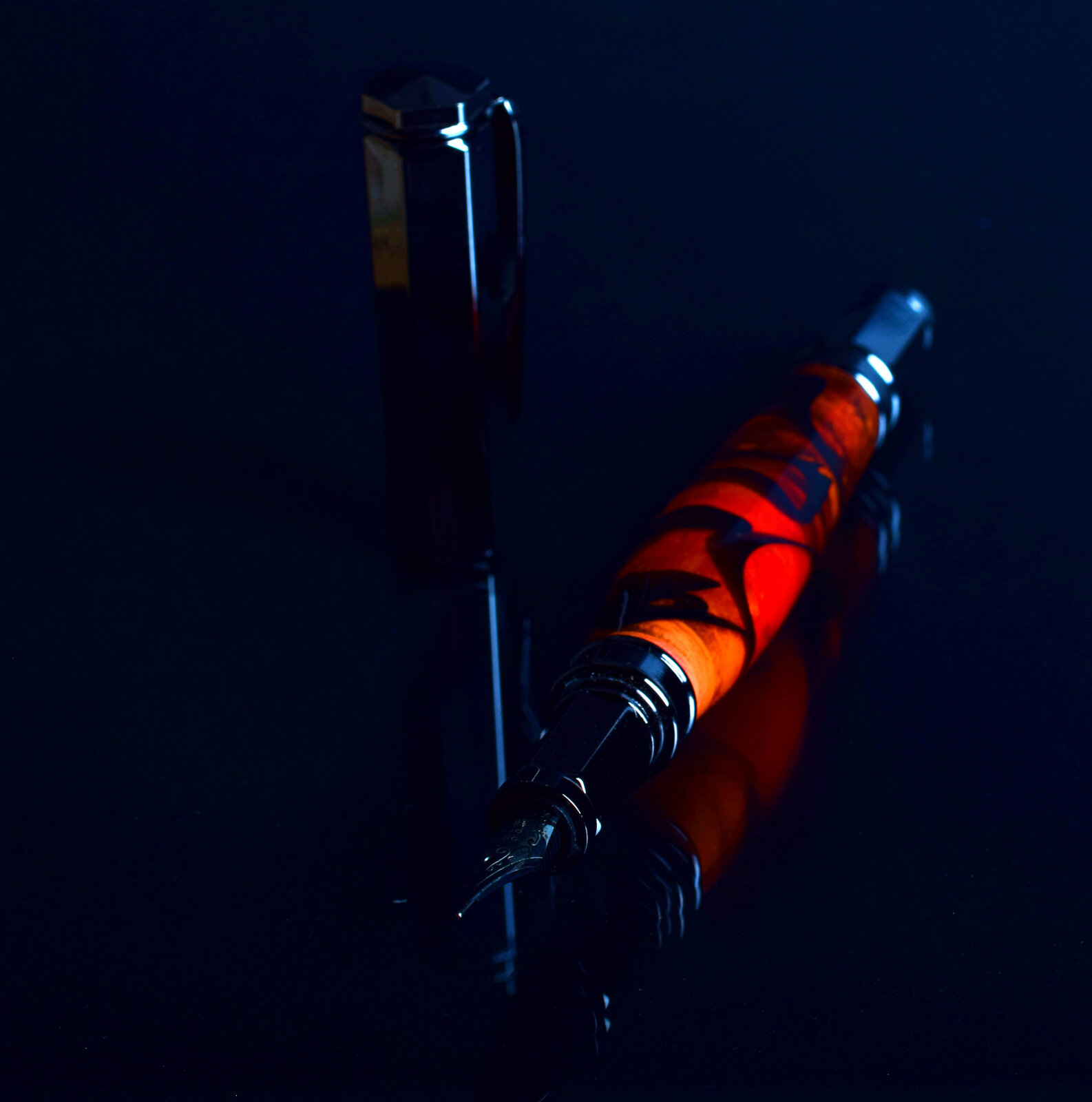

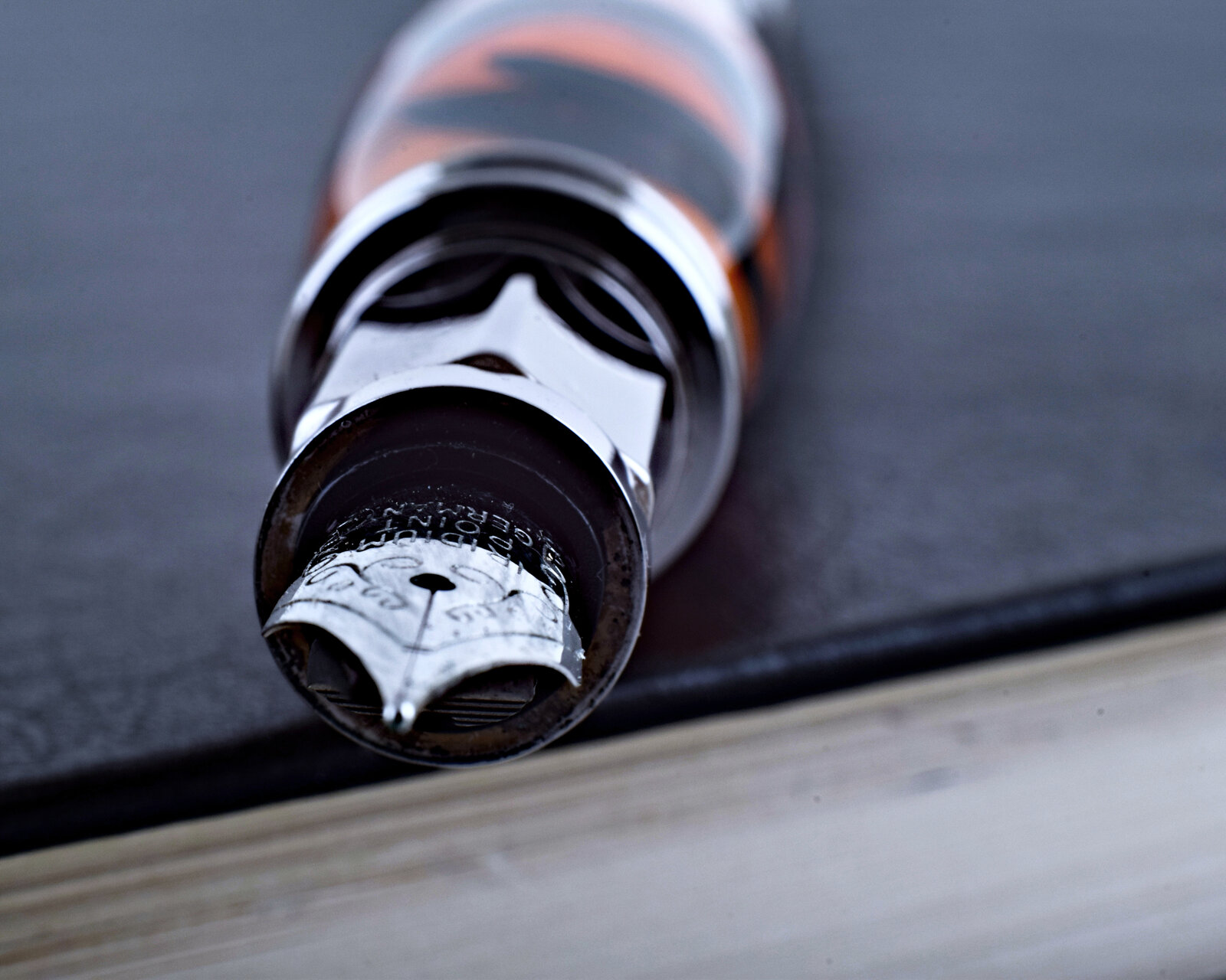

I'm new to both pen turning and the forum but your post raises a lot of issues - I'm not new to photography -
When soliciting photography, nearly all photographers should have sample images and if they can't provide samples that represent the technical skills, be very cautious -
"Table Top', Macro and product photography aren't magic but they can require some specific skills - that in all honesty, almost anyone can learn - I'll go out on a limb and say that if you can learn pen turning, you can probably also learn to photograph your pens if you want to.
I'm not one of those who will try to "hide the industry secrets" there are just techniques and skills (and equipment) to enable making high quality artistic shots.
There are even inexpensive and DIY tools that can be made up to achieve nearly all the same results - not unlike pen turning.
For close shots, a tripod is really essential - even if its a cheap tabletop tripod that holds your phone - not just for focus but so you can also make controlled adjustments to your composition and lighting - hand held is possible but it really complicates the process and forces you to review all of the variables simultaneously - which isn't good for learning.

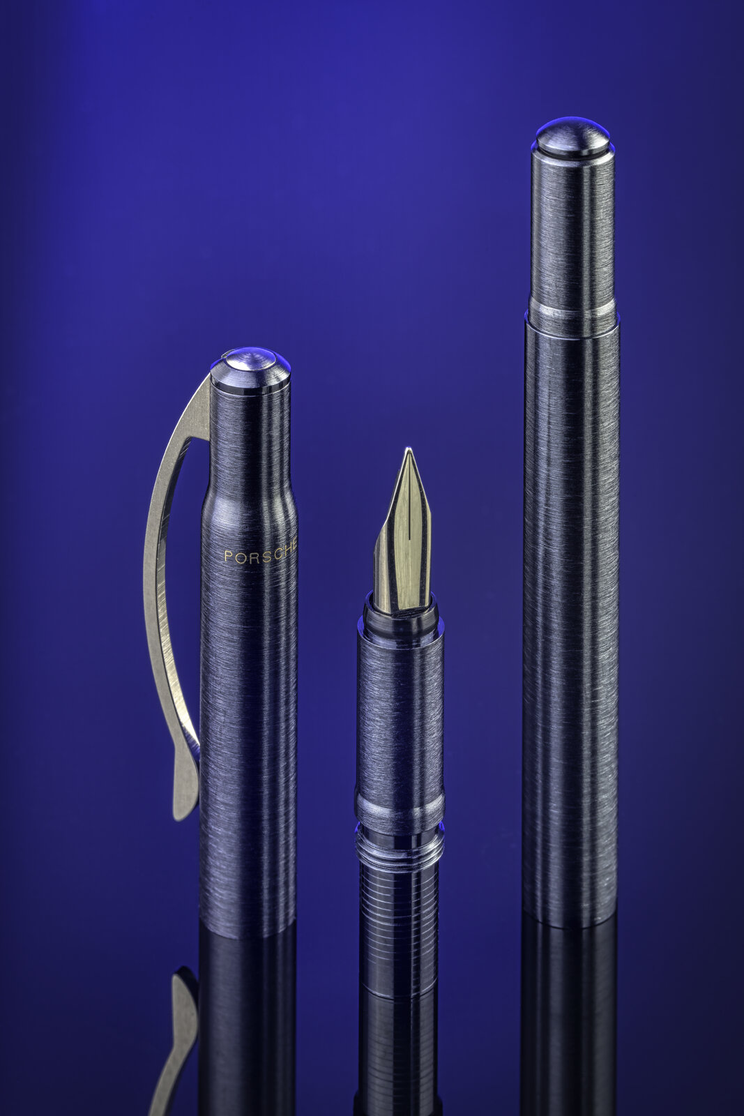

Attached are a few sample images - two happen to be pens (just not turned pens) and the third is a macro image -
Pens are not technically "small" - table sugar is a lot smaller - but even that isn't "tiny" - its just techniques for each task - that can be learned - by you or a photographer - so get the images you want -
Pen on cedar plank
Pen on glass
Table sugar on glass
