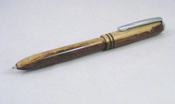

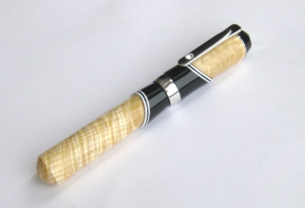

See the photos below. first is in daylight and the second is in the photo tent. both with the same settings, I use a cannon powershot sd1100is.
I am happy with the photo in daylight, just sometimes I cant take a photo then, I need my tent. I dont understand why it is so grainy....this is a recent problem I havent had before. Are my settings wrong? if so, why are they ok in the daylight?

What settings are your camera on? Check to see if the ISO is on AUTO. If so that would be the problem. Daylight is brighter and the camera is picking a slower ISO resulting in less grain. The light tent does not have near the level of light that you are getting with daylight and the camera is selecting a faster ISO which means more grain. You should be able to set the ISO manually. You want it on 50 or 100 ( or whatever the lowest setting is on your camera)

Gary has the answer most likely. In the tent, be sure to use the tripod, remote trigger, if available, and maintain a small (larger number) f stop for depth of field. You might look into getting stronger lights or using less filtration between the lights and the subject.

This means you shot at f4.5@1/160s at ISO800 which will explain the grain. You also had everything set to auto.
Start shooting in manual "M" and adjust the settings till you find the one that works. Underexposing is a common problem that will give you background noise when you post process.

You need to figure out how to set your ISO setting lower and then adjust your shutter speed or aperture to get the correct exposure. With all due respect, tripod, light strength, # of lights do not answer what is obviously an ISO related noise issue.

I would concur with the noise being caused by the high ISO. I'm not all that familiar with the camera model, but you need a fairly good sensor to pull off a good shot at ISO 800. Most will be, well, exactly what you got, a decent shot ruined by noise (mistaken for "grain" from the high ISO film days, and it can look very similar...)
Get yourself a tripod, or a bunch of hot lights to stick around your tent, and get your camera off of the auto-ISO mode. If you have a tripod, set it manually to the lowest ISO it has, and see if it has a self-timer, to eliminate the camera movement when you press the button from blurring the photo.
If you don't have a tripod, a couple of 500watt halogen floodlights will get you enough light on your tent to get a good shot hand-held.
