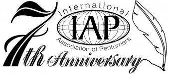

I'm going to start right off with a digression, and show some other images that I didn't enter. Here they are:

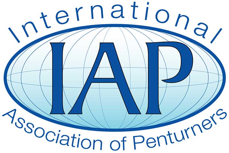

First of all, this is the original 7th Anniversary Logo. I didn't create the logo, but am showing it for the sake of comparison:

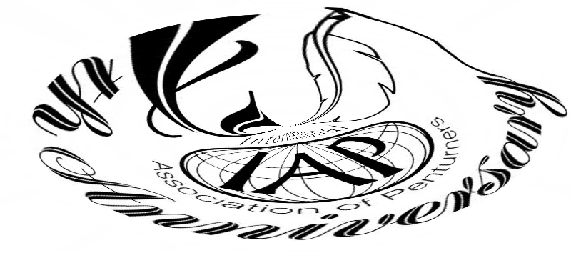

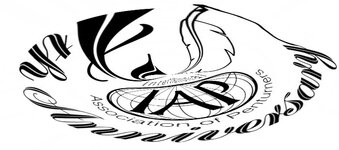

Next up, is a modification of that image:
This is quite simple to do in Photoshop. It's just a conversion from rectangular to polar coordinates. Click "Filter->Distort->Polar Coordinates", and select "Rectangular to Polar".

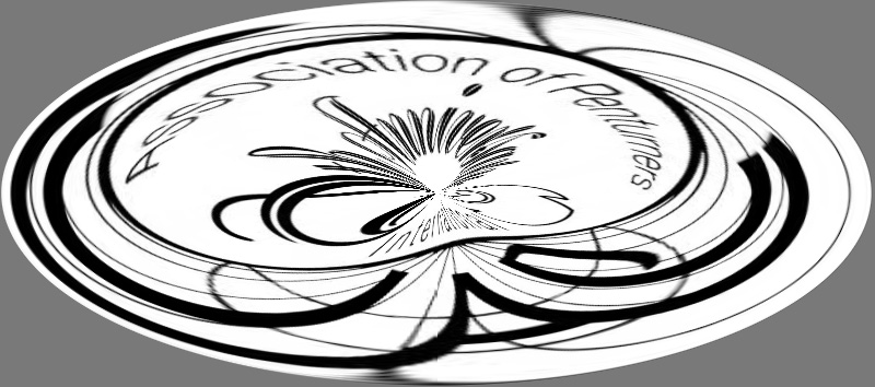

Here is an inside-out version:
It's kind of difficult to see the original logo in it, but you can read "IAP" at the bottom if you try, and barely make out "7th Anniversary" in the middle. This is a fun distortion to do with photographs. It can be challenging to predict what the picture will look like - sometimes the result is quite surprising. From the initial image:
  1. Do a polar to rectangular conversion "Filter->Distort->Polar Coordinates, Polar to Rectangular".
  2. Rotate the image 180 degrees "Image->Rotate->180".
  3. Do a rectangular to polar conversion "Filter->Distort->Polar Coordinates, Rectangular to Polar".
  4. Rotate the image 180 degrees again so the text is right side up "Image->Rotate->180".

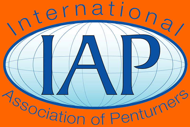

The starting point was the official IAP logo. It can be found at http://www.penturners.org/logos/. I used the 917x613 pixel jpg version. This was bigger than the allowed image for the contest, which had a 800px maximum. Therefore, I first had to resize the logo. This was done as follows:
  1. Select "Image->Resize->Image Size".
  2. Make sure the "Contstrain Proportions" and "Resample Image" checkboxes are checked.
  3. Change the width to 800 pixels. Note that the Height changes to 535 automatically to maintain the image proportions.
  4. In the drop-down box at the bottom of the dialog, choose "Bicubic sharper". Shrinking a photo tends to make it softer looking. This sampling method will tend to preserve sharpness.
  5. Click "Ok".

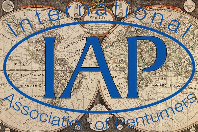

Adding the background layer
I wanted a map for the image background. I created it by opening that image separately in Photoshop, and cropping it to the desired proportions
  1. Click on on the "crop" tool.
  2. Choose aspect ration "Custom", and enter 800 and 535 into the width and height boxes. This will make sure the cropped image has the desired proportions.
  3. Now drag from corner to corner of the desired area. Fiddle with the crop until it covers the desired part of the map.
  4. Click the green check mark to perform the crop
Then resize the image to 800x535 the same way that I resized the IAP logo.
That created the desired background. Now it needs to go into its own layer in the composite image.
  • Copy the map image to the clipboard. Click "Select->All" and then "Edit->Copy"]
  • In the composite image, create a new layer. Click "Layer->New->Layer".
  • Make sure the new layer is the active one by clicking on it in the layers window. It should be highlighted.
  • Paste the map into the layer. Click "Edit->Paste".
Now there are two layers, but the top one is not transparent, so only it appears. You can see that both are present by temporarily making the top one invisible. Click on the eyeball icon next to the layer name. That will toggle the layer visibility.

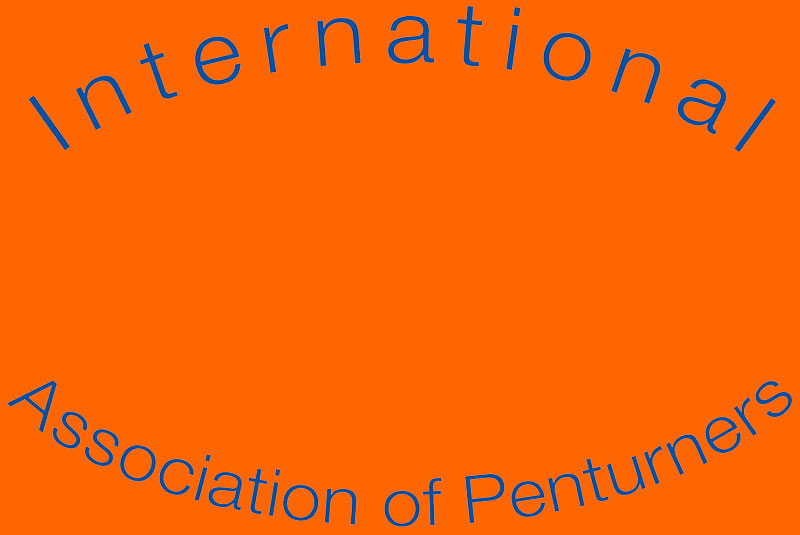

The first intermediate image is the IAP logo with the white background removed.
  1. Make a copy of the logo layer. Make the logo layer the active layer by clicking on it in the layers box. Select "Layer->Duplicate Layer". Drag the new layer to the top.
  2. Select the "magic wand" tool and click on the white border area. This will select the outer white area.
  3. Delete the selected area either by clicking "Edit->Cut", or pressing <ctrl><c>. You'll see the selection go transparent and the lower layer will show through.
  4. Repeat the selection and deletion for the white portions that are inside the letters "e", "a", "o", and "p".
The layer now looks like this (except that orange is transparent)

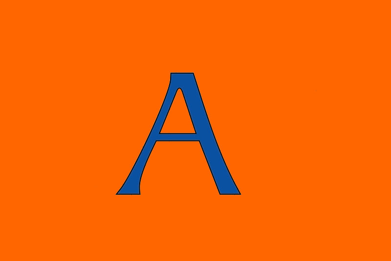

I made another layer and selectively copied bits of the first intermediate layer into it.
  1. Using the magic wand tool, select the "I" in the "IAP" portion of the logo. Unfortuntely, that doesn't quite select the entire letter in one click.
  2. To grow the selection, click "Select->Refine Edge" and move the "contract/expand" slider until the entire letter is selected.
  3. Copy the selection to the clipboard (<ctrl><c>), and paste it into the new layer (<ctrl><v>).
  4. Do the same for the "A", and "P".
  5. Do it for the blue oval as well. As I recall, it was necessary to erase a few pixels from the longitude lines using the eraser tool.
When these two layers are viewed on top of the background layer, the result looks like this.

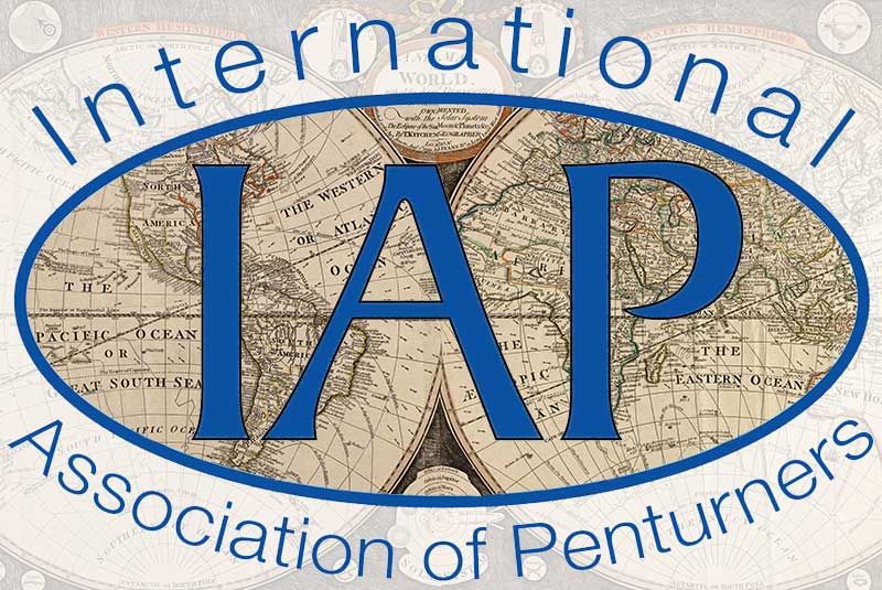

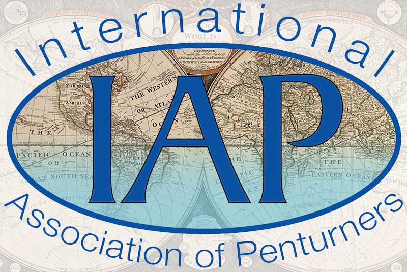

Semi-transparent layers
The blue text is hard to read against the brown background at this point, so I had to do something to bring back the feel of the white border in the original logo. I created a semi-transparent white border.
  1. Create a new layer. Position it above the background layer but below the logo layers.
  2. Fill the layer with white. Make white the foreground color and fill the layer using the paint bucket tool.
  3. Make the layer semi-transparent. In the Layers box, there is an "Opacity" control. Change it from 100% to 75%. This lets the map show through just a little and makes the text easy to read. I want the map to show through in the center, though, so I have to remove that portion of this layer.
  4. Activate the second intermediate image (the one with just the center part of the logo).
  5. Using the magic wand tool, click on a corner of the image (where that layer is transparent). That selects the outside of the logo.
  6. Now invert the selection by clicking "Select->Inverse".
  7. Make the semi-transparent white layer the active layer, and cut out the selection (<ctrl><x>).
Now the image looks like this.

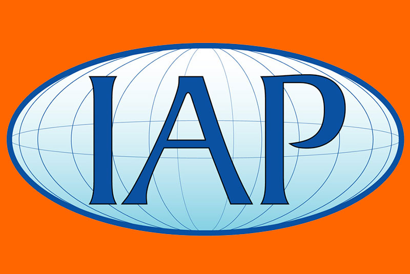

The original IAP logo has a light blue to white gradient portion in the center that I wanted to keep so I added another layer for that.
  1. Create another layer just above the background layer.
  2. Make light blue the foreground color. Activate the original logo layer. Click on the forground color box in the toolbar. Now click on the light blue portion of the logo. This picks that color for the foreground.
  3. Make the new layer active.
  4. Create a gradient fill. Select the "Gradient tool". The gradient fill options now appear at the top.
  5. Change gradient type. The default gradient is "foreground to background" which isn't what I want. Either choose a different gradient from the drop-down list or by clicking the "edit" button. The gradient I want is the second one "foreground to transparent".
  6. Create the gradient by clicking at the bottom of the center oval and dragging up to the midpoint. The gradient fills the image, so I need to remove the unwanted portion.
  7. Restore the last selection. Click "Select->Reselect".
  8. Invert it by clicking "Select->Inverse".
  9. Cut the unwanted portion (<ctrl><x>).
  10. The map doesn't show through enough, so I made this layer 75% opaque as well.
In my first version (see my second post), I left in the longitude lines present in the original logo (somewhat lightened). In this version, the map already has longitude and latitude lines, so I left them out. They would just make the picture too busy.

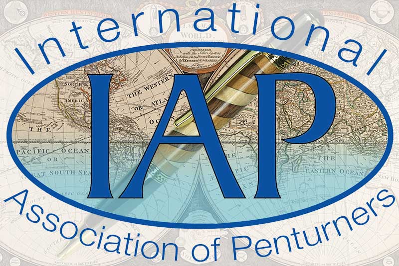

Adding the pen

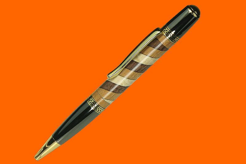

I thought it would be neat to add a pen to the IAP logo, and here is the pen I chose.
As I mentioned previously, I picked this pen (Triple Helix) because I thought it was attractive and the colors complimented the logo. This was my first attempt at laser-cutting a pen blank, and to the best of my knowledge, the first spiral-segmented pen shown on the IAP.
The photograph, however, is new. I could have cut the background out with Photoshop, but I found it easier to use CorelDraw instead. Photoshop selection tools kept including portions of the background, or excluding parts of the pen, and yielded ragged edges. Using CorelDraw, I drew a closed polyline (a polyline is a series of connected straight lines) around the pen with nodes at each change of curvature. Then I converted each straight line into a curve, and adjusted each curve to match the edge of the pen. That gave me a nice, clean edge all the way around. CorelDraw can't export in Photoshop format, so I gave the pic a contrasting solid-color background and saved it as a jpg. I then opened it in Photoshop, deleted the background color, edited, and resized the pen.
I won't go into all the details of editing the pen photo - that would be a whole topic all by itself. Some of the adjustments I did make were Levels, Shadows/Highlights, Rotate, Crop, Clone, Color Cast, Resize, and Unsharp Mask. I generally prefer "unsharp mask" to regular sharpness adjustment for photographs.
Here is what the image looks like with the pen under the logo (just above the map).

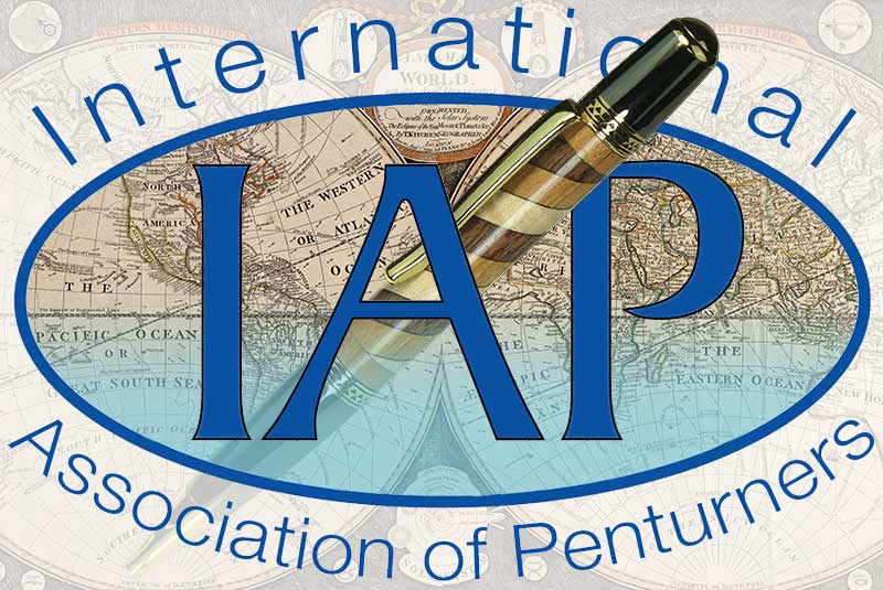

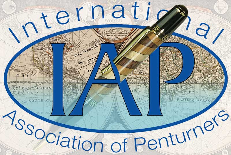

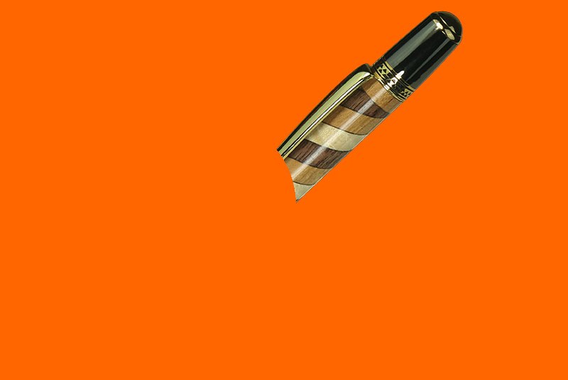

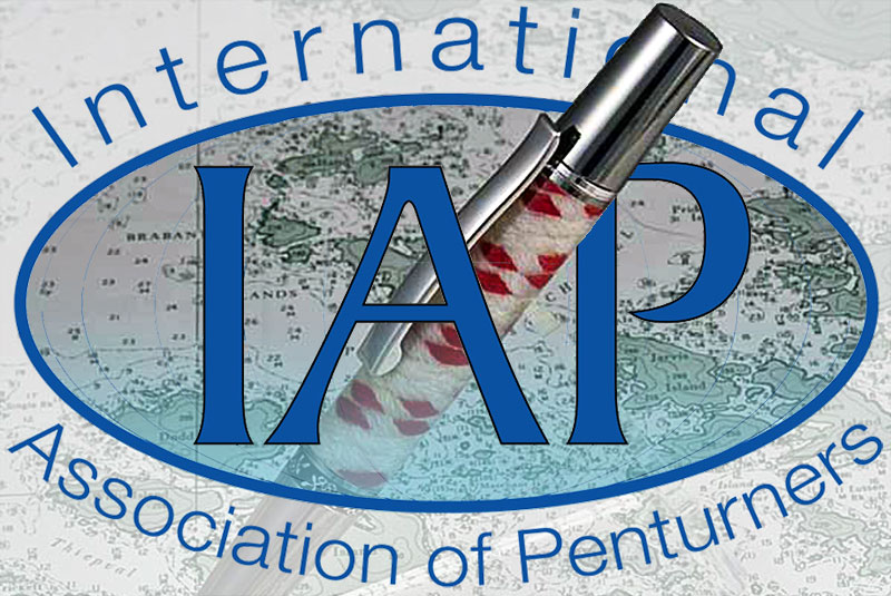

I wanted the pen to have more of a 3-dimensional look, as if it were sticking up out of the logo, so I added a couple more layers. First off, I duplicated the pen layer and erased the bottom half of the pen.
This is what it looks like with this layer on top of the logo.
As you can plainly see, however, the pen image doesn't intersect the "A" cleanly. Rather than trying to erase to that edge, I just duplicated the IAP layer, and erased everything except the A.
I then put that layer on top.
To give a more 3-d look, I added drop shadows to the pen.
  1. Make the pen layer active.
  2. Click "Window->Effects" to display the effects window.
  3. Select "Drop Shadows" from the Effects drop-down list.
  4. Select the "Soft Shadow" effect icon, and click "Apply".
  5. Repeat for the pen upper half.
Now it looks like this.
I thought the map was still a little too prominent, distracting from the pen and from the "IAP' text, so I added one more layer, right above the background. I filled it with white and made it 10% opaque.
That makes 3 invisible layers (Original logo, logo with transparent background, and logo center), and 9 visible layers. From top to bottom, they are:
  • Layer 1 - "A".
  • Layer 2 - Pen upper half with drop shadow.
  • Layer 3 - "IAP" with blue oval.
  • Layer 4 - "International Association of Penturners" text.
  • Layer 5 - 75% opaque white border.
  • Layer 6 - 75% opaque light blue to transparent gradient.
  • Layer 7 - Pen with drop shadow.
  • Layer 8 - 10% opaque white.
  • Layer 9 - Map.
The photo contest required that the image file size be less than 150kb, so I had to save a compressed jpg. My preference for doing that under Photoshop is:
  1. Select "File->Save for Web".
  2. Choose JPEG.
  3. Select the desired image quality. In this case, it was the highest quality I could get under 150kb - about 50%.
  4. Click Ok, and save to the desired filename/location.
Here is the final result.
I hope that was interesting. Feel free to chime in with any questions, comments, or suggestions.
