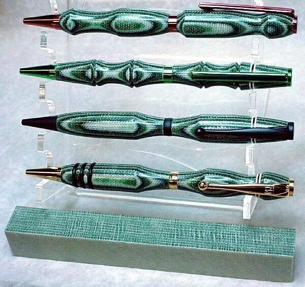

The stuff I was thinking of that is the other form of Bakelite was blueish green, it was layered, it is also popular in knife handles. Anyone remember who made it? Think it was Ed Davidson.
*edit* This stuff is what I was thinking of:

Those pens look a lot like Micarta which is am impregnated linen often used for handles on knives. It is probably a trademark name for the same stuff.
