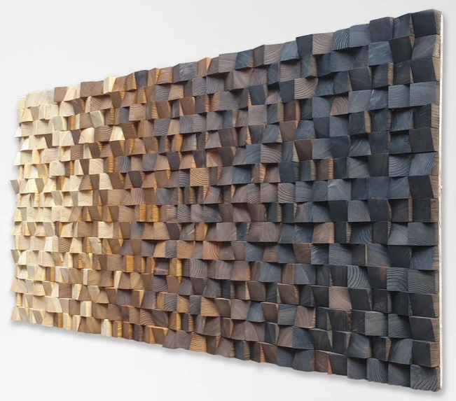

I've just begun collaborating with a local artist who wants to make a fairly large mural out of wood. The idea we've come up with is to design impressionistic type pieces based on arranging square wood blocks into the larger image. The plan is to develop different finishing techniques for the blocks to give them different color intensities, contrasts between the grain, and overall color. The blocks will be used as 'pixels' if you will in the larger image, so the smaller the wood block the higher the resolution of the final image. I would imagine the blocks will be between 1 and 2" square. The idea is mine but I'd never be able to do this without an artist. She'll be doing the true 'art' part and I'll just be providing as wide a variety of finishes on these blocks as possible. The wider her variety of wood blocks to choose from the better the end result will be.
So as an example, here's an art piece I found on Etsy. It seems the artist here has either baked or burn treated these pieces. I'm taking this idea as inspiration on how I can vary the finishes on these wood blocks. But I'd like to have as many coloring/finishing options as possible, which is the purpose of writing here.
What I need now are both wood species suggestions and finishing techniques. Just brainstorming so everything's on the table.

Thanks Alan. I'm definitely going to try shou sugi ban for one of the upcoming pieces.
Have you considered using oak with ebonizing? You can make your own ebonizing solution, to differing degrees of intensity, and oak having such high tannin content will ebonize very nicely. With a strong solution and multiple coats you can make it almost entirely black, whereas with a weak solution and single coat you would have a lighter reaction. This could give you a nice gradation between the lighter natural color of the oak, and what could ultimately be a nearly entirely black color (although the grain would still show through).
