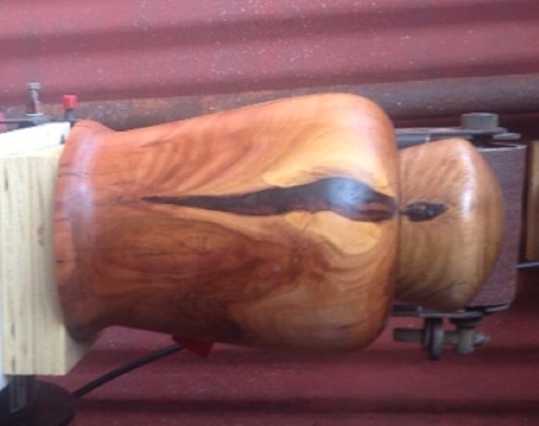

Tried my hand at something totally new for me. Was asked to make a pet urn. Took three tries (first one blew apart the second broke a chunk out).
The main body is apricot and the top is mesquite. The bark inclusions were filled with espresso grounds and CA. The finish is hand rubbed lacquer. The inside is sealed also.
The picture has some glare sorry about the quality
C and C welcome

What are the urn's dimensions? How big was the pet whose ashes will be interned? Did you create a threaded lid?

The main body is 7" tall 5" at the widest, with the lid it is 9" tall. The urn holds 5.5 cups of rice.
I talked with a vet and he informed me that the rule of thumb is each pound the pet weighs translates to 1 cubic inch of ashes. A cup holds approx. 14.4 cubic inches. I would rather have to much room than not enough.
Hope this helps if I can help let me know.

LOL even though I love math and playing with numbers I did what one friend suggested and visulized a quart jar (or what ever size you need). That seemed much easier than trying to do the math for a hunk of wood.
Thanks, Bill. That helps quite a bit.
