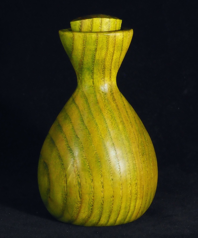

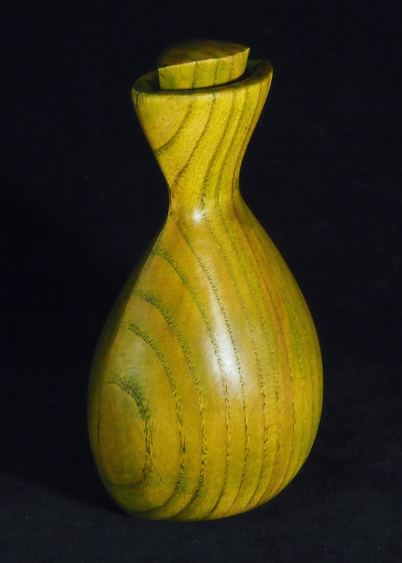

Ash approximately 6" tall. Turned using the "lost wood" approach.
Cwalker935
May 18, 2014
3,506
Richmond, Va
In a nutshell, You glue up three pieces of wood with layers of paper from a brown paper bag between the wood layers. The wood in the center will be the "lost wood". Carefully mount the piece making sure it's centered on the middle layer, (you have to be precise so that the outside pieces end up being Symmetrical). Turn and hollow. Separate at the glue joint, carefully sand off the paper and glue maintaining the flats. Glue the two outside pieces back together, sand and finish.
Beautiful! What is the lost wood approach?
I see. Very interesting. I was wondering how you got the oblong shape on the lathe and this explains. Very cool technique!
