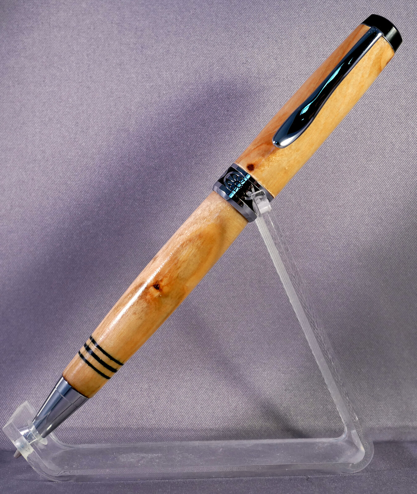

When my son and his wife moved out of town almost 5 years ago she gave me a branch from the cherry tree in their back yard asking if I would make a pen out of it. I stored it to let it dry completely before turning it this week.
She wanted a .5mm pencil which, as far as I can tell is only available in the Schmidt DSM 2006. I've made a number of perfect fit pencils for another son who used them throughout middle school and high school, so made this for her. It came out much nicer looking than I expected.
I will give it to her tomorrow!

For those rings I cut grooves and attempted to burn them with wire, something I've done before, but I couldn't get the cherry to burn. I ended up painting the grooves. Then the paint ran when I applied the CA finish...

Whatever ..... those rings still look really good and add a lot to the overall appeal of the pencil !! . Well done !!

I was using copper and it failed before getting the cherry hot enough.
I like burning instead of painting, so I'll lay my hands on some better wire at some point.
I generally use a guitar string, but it's even easier to notice when you've stolen one of those.
