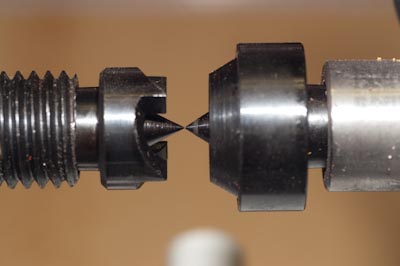

We all mention stuff that you probably have no idea what we are talking about, we forget that, we knew nothing before we learnt so, I decided to give you some images that you could use to test your lathe alignment as per the pics and show us how yours line up.
In the pic, you see the live centre on a headstock and a dead centre on the tail stock, bring the tailstock towards the headstock with the life centre on it ( make sure is on properly, the live centre should be installed on the headstock shuft/spindle hole and not on any chuck. Make sure the hole in clean before you insert the deadcenter.
An aligned lathe will have the points of both centers touching dead on...!
There are 2 main types of misalignment, the vertical and the horizontal, looking front/level on, is the horizontal, looking from above is the vertical.
Take a couple of pics of how your stand, and we will be able to guide you through the adjustments, if they are minor ones, big differences may mean a lot of different things and normally of much worse nature, such as factory defect or considerable damage in transport...!
Let us know...!
PS: The problem that you've got, has nothing to do with your work speed, the problem seems to be "constant"'consistent so, its of a mechanic nature...!:smile:
Cheers
George

My lathe is Holzstar DB 450. Below I enclosed photos of centers (from the top and from the front). I do not know if this is the problem, but the live center in tailstock is minimally below the dead center in the spindle.
Once again, thank you all for your help. I don't give up and I practice all the time :).
Marion Peter here a sure fire and quick way is when you bring the two centres just before they meet insert a thin blade from a feeler guage bring the points together there are 4 ways the centreing may be out this will show immediately.
For accurate alignment you need two sure dead centres one in the head stock and one in the tail stock clean rails clean morse tapers clean under the tailstock before declaring anything just for starters.Most head stocks bolt onto the bed this allows for corrections in height easier than at the tail stock, be very aware of the parrallel running of the tail stock in relation to the head stock easily checked with a magnetic based holder with a dial guage from or measuring a true round piece in the headstock chuck, the chuck can be checked the same way. If the chuck jaws are removeable do it carefully fully clean the ways and if applicable tighten the holding screws. Just some basics mate.
