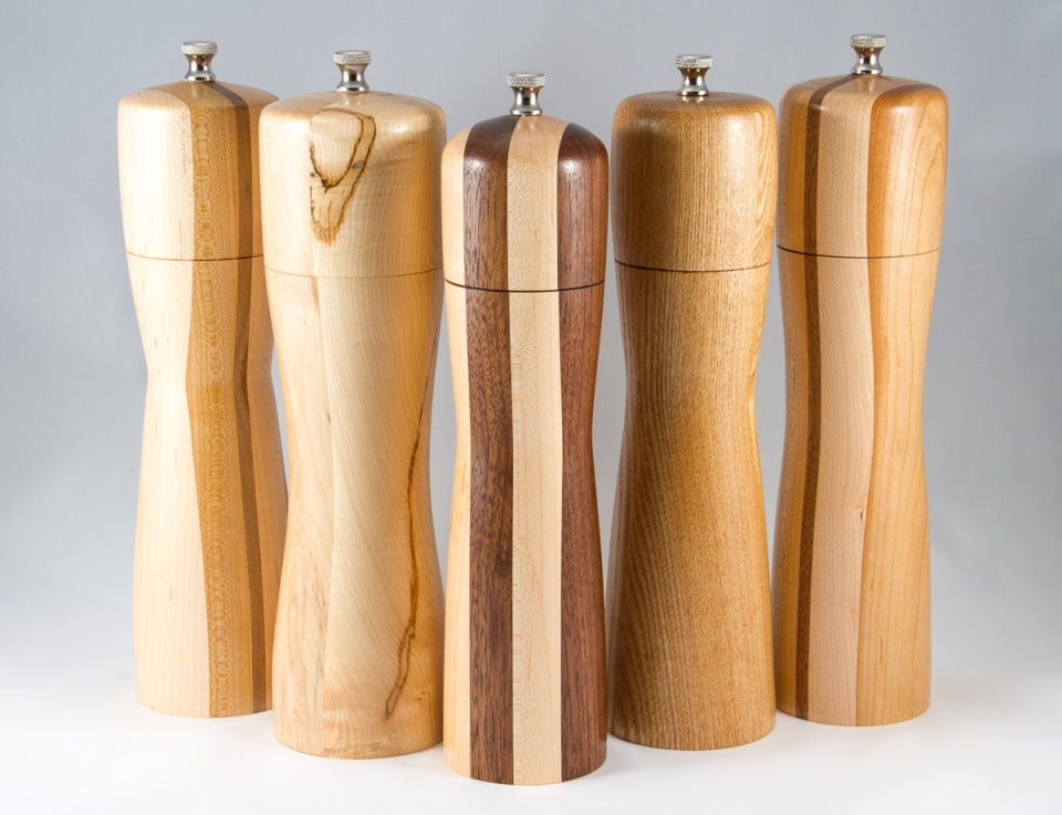

Just finished up a few peppermills this weekend.

Really nice looking mills... great design. And love your blanks.did you do the glue-ups yourself?
Although personally, I'm not partial to those that use the top knob... I prefer the Crush/Grind style. I did buy 6 of the multiple sized mills from PSI and so far have made 3 of them... I'll make the other 3 soon, but think I'm going to modify the drilling instructions... the 1 1/16 through hold seems a little small to me. I'll probably go to the 1 9/16 drill bit for the through hole and only drill the 1 1/16 at the bottom for the grinder.

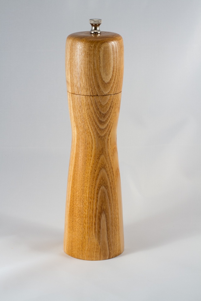

Chuck, yes I did make the blanks, the 2 outside ones are Cherry and Maple with a center strip of Walnut. The middle is maple/ Walnut and the other 2 are Maple (left) and Oak (right). I have to say Oak is not usually one of my favorite woods as the grain can be a real pain to work with. I really like how this one turned out although the group shot does not do it justice. here is another view of the better side.
I have a few CrushGrind mechanisms waiting to become mills, do you have any specific tips on those? There seems to be various opinions about glueing them in and whether to cut the tabs off or not.

Really like the oak... nice grain and good design.
