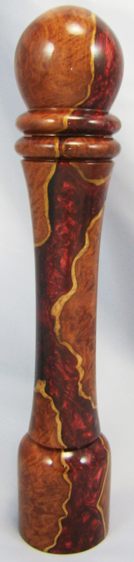

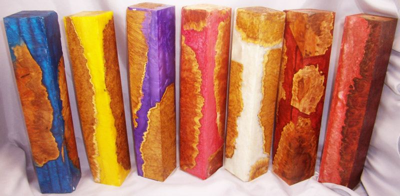

I have made many worthless wood style blanks as shown below, but these often take a few casts, unfortunately postage to USA just makes them un economical to send.

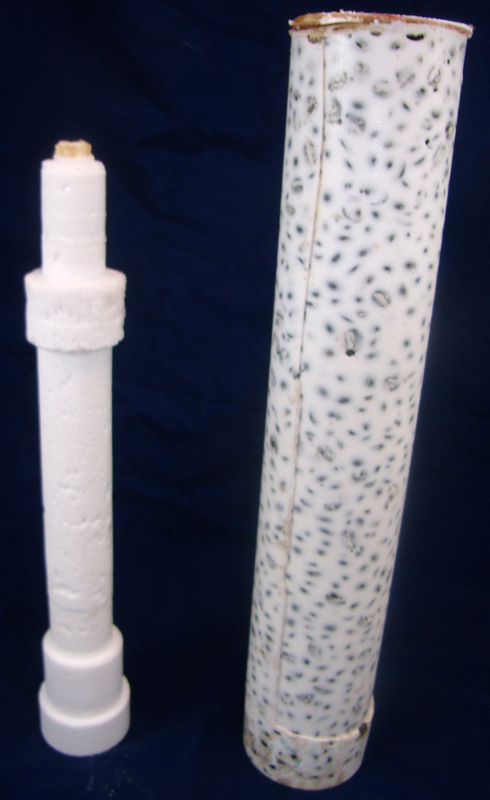

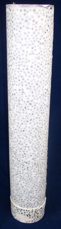

I have also made coffee bean and peppercorns both cast in white resin for restaurants. Both these have a plain resin core (as shown in coffee bean cast one to ensure the cast product do not contaminate the peppercorns to be ground. The ones are still waiting to be finished.
