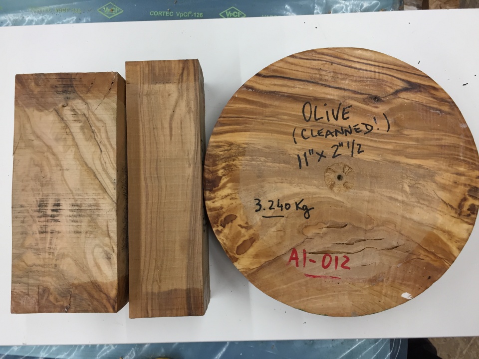

We did order from him ages ago when he had only about 25 or so woods in his arsenal. If I remember right we got a 20 kilo box of primarily olive bowl, pepper mill and an assortment of penblanks. I think the total was about $300 or $400 Canadian including shipping by sea but may have been less. It took about 2 months or so to get here and the only complaint was from the mail lady lugging it to the front door. Try him. He is a stand up guy.
Added a picture of a few pieces.

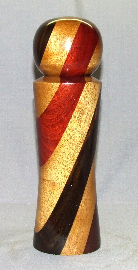

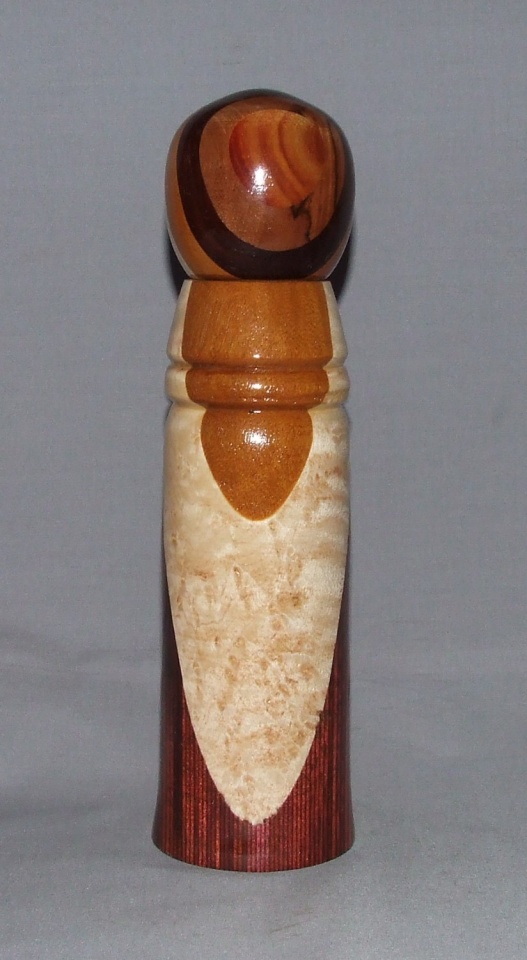

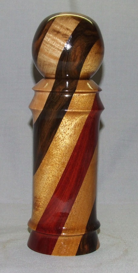

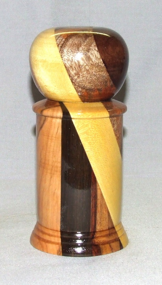

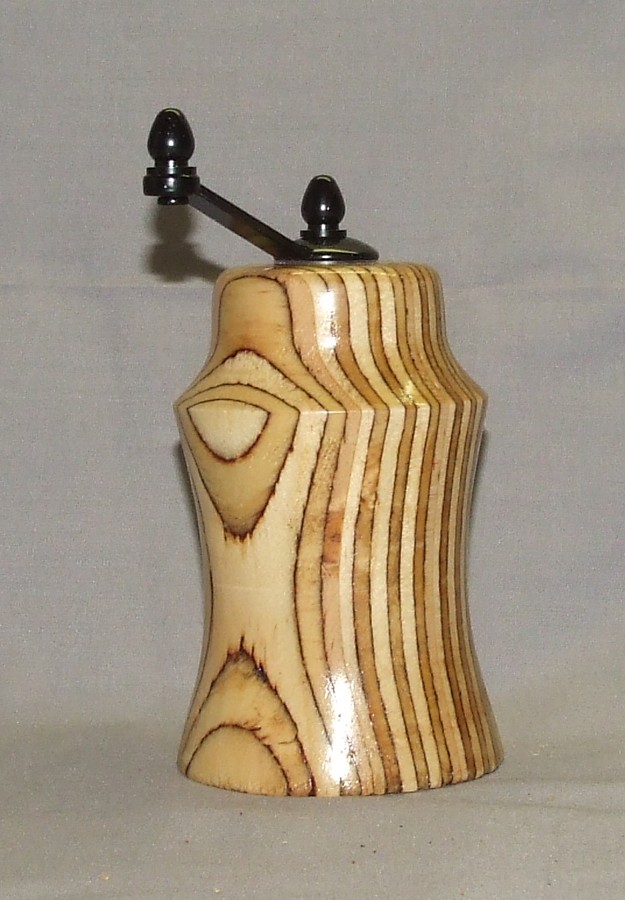

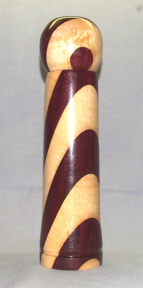

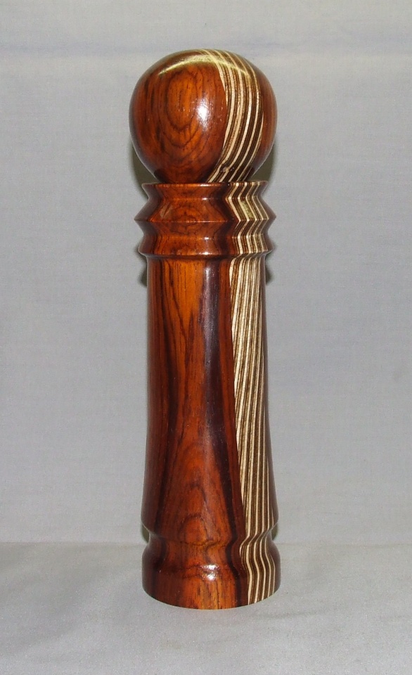

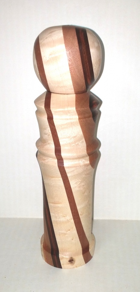

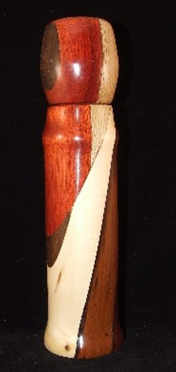

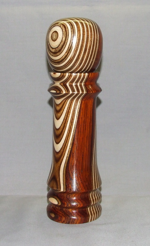

I use a lot of flat boards for my mills... possibilities are endless... a few from boards..
I've even made one from ordinary Lowe's plywood... glued several pieces together to make a 3 x 3 x 12 block, then cut into 4" lengths for the little crank mills from PSI.
I some times stack boards together until I get a block of wood about 12-14 inches wide x 3 inches thick and about 12-14 inches long, then cut at angles into 3 x 3 x 12-14 blocks, then glue the triangle cut offs back together to make the angles on the last mill.
The fourth and fifth mills are combinations of the spectraply and flat stock.. these two are Spectraply Tigerwood and Cocobolo.
Just have fun with it.
