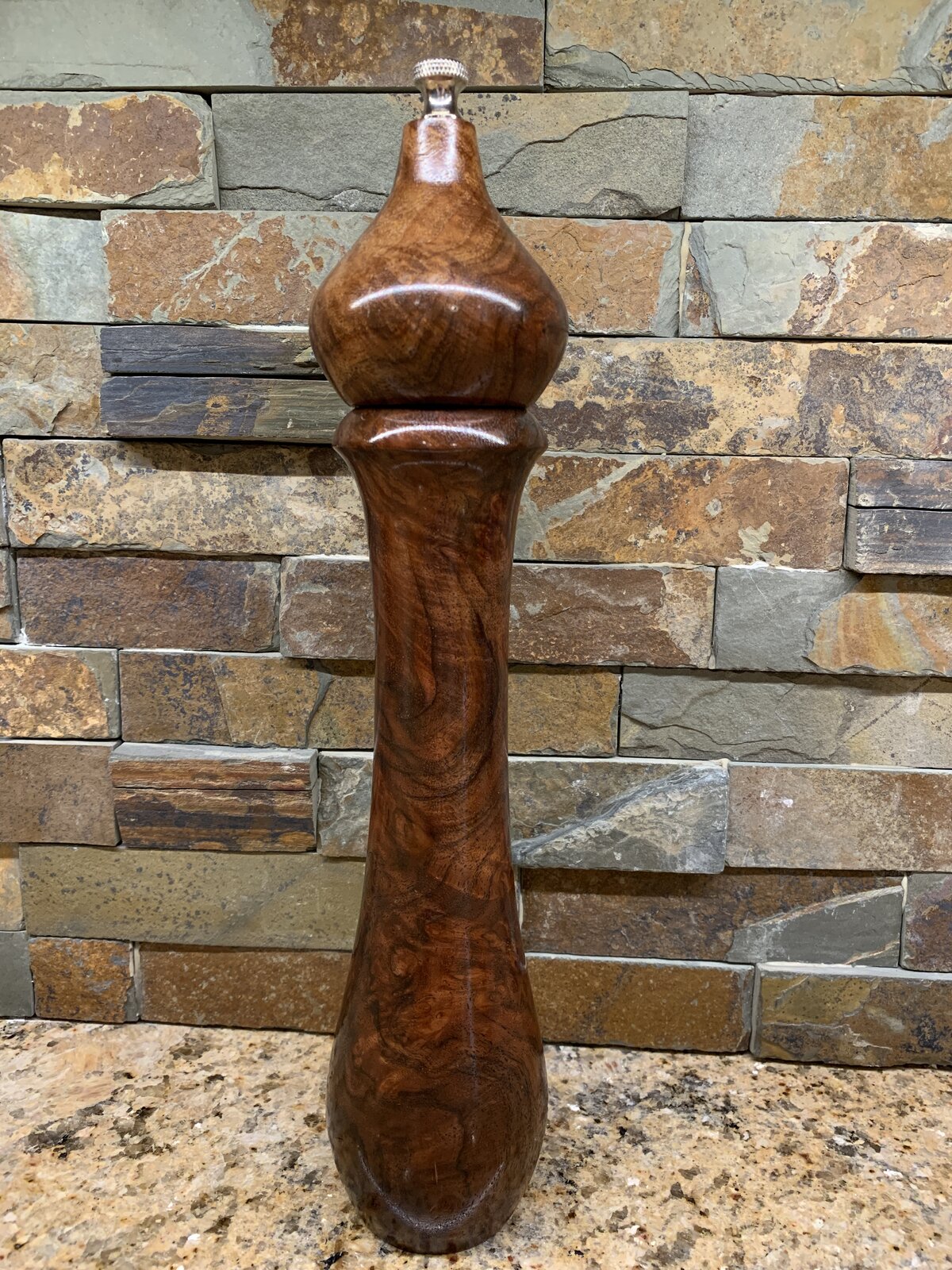

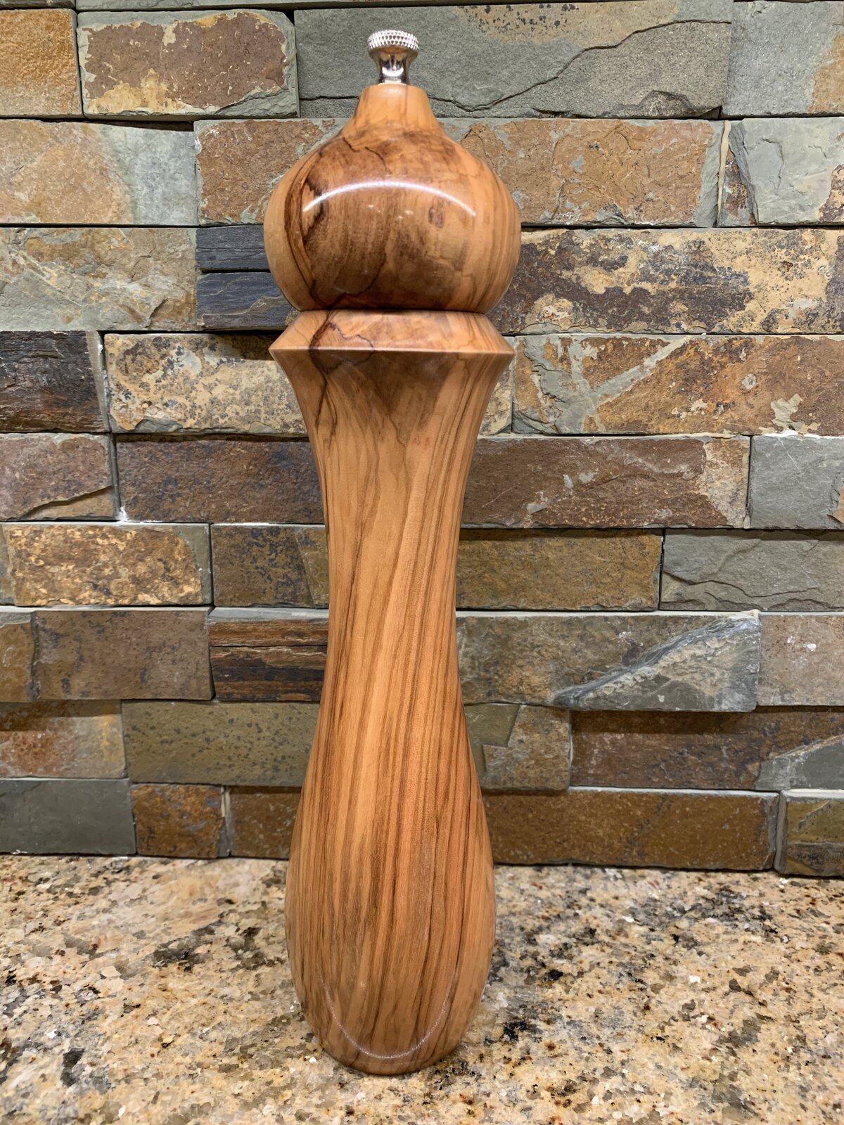

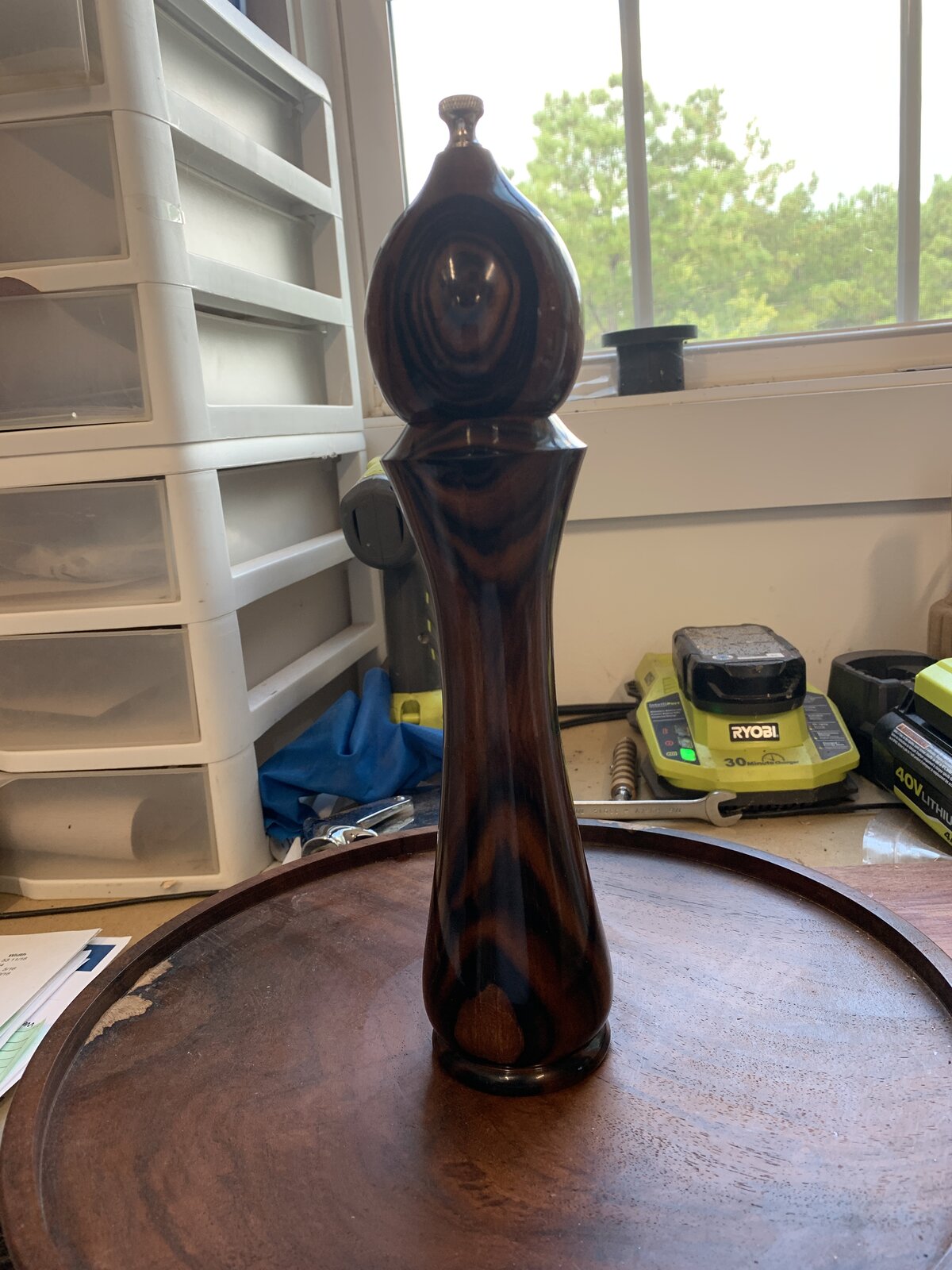

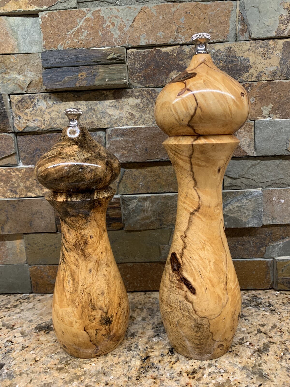

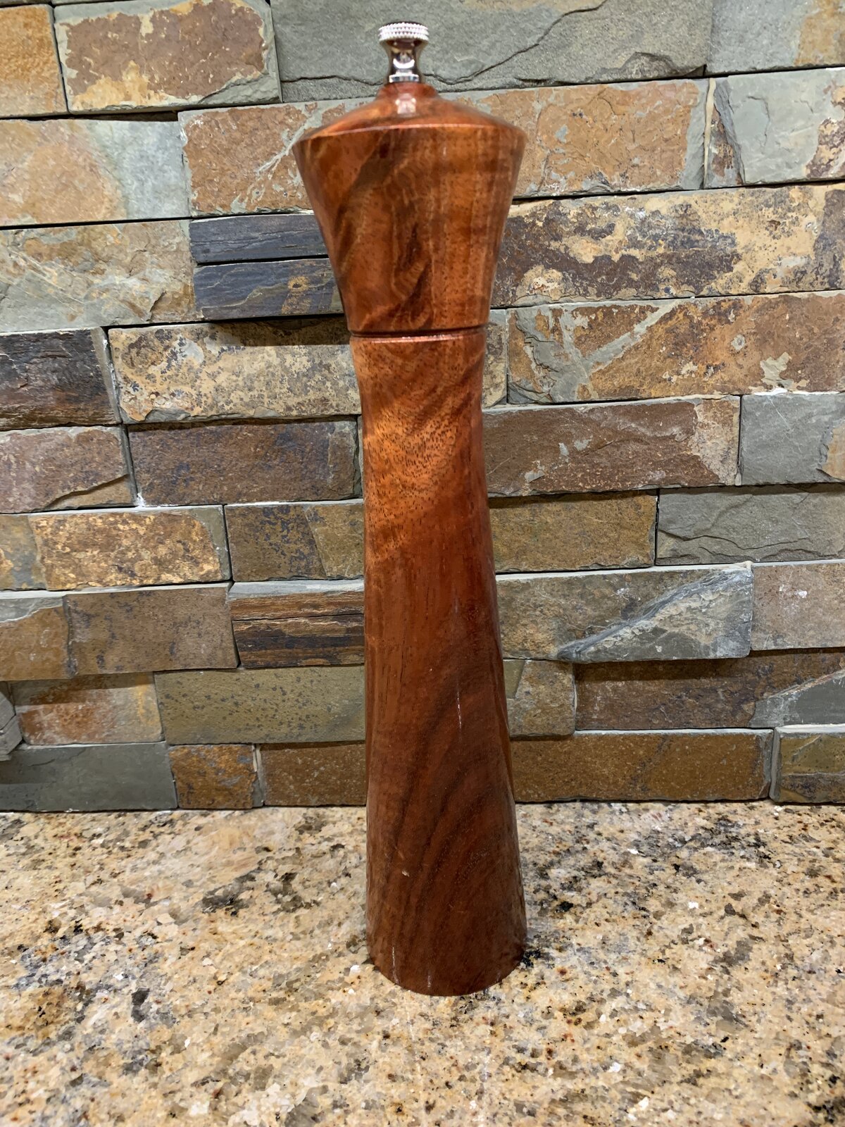

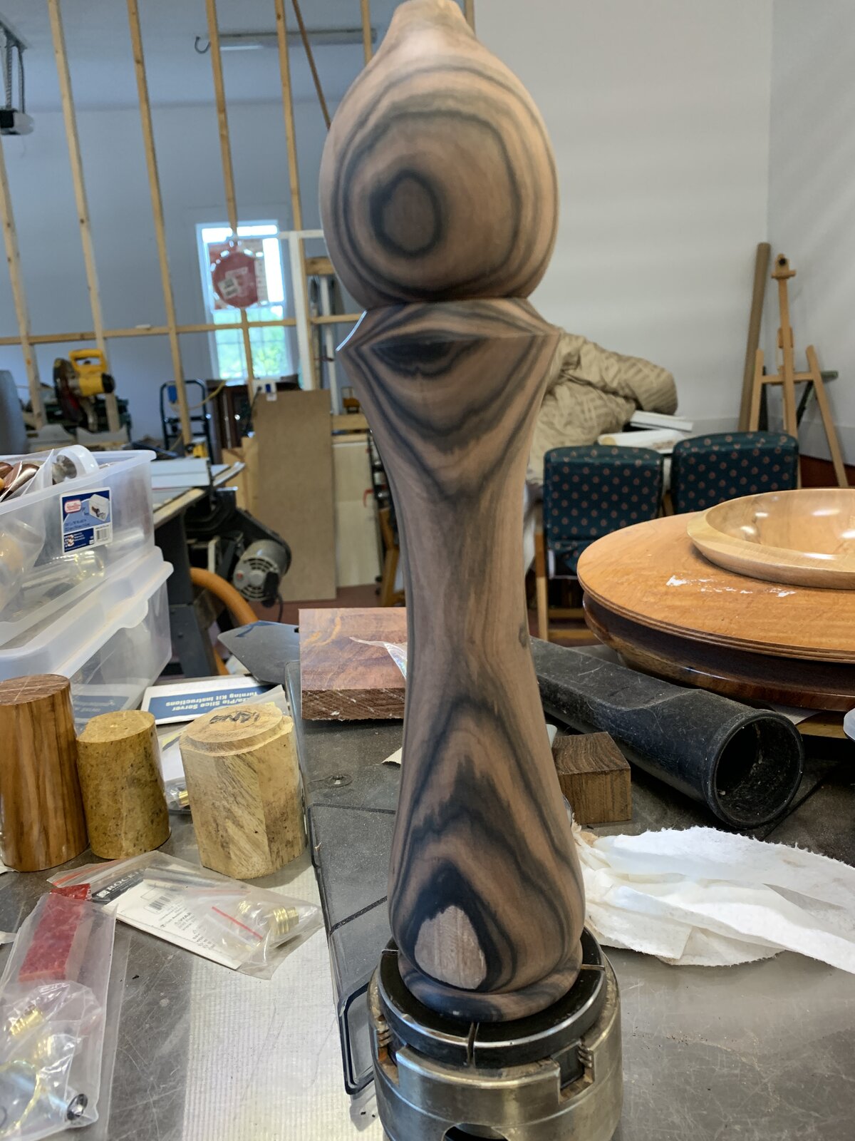

I attached a few quick pics (not very good) of a Mill I did as a wedding gift out of Mun Ebony (prep and post finish) and a few others ( olive wood, Buckeye burl, walnut burl and Blackwood)
