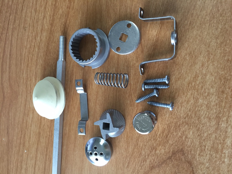

I purchased an 8" pepper mill on clearance at Woodcraft. It is their part # 835290. It is apparently obsolete since they have no info on the website. I am looking for turning and assembly instructions. Can anybody help?
djrljr; thanks for responding. I already saw what you sent and I appreciated you taking the time to respond so quickly. The kit that I have has a rubber plug which I would assume is the peppercorn fill point. I am making the assumption that the turning instructions are similar but I don't want to ruin a blank without seeing this particular kit.
I have attached an image of my kit for reference.
The kit you show has both a pepper mill and a salt shaker.
As is stated above, the rubber plug and the "salt shaker top" are for the salt, the remainder are the pepper mill mech.
The last "how to" you will find on this page: Exotic Blanks :: Instructions
will give you a pretty good idea of how to turn and assemble, but check the dimensions on the one you have (especially the grinding mech) to be sure it is the same components. (I think this is the one WoodCraft sells)
