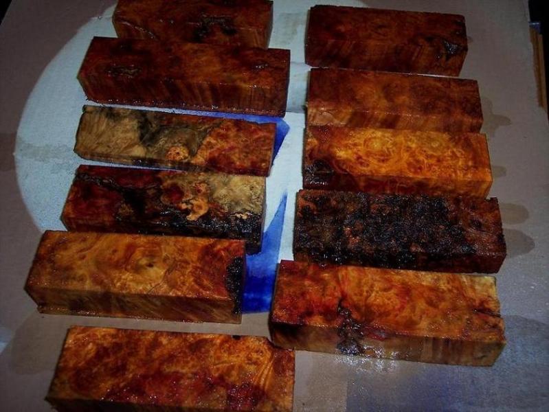

These pieces were the bottom of the burl on a box elder. REally wet and soft almost crumbling. Soaked in pentacryl over night, and pulled out. Anyways here a pic of what they looked like when I pulled them out, but not sure if theres a way to harden them up now....
Larry

I used it with a vacuum for 24 hours a month ago and ruined a perfectly good blank. It's still damp and smells like motor oil. I'll never use it again.
