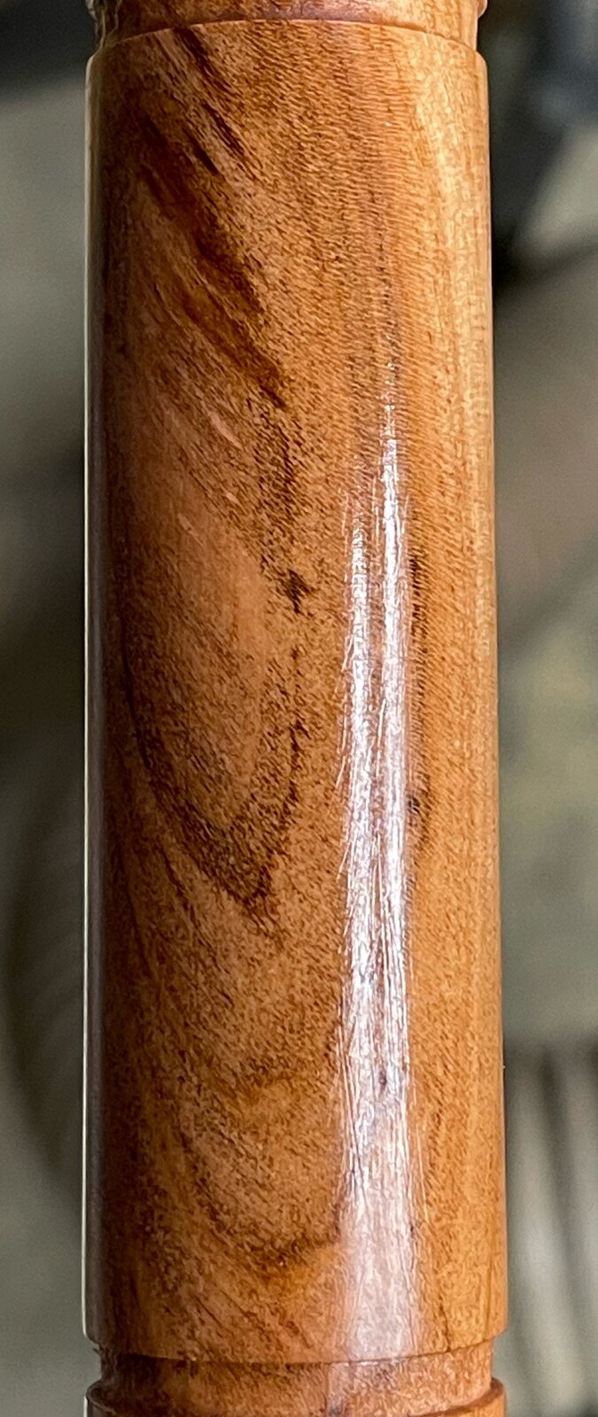

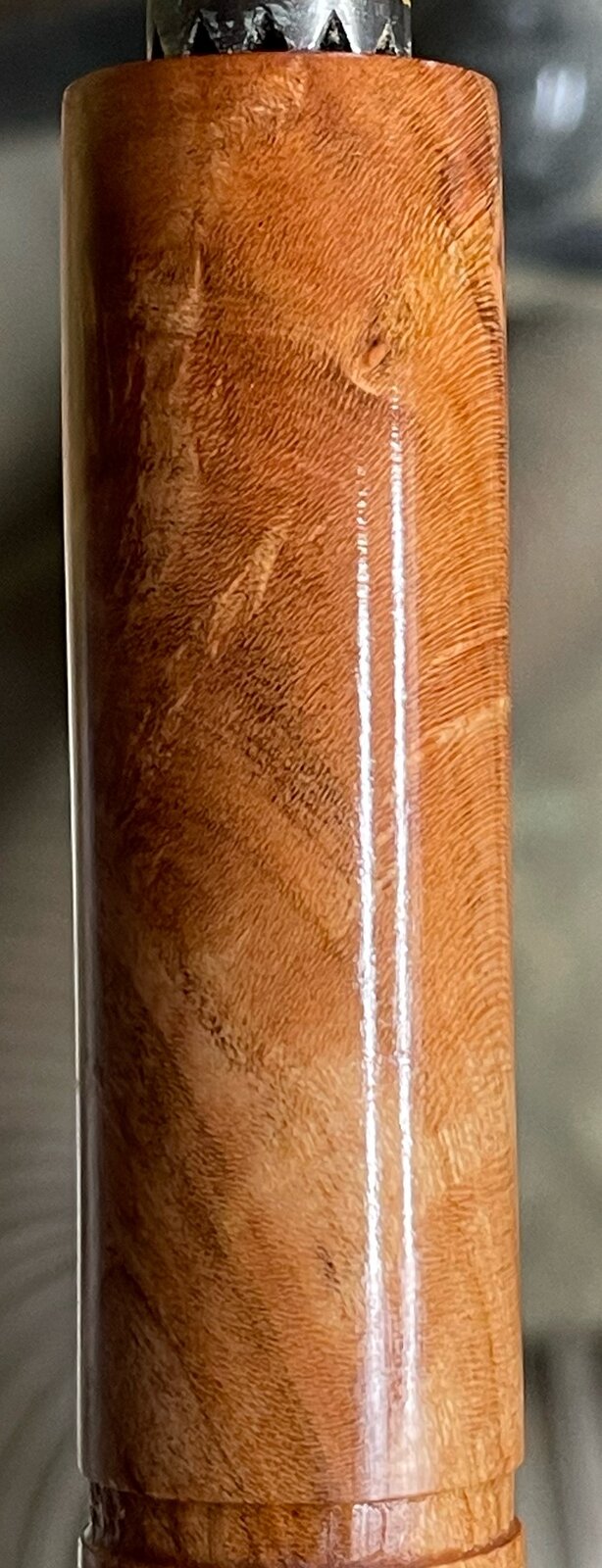

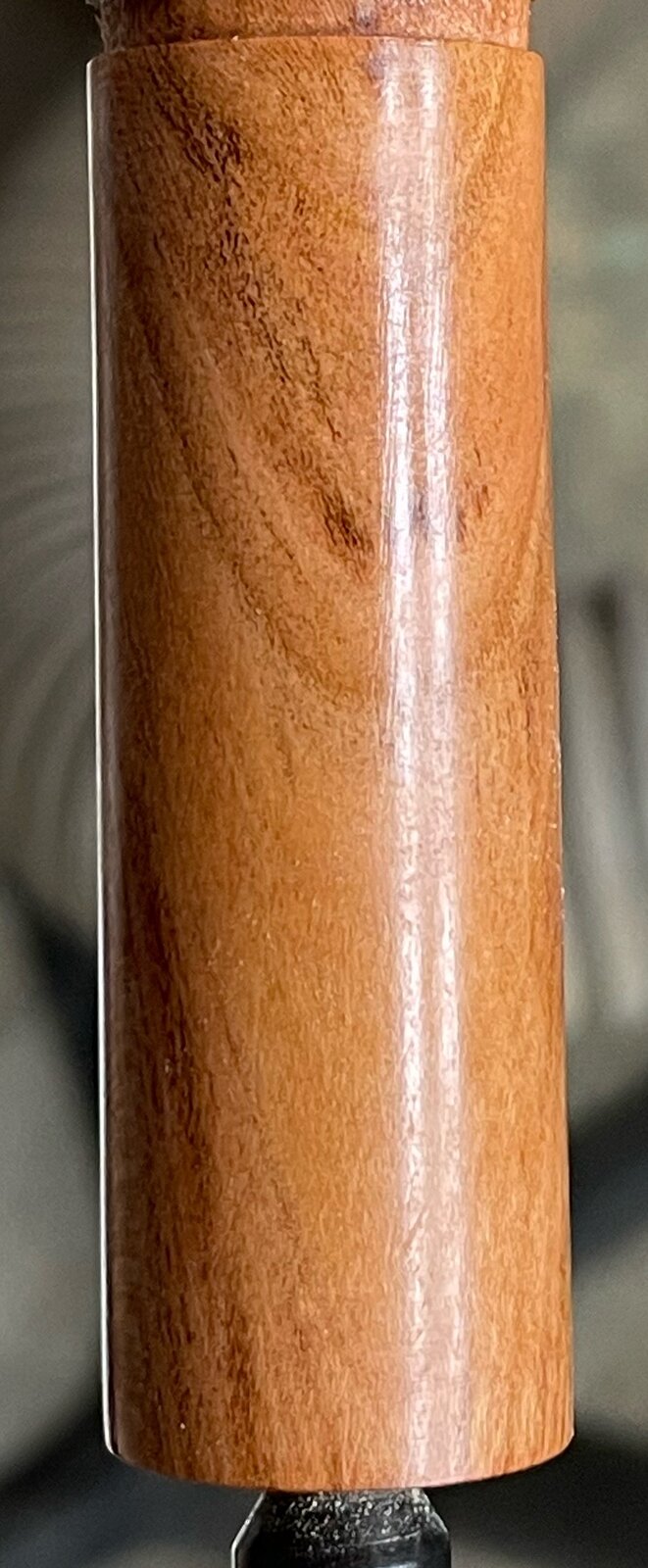

At tonight's meeting of the Richmond Penturners Club we will be demoing and discussing various finishes which will include CA finishes, French Polish, and Pensplus. I will be doing the Pensplus demo. In preparation, I applied Pensplus in three separate ways to a piece of black cherry. In each step I sanded to 600 with the lathe on and then longitudinally with the lathe off with each grit. After sanding, I applied 6 coats of Pensplus at high speed, buffing between each application (2 forward, 2 reverse, 2 forward). The differences in application occurred during the sanding process. I think the 3rd approach yielded the best result, however, I wonder if the walnut oil would darken lighter woods a bit.
#1 dry sanding to 600, burnishing with burlap, applying 6 coats of Pensplus
#2 Applying Pensplus between each sanding grit, applying 6 coats of Pensplus
#3 sanding with walnut oil with each grit, 6 coats of Pensplus
