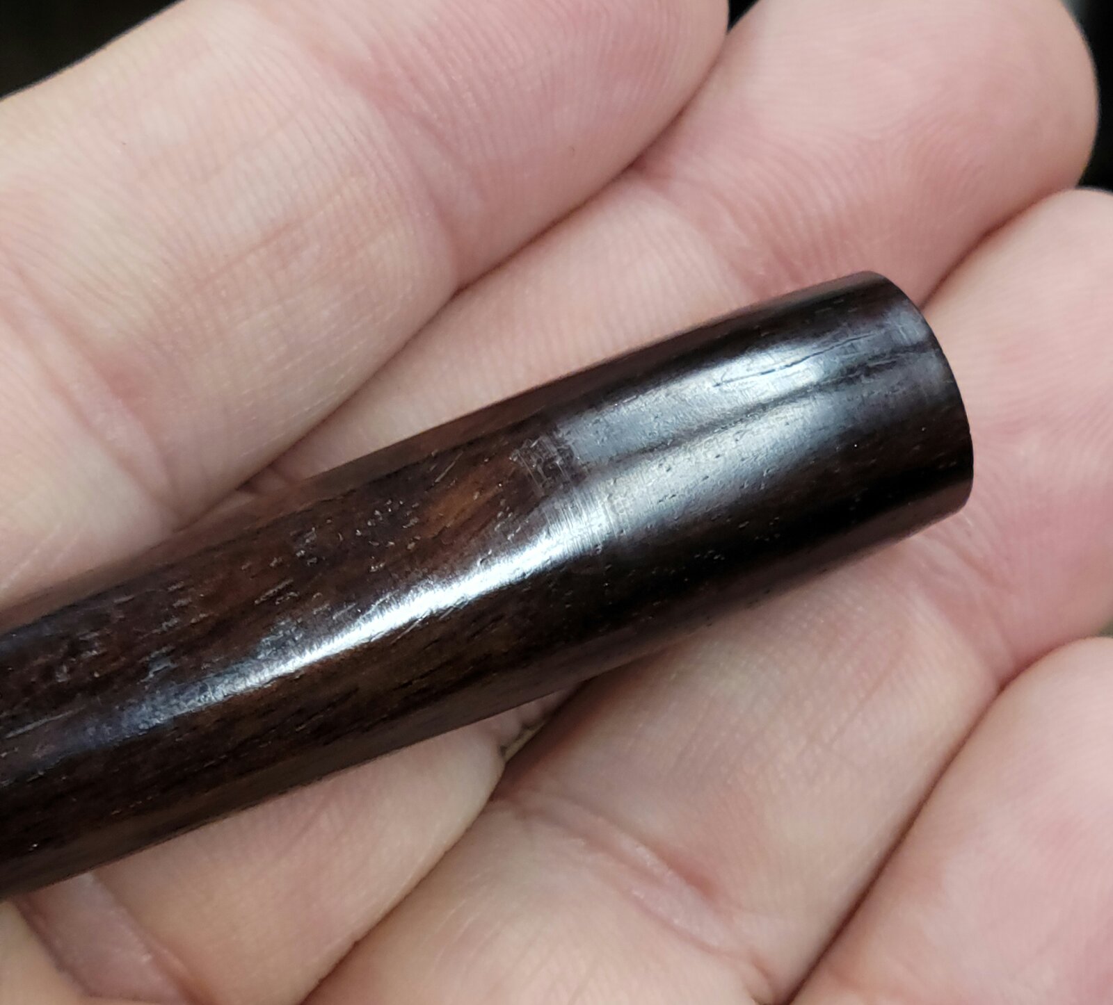

I have had good results with Pens Plus overall, but often find that parts of the barrel dull after sitting for a minute or two. I'm pretty sure this has to do with the density of the wood, and we know that can vary a little even in the same blank. I'm just going to say this is a problem with friction polishes in general because I've had the same results with Aussie Oil.
Of those that use friction polishes...
  • How many coats do you typically use?
  • Have you had times that it just didn't seem to produce the shine you wanted no matter what you did?
  • Does it work better if you pre-treat the wood with walnut oil, or maybe even some other sealant?
Here's an example. This has 4 coats. This is Bolivian Rosewood.

I use 3-4 coats of pens plus. I do not pretreat with anything. I've had a few pens that I wasn't very happy with the results, but for the life of me can't remember what wood I used.
I have a pen with Bolivian rosewood finished with pens plus, it has more of a satin finish on it than other pens I've finished with pens plus. Although the finish is even, so I'm pleased with the result

I'm pretty convinced this is the issue. Looking at the blank again, I think it's East Indian Rosewood instead of Bolivian. That is less dense and less oily (to me anyway) and will definitely absorb a little finish.

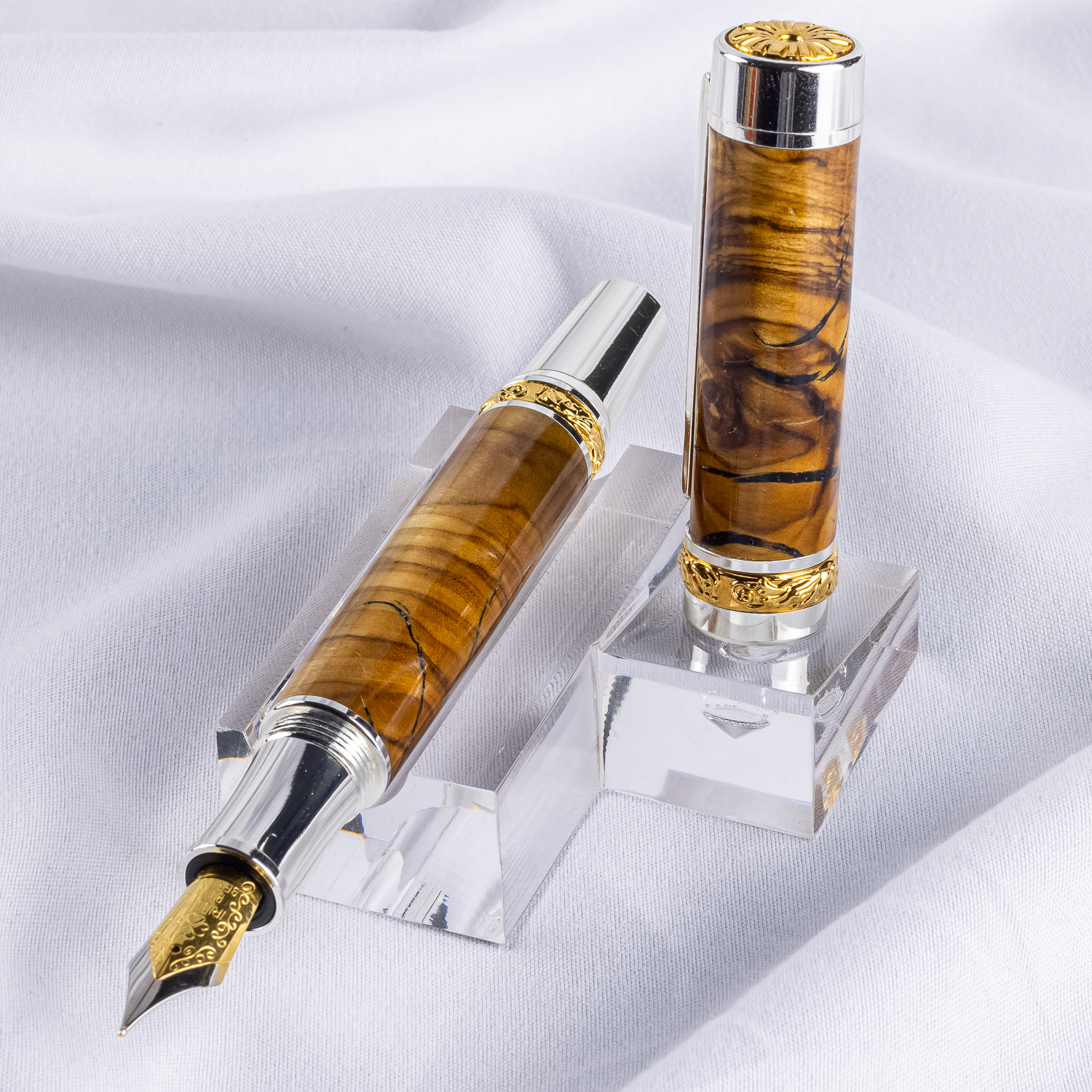

FWIW, just to make sure everyone is understanding, when I say crystal-clear glass-like finish, I really do mean exactly that, not something that approximates it:
Pens Plus, if the finish is good, should go on pretty easily, and should produce a finish like on the above pen, without a lot of hassle. You'll need to wet-sand or pre-finish with the pure oil if you think the wood might soak up a lot of finish. You should only need a couple of coats, rathe than a dozen. Another example of a good Pens Plus finish (the glassy gloss is the Cosmolloid 80H forming a protective film over the shellac and oil base):
