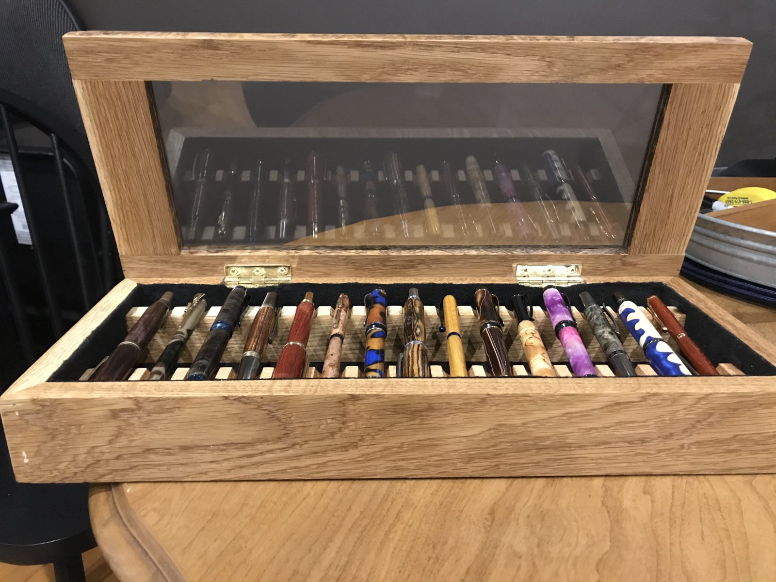

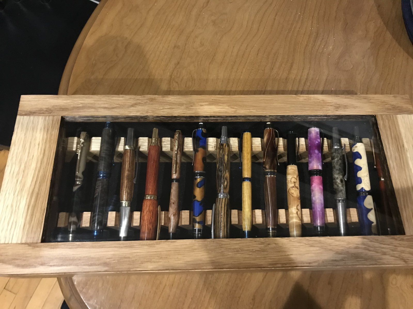

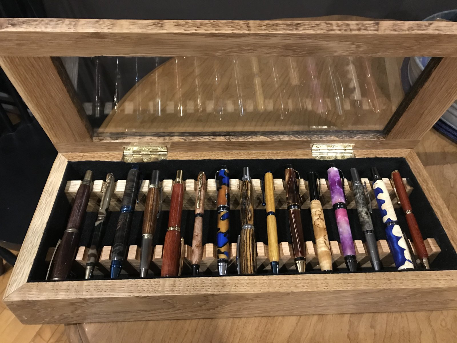

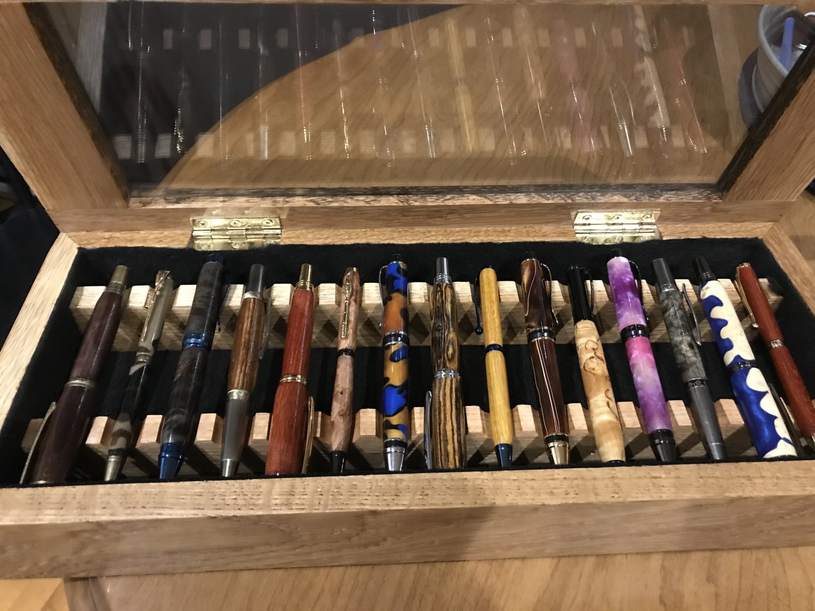

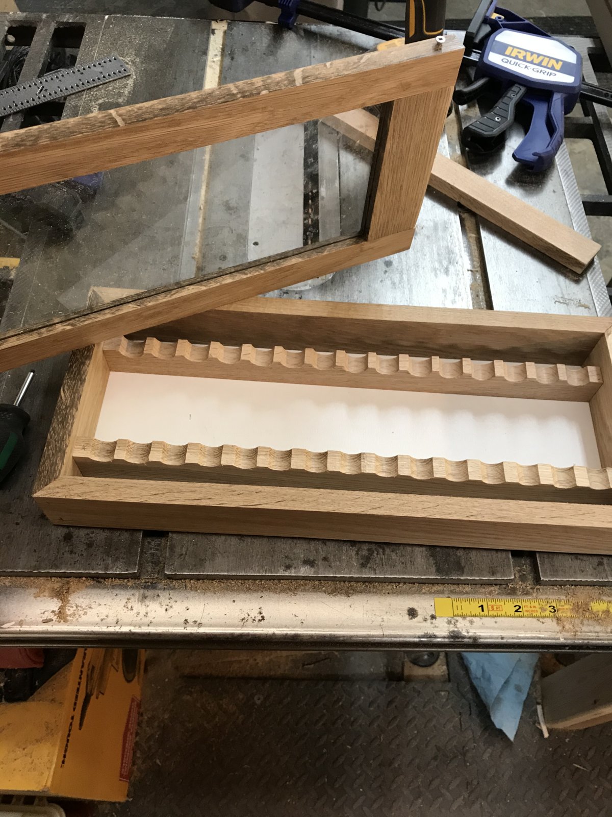

I was getting tired of having all my pens individually boxed or sleeved for when people would come over to look/buy pens. So I decided to take a day away from turning, to build a display case. Really happy with how it turned out.
Woodworking is my main hobby with just now getting into pen turning within the last couple months. A suggestion for some if they have yet to use it, is a product called Olies Oil. Really brings out the colours of some wood.

It is always good to have your product out in the open so people can see it and not have to work to open things to actually see something. Turns people away. You did a nice job with the display case and probably will need many more as you continue to add product. Good luck.

Not only is the case a work of art the pens look great also.
I like that you used a glass top on it so you would not need to open the lid to display them.
