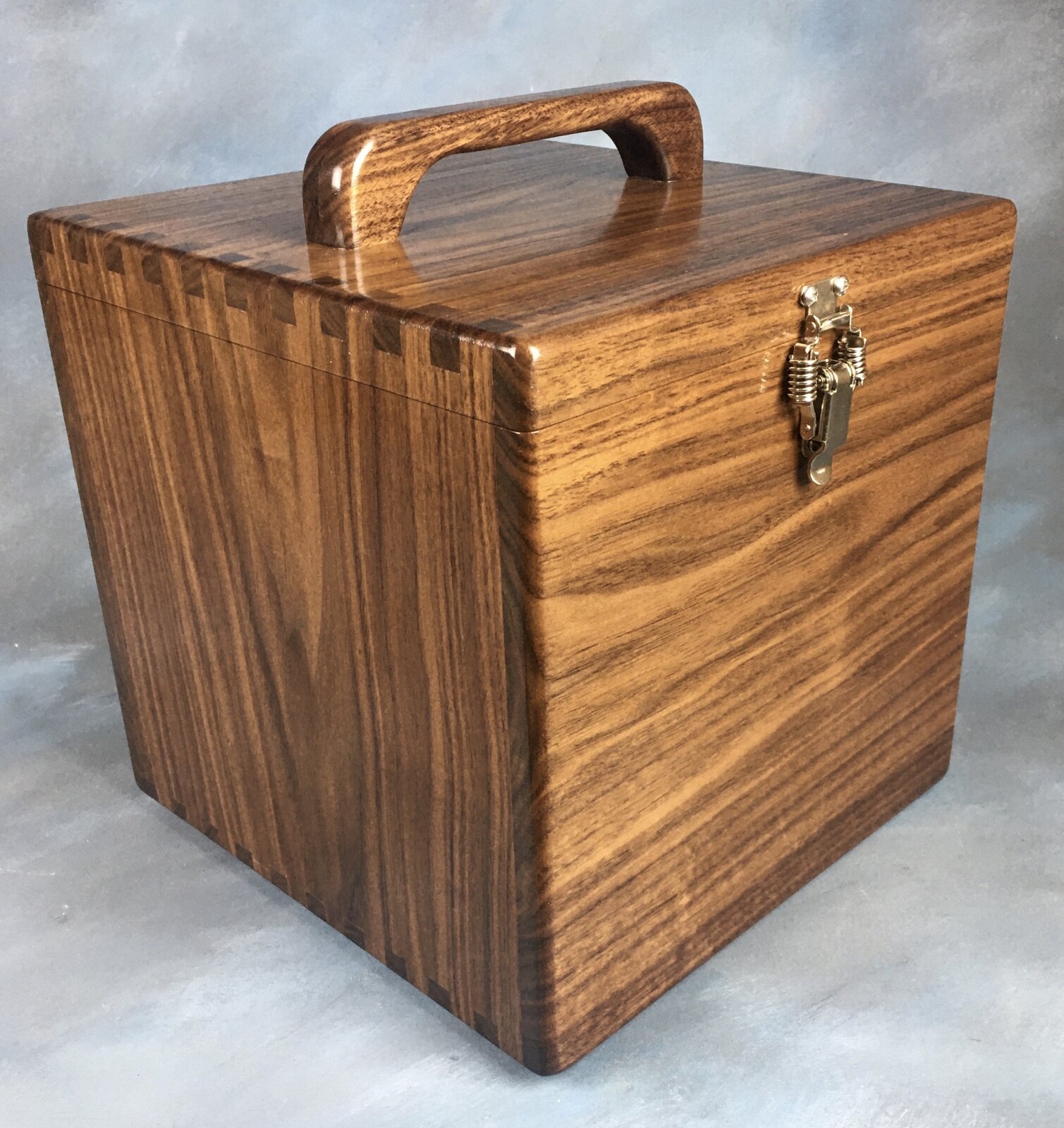

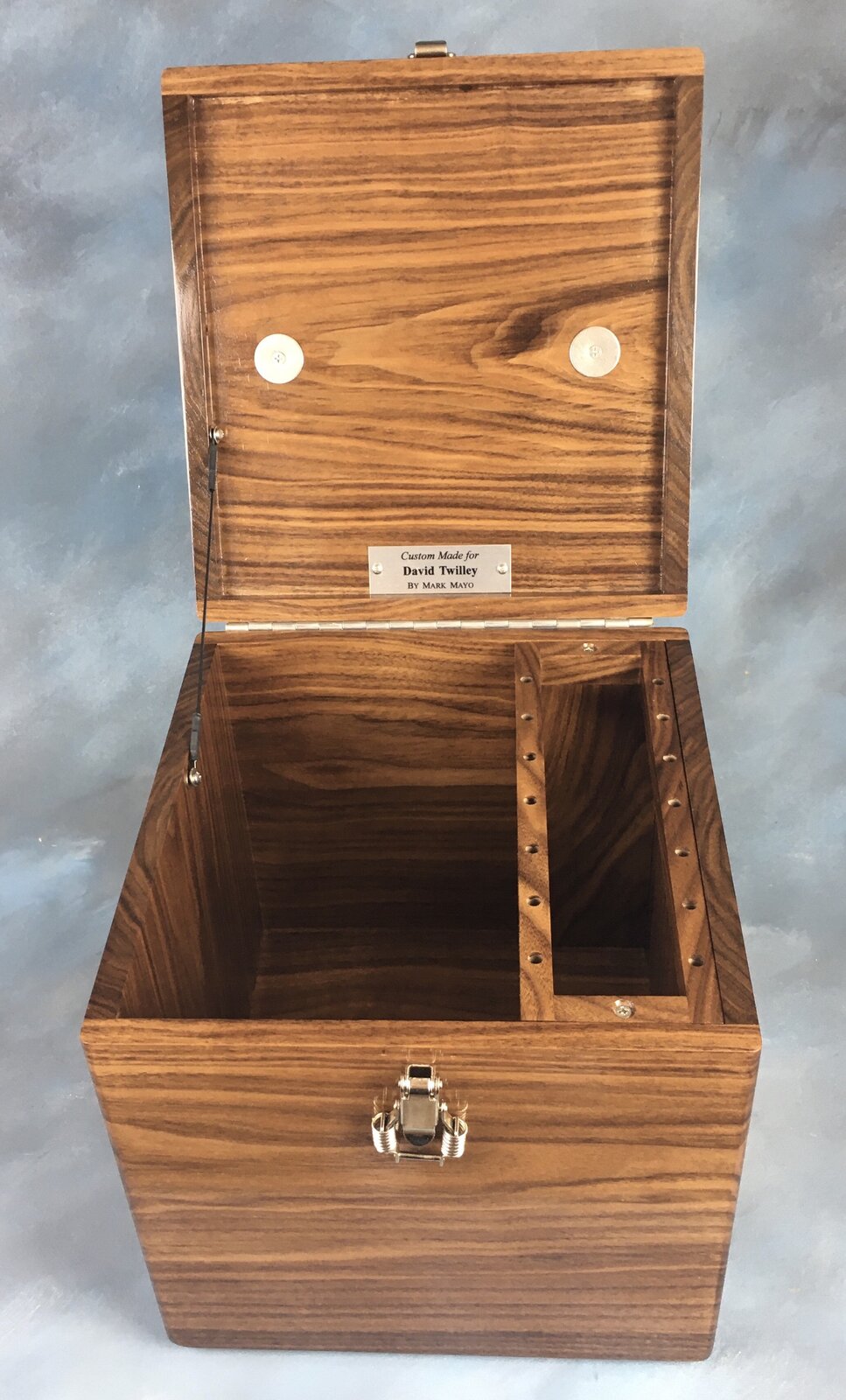

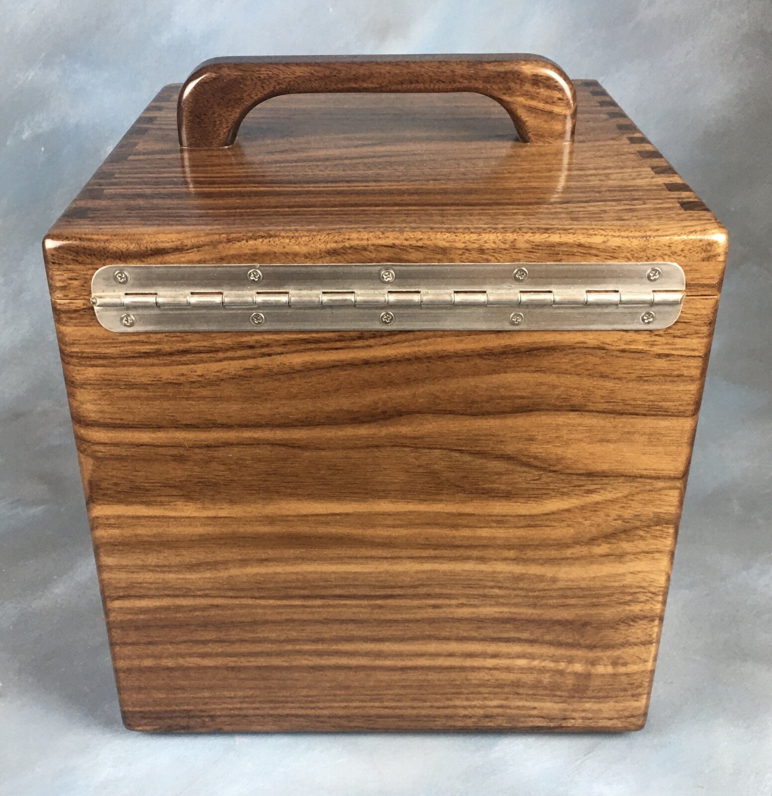

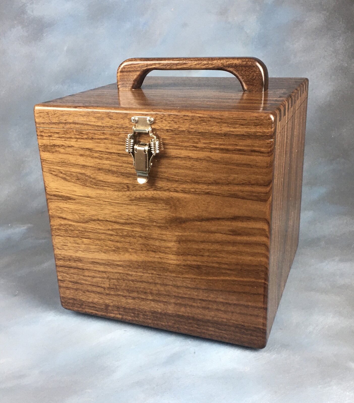

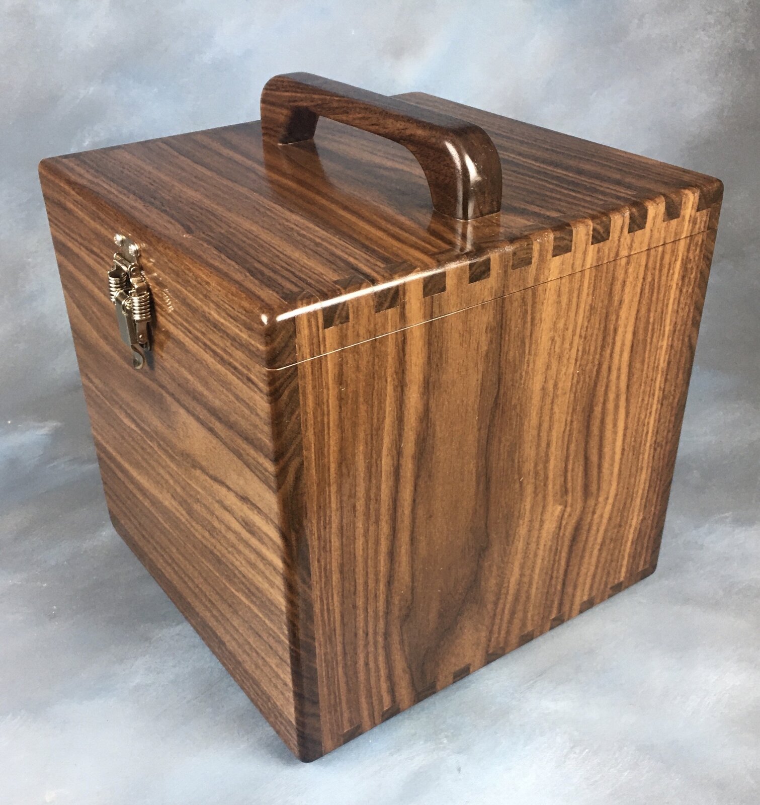

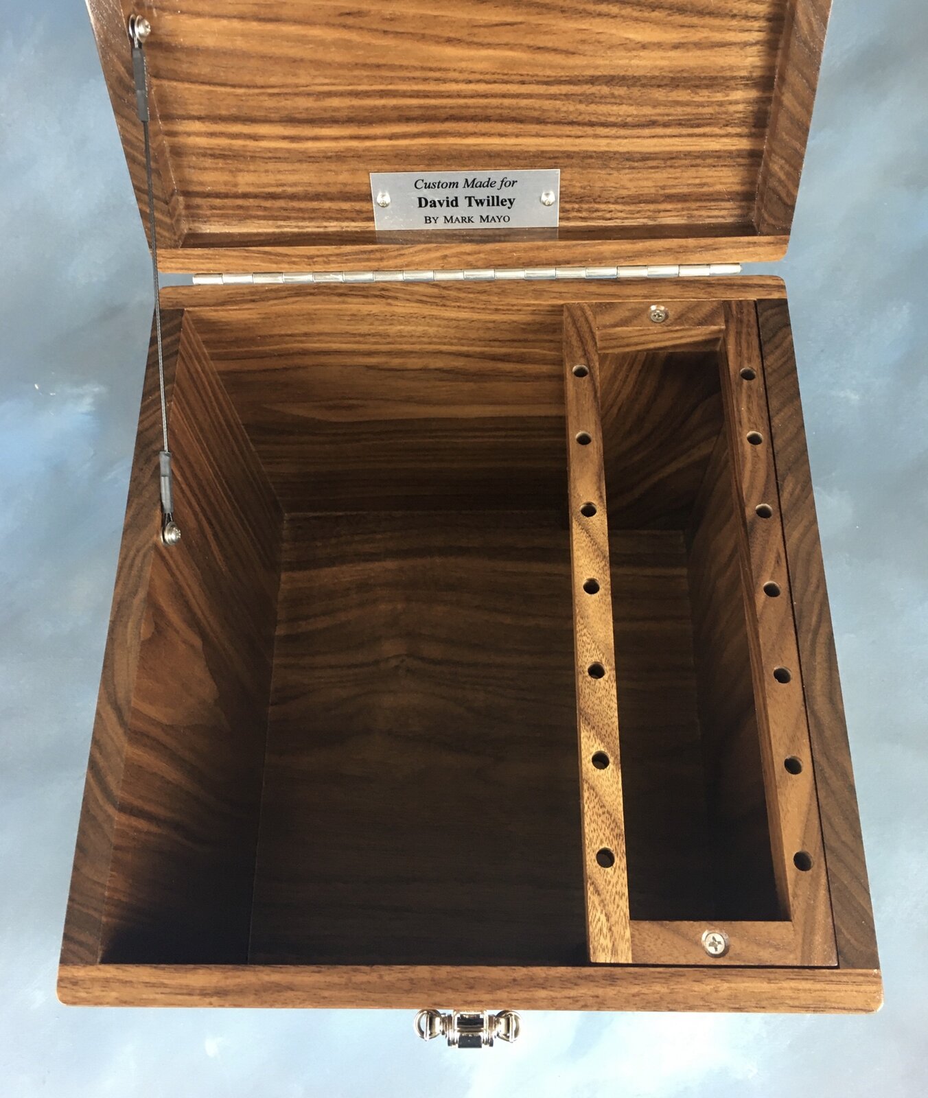

This American black walnut "Cube" fishing tackle box needed to get finished and head out.

Always admire your boxes Mark. I'm sure you've answered this before--but i'm curious about your joinery of the front and back panels. I have to believe it's more than a simple butt joint. Thanks!!
earl
earl
Those are called box joints. I use a <$100 jig from Rockler and spiral carbide router bits. They are a $&&@ to glue up but after that they are rock solid and pretty. I have a new, expensive jig to do the same thing and more but it sits in my shop starring at me.
Thanks Mark. Yep, 4 sides with box joints--and meticulous grain matching!! Real question is the attachments of the two sides that don't appear to be box joints--the sides where the hinge and clasp are mounted. Those look like they're just butt joint glued--any dowels or splines buried in those? (and i fully agree--as box joints are, they can be a bear. I use the Incra box cutting jig, and it really helps in dialing in the fingers which helps some on the glue-up)
earl

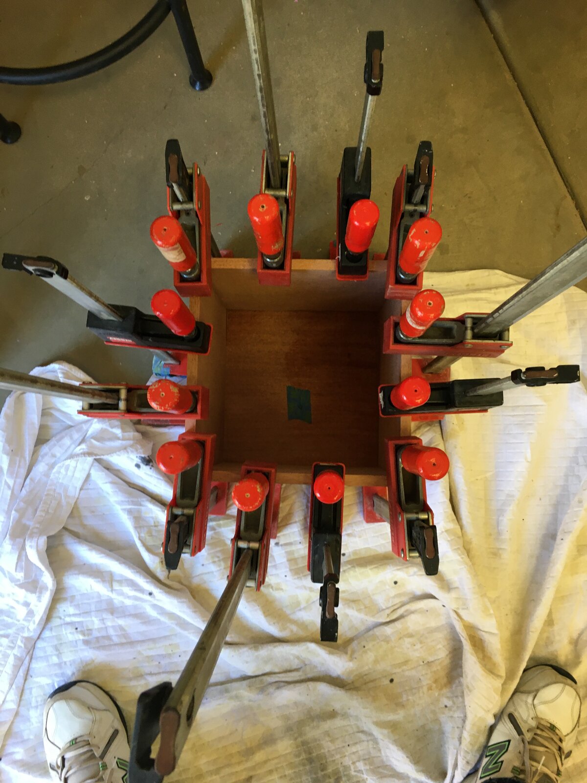

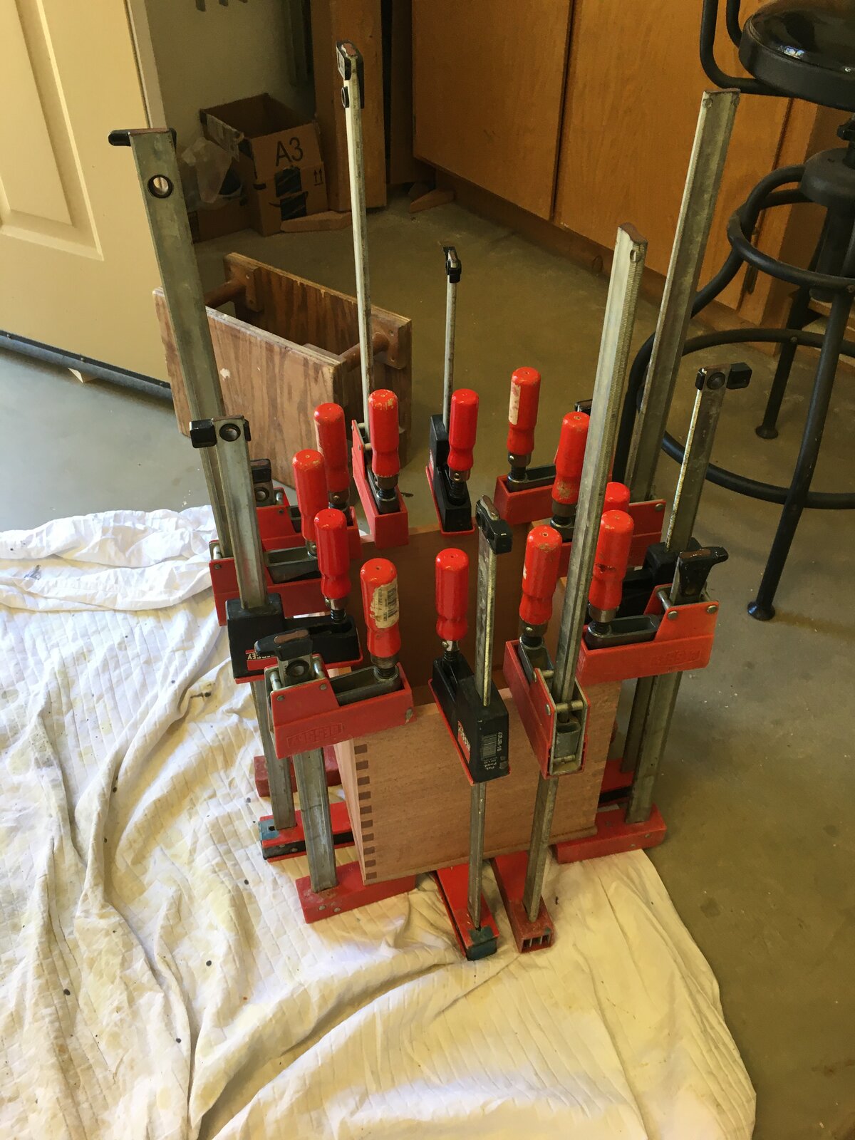

The front and back are joined long grain to long grain. Titebond 3 glue and a dozen clamps keeps them there.
