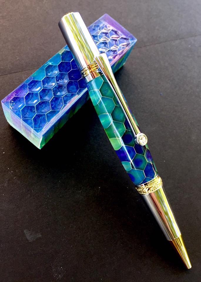

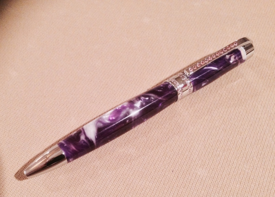

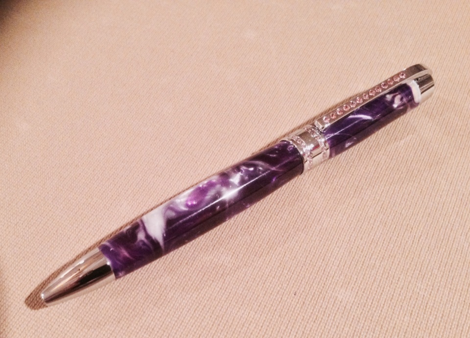

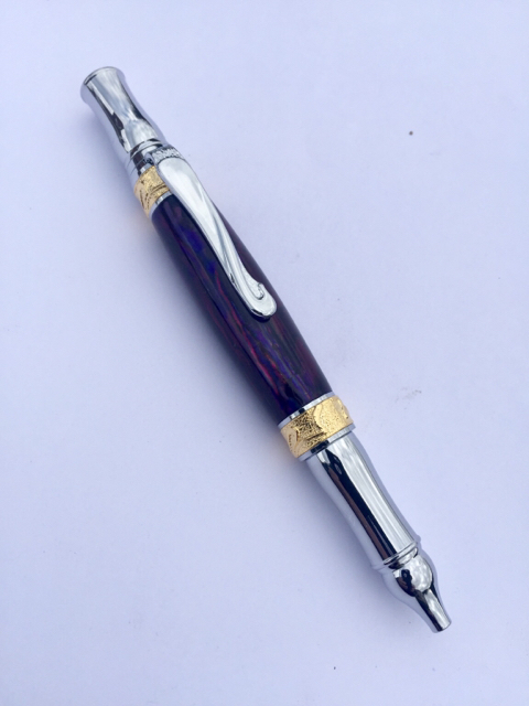

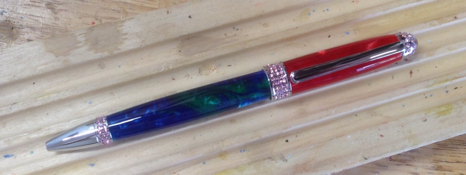

The new aluminum EDC Duraclick pens from PSI are lightweight; Also, I just received some Zoe pen kits that look promising, and have some bling (crystals on the clip and finial). Both use 8mm tubes.

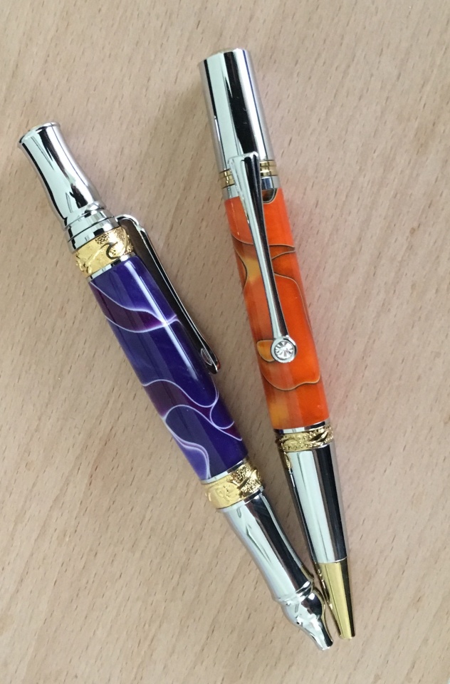

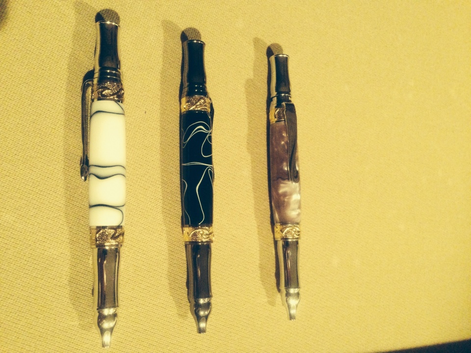

Princess
Bling

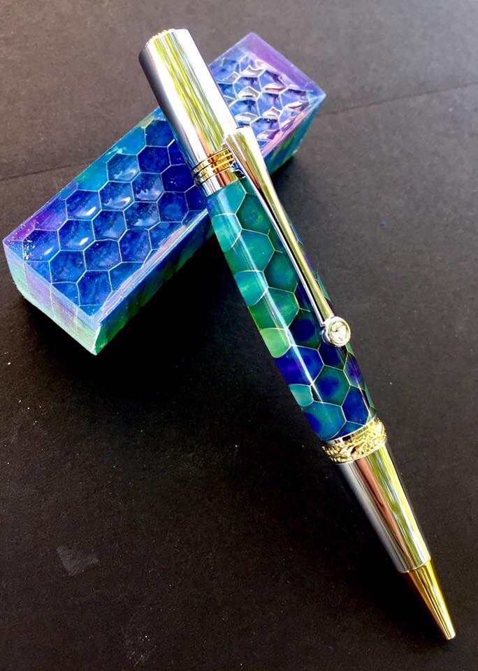

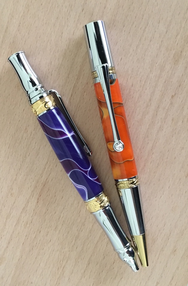

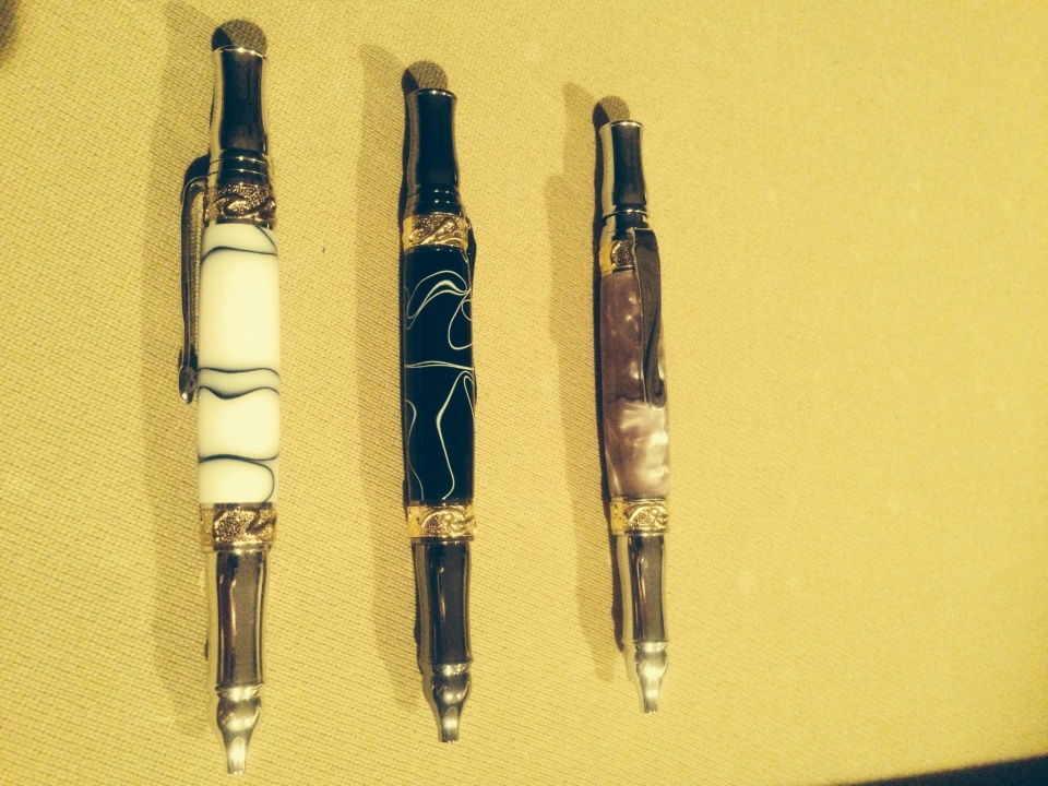

Nouveau Sceptre
Majestic Squire
All from. PSI

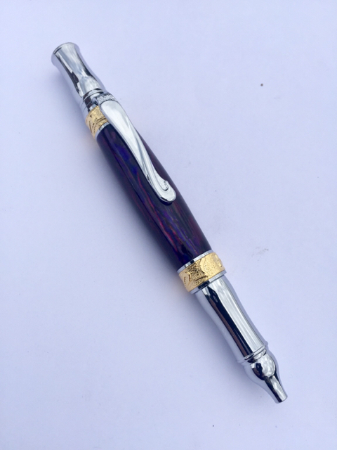

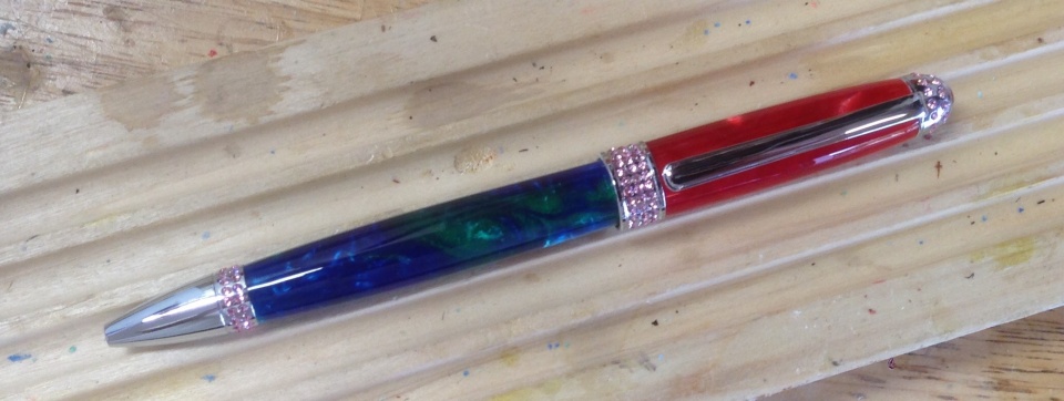

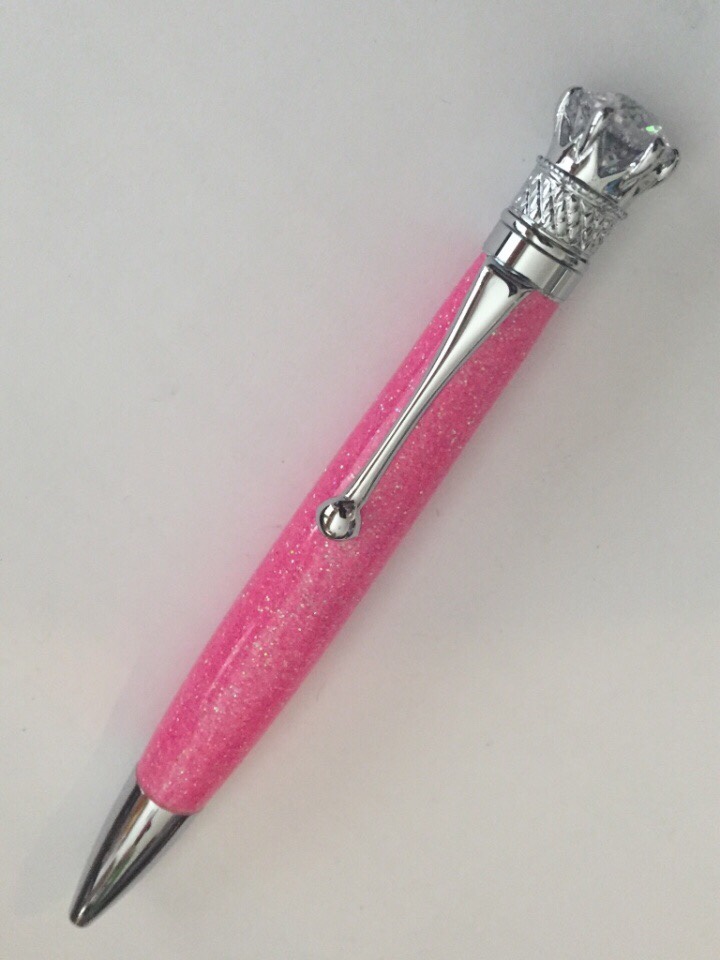

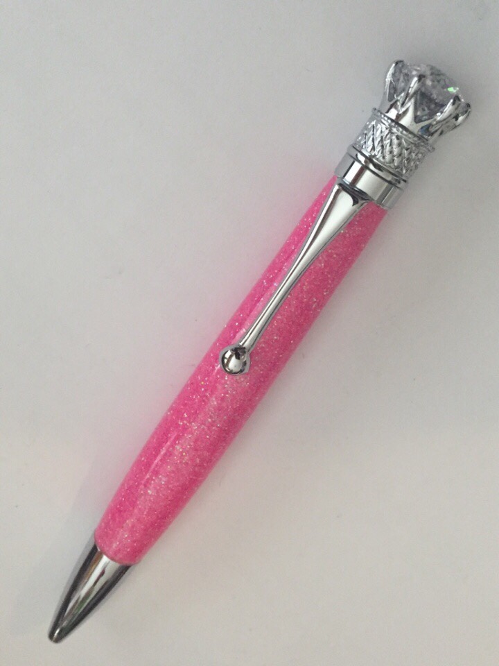

Nouveau Scepter and Majestic Squire have been popular for ladies but the Majestic can be a bit heavy. I've made quite a few Crown Jewels from PSI, not my thing but seem to be popular, low cost, and light with a longer barrel to show off the blank.
