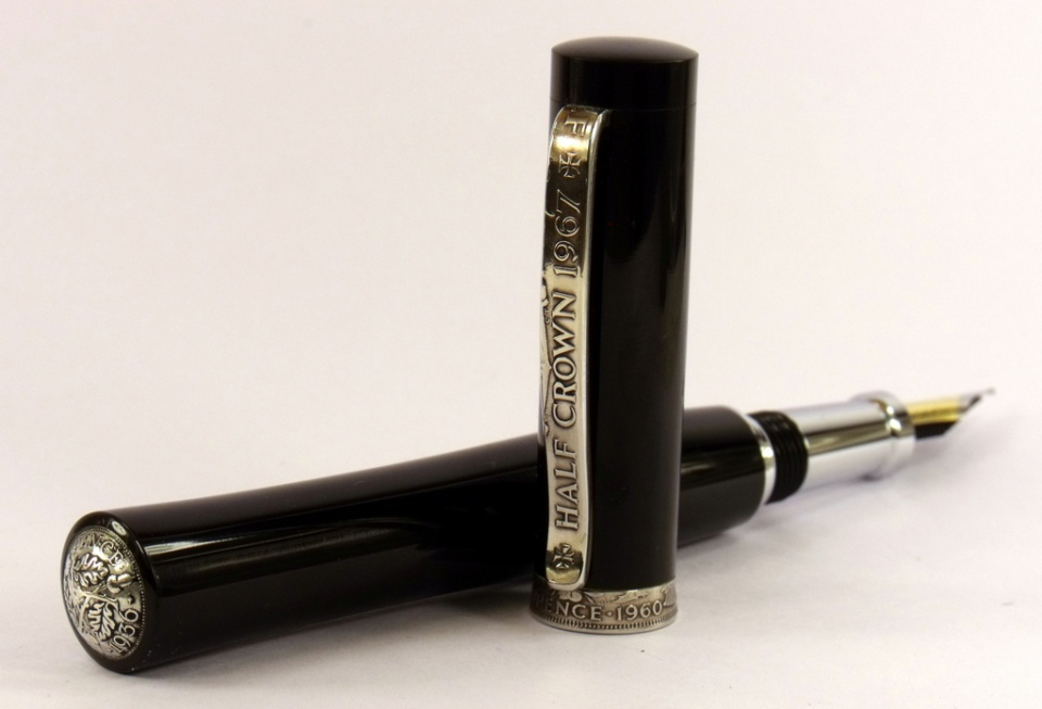

Hank has made my point about the raised image causing glue gaps....
I think old coins can be used much more nicely than edge on only. It doesn't take expensive tooling to use them like this one....

oh now that is just absolutely beautiful and something to really strive for (I'm a long long time from that workmanship I'm sure)
I do like every bit about how you've used the coins, just stunning!
