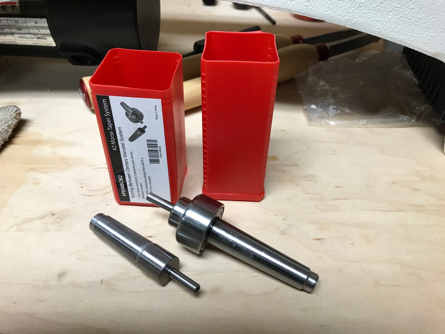

Initial Impressions:
I received the mandrel system today and took it for a test turn. I really enjoyed the increased accuracy of the system. I was able ti get very close to the bushings since the mandrel spins so true.
Pros:
Accuracy Accuracy Accuracy
The mandrel is compatible with all of my standard bushings (that work with a 7mm mandrel). This includes compound (center) bushings (see pic).
It's simple to use and changing out bushings is very simple.
Con:
Harder to manage 2 tube pen kits (compared to standard mandrel). I'm use to setting up the tubes on the lathe in their final orientation. I'll use my old standard mandrel for finishing.
Conclusion:
I'll never go back to a standard mandrel with the exception of finishing.
With cigar center bushing on left
With finished tube
