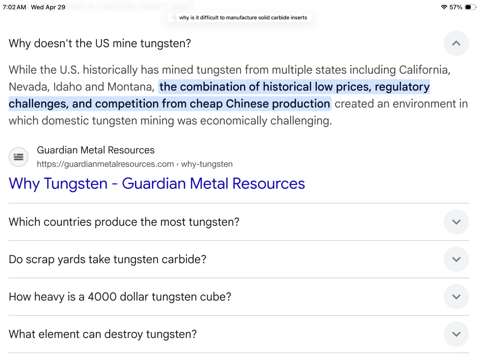

I very much doubt that the EWT carbide insert is American made. As someone who purchased thousands of inserts…the finest quality carbide inserts were manufactured in Germany (IMO). Most inserts are manufactured in China today and depending on the source of origin are good quality. But heck yah, if it makes you feel better then go ahead and purchase the overpriced EWT inserts. It may be of interest to read the attachment. Manufacturing solid carbide inserts is a very complex manufacturing process that requires precision,intensive knowledge and expensive equipment. Unlikely that a small
manufacturer from KY can successfully make carbide inserts in-house.

So they say. Please forgive me for having my doubts in terms of the inserts. No doubt about the tools (steel) and wood
handles being made in KY. Quite frankly the Caliendo's merely adapted to use the already existing carbide inserts that were
being used in the woodworking industry. Chris was quite clever to put the inserts and use them to produce TURNING TOOLS. I do not wish to stir controversy but merely wish to shed light on the origins and use of carbide inserts.

Hello wood-of-1kind. I certainly understand your skepticism on assurances of Made in USA products in today's great decrease in true global manufacturing. As one of the owners of Easy Wood Tools, I can assure you that 100% of our EWT Carbide Cutters are 100% Made in the USA. In fact, EWT was the first to bring replaceable carbide-tipped turning tools to market, with cutters specifically designed for woodturning as other carbide cutters used in industrial applications were/are too aggressive and not appropriate for turning. We are also the only carbide tool company in the USA that also makes their own carbide cutters, right here in our Lexington, KY plant. Chris at Easy Wood Tools has been an expert in carbide for 40 years, and prior to owning EWT we have been in industrial carbide manufacturing for 24 years (in the USA) with owning the development, design and manufacturing of all EWT's carbide since the beginning of EWT in 2008. Tungsten (used to manufacture carbide) is a mined mineral as a raw powder and most of the world's supply of Tungsten is mined from Asia. For our carbide cutters that powder is blended with other binders and formed with our proprietary "recipe" and finished with our proprietary grinding process to produce our sharp, long-lasting edge. All done right here in the USA. Below is a link to our video showing how our products are made by us, and at the 2:53 mark we show a small glimpse of our carbide manufacturing with one of our team members. Unfortunately, being that many wish to copy us we cannot show the entire manufacturing process. If you would like any other reassurance that our EWT Carbide Cutters are 100% Made in USA I would be happy to provide any information you would like.
