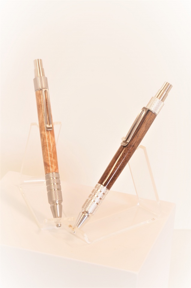

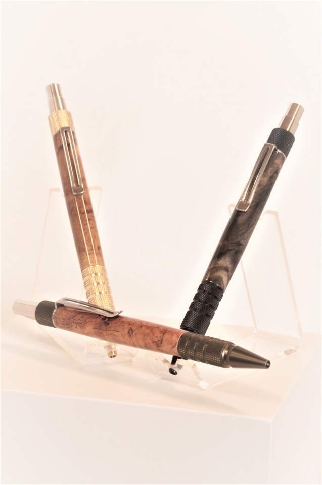

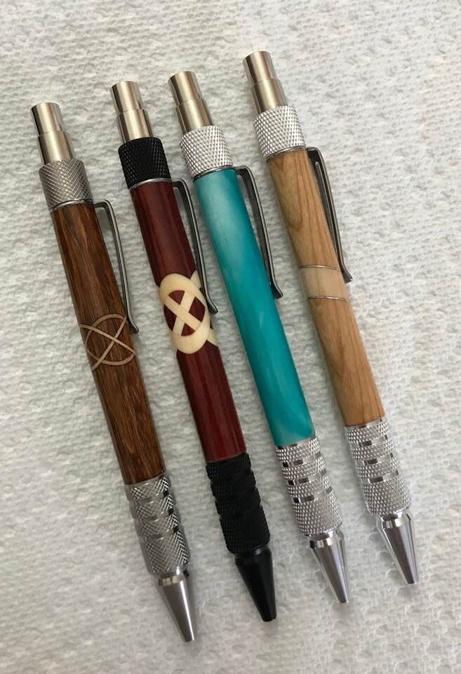

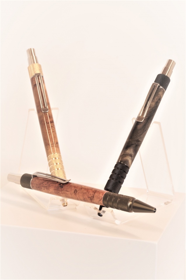

I'm always in the market for a new style and thought these might be worth a try. Ordered and received quick.
Observations:
1 - The PSI catalog ad says 3/8" tube. INCORRECT. It's actually an 8mm. Fortunately the starter kit and instructions are okay.
2 - There has been discussion (here) on weight. The finished pen (I used wood on all 5 I made) weighs about 12-13 grams (approx. 1/2 oz) more in the brass and stainless versions. The other 3 are aluminum or anodized aluminum. The aluminum versions are lighter than the other pens I make by about 12-13 grams (approx. 1/2oz). I don't see this as a bad thing. Some customers ask for a lighter pen.
3 - The click mechanism is a German "engineered" (not necessarily "made") Schmidt device. On inspection, it appears simple and precise. In operation it is very smooth with no audible click. I really like it and hope it can be adapted to other mfrs. It is, however, a lot shorter than the mechanisms that are currently being used. That presents an issue I'll discuss.
4 - The overall length of the pen (refill extended) is just over 5 1/2" which is consistent with most pens except the "Sierra"-style (LeRoi, Gatsby, etc). Those are shorter - maybe 3/8". In any case, a "refill extender" is included with the EDC to keep the length at 5 1/2". The extender adds 1/2". The extender can be eliminated if the tube is shortened but that would make the pen 5" long. Pretty short IMHO. I see this as a potential issue but, hey, we are turners. Can't we help a customer out by turning a replacement?
5 - The clips and click buttons are all bright steel or "chrome". I'm thinking it would be better if they matched the metal on the rest of the pen (brass, black, etc). I know, I know, more $ on an already expensive pen. But, to my eye, it looks "patched" together on the brass and anodized aluminum versions.
6 - The knurling is markedly softer on the stainless version. Because of that it is the version I prefer. The harsher knurling on the other styles seems a little harsh to me.
7 - Overall, I'm liking this pen. We'll see if it sells enough to get more.

Thanks for the review Ted. The longer barrel interests me, as well as the overall appearance. I appreciate your comments.
Very nice pens also! :wink:

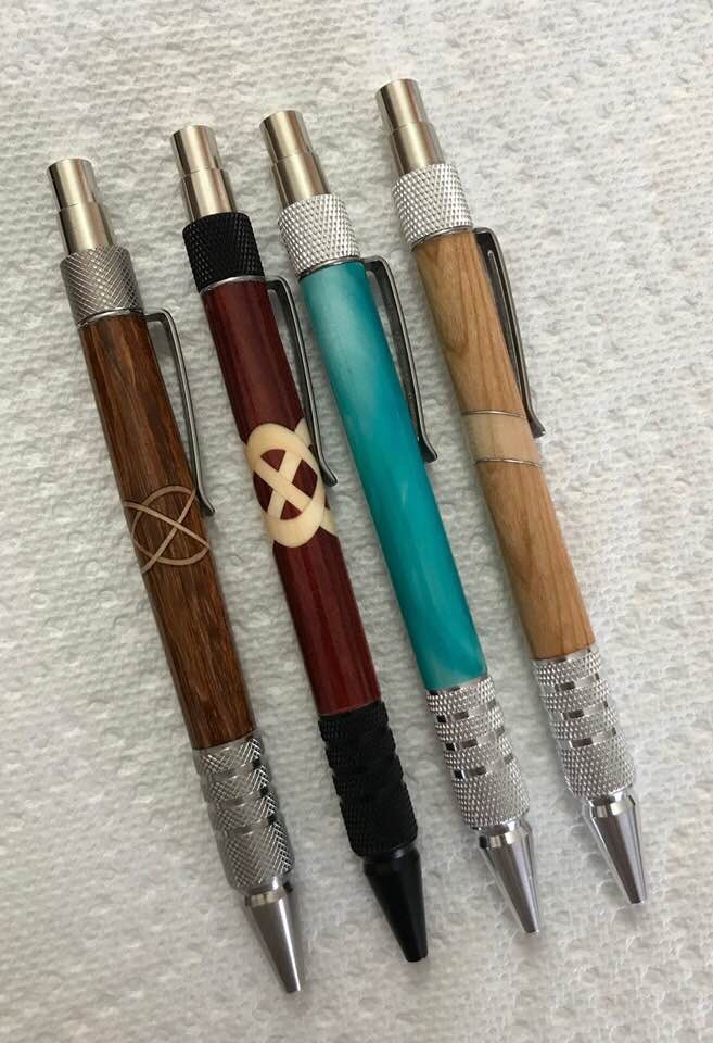

I finished my first last night. The "click" mechanism is smooth and quiet.
I like it a lot.
The aluminum ones are almost too light.
I would say it's definitely a guy pen style in my opinion.
I hope they use the same mechanism in other styles.
Lovely work, Ted ... thanks for showing. ... It is good to get this review of the new kit.
I hope PSI makes use of this click mechanism in other kits also. .. The world needs some more improved "clickers" !
Could you please just identify which pen is aluminum, brass, stainless ... anodized, etc. . would really like to know as I intend to order some today or tomorrow.
Also, please ... when refill is extended does the button stay depressed or does it spring back up?

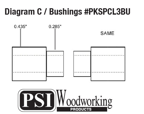

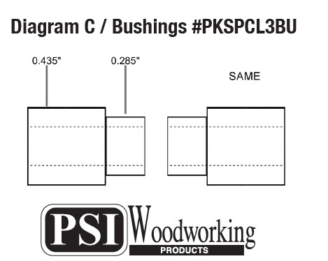

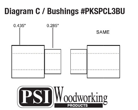

For a lack of a better word what is the dimensions of the bushings?? Or what is the amount of meat left on the blank when turned down B to B
Thanks.
As for the pen hardware ... from top left to bottom right ... would I be correct with this ordering of the kits :
Brass, Black Anodized, Bronze, Stainless, Aluminum ....... ???????

I will say this, I have made 3 of the 5 that I bought and have been carrying around the first for about 2 weeks. I naturally dropped it sever times, but it survived.
I see a relatively minor issue. The part of the click mechanism that screws into the cap coupler has to be tightened every few days. I guess one can use blue loc tite. I noticed this issue when after a day or two the point was not fully extending.

I have professionally machined bushings. I will send you the specs later JT.
The difference between 11mm and 7.32mm = 3.68mm. My guy makes them more snug (they slide in and out easily, but much less slop than the stock PSI bushings).
