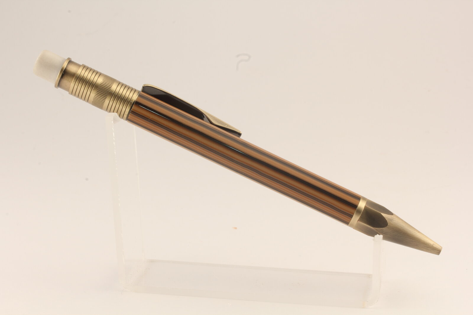

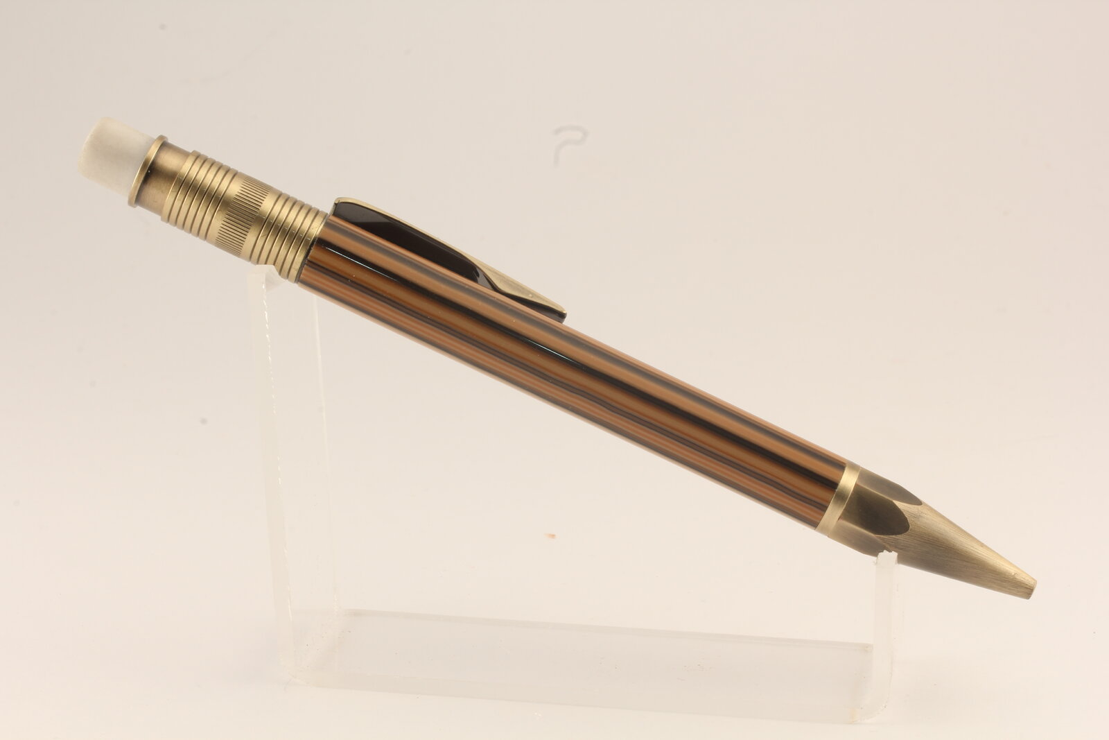

Mike, I can to the opinion that none of the .5mm kits seem as good as the old Pentels. I still have and use a few Pentels from the 1980s. I decided I like the 2mm kits, make quite a few of them.

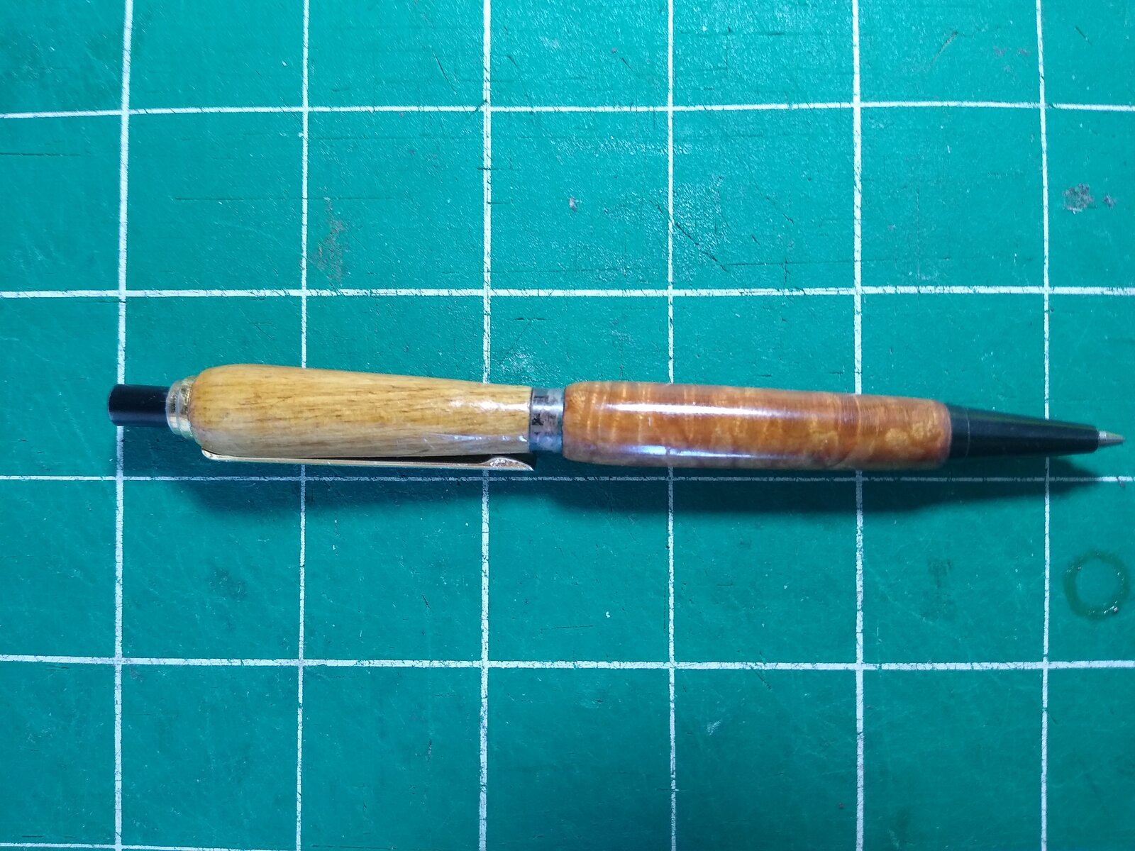

Thank you everyone for your responses. I really do like my pencil I made from Cherry burl and Cacao wood (Iong story on that one safe to say it is literally a unique piece of wood) and I made it with a slimline pencil kit from Rockler and have been less that satisfied with the mechanism. I don't know if any of these inserts can be used in a slimline kit or am I just stuck with an pencil made from beautiful wood with a lousy mechanism.

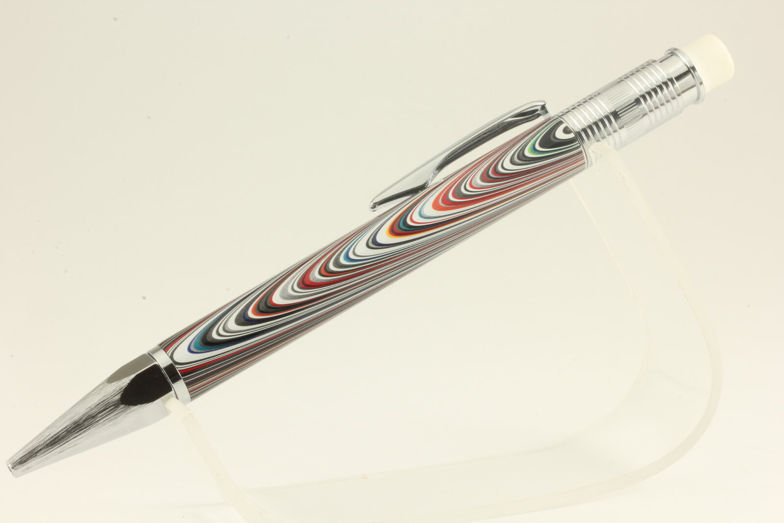

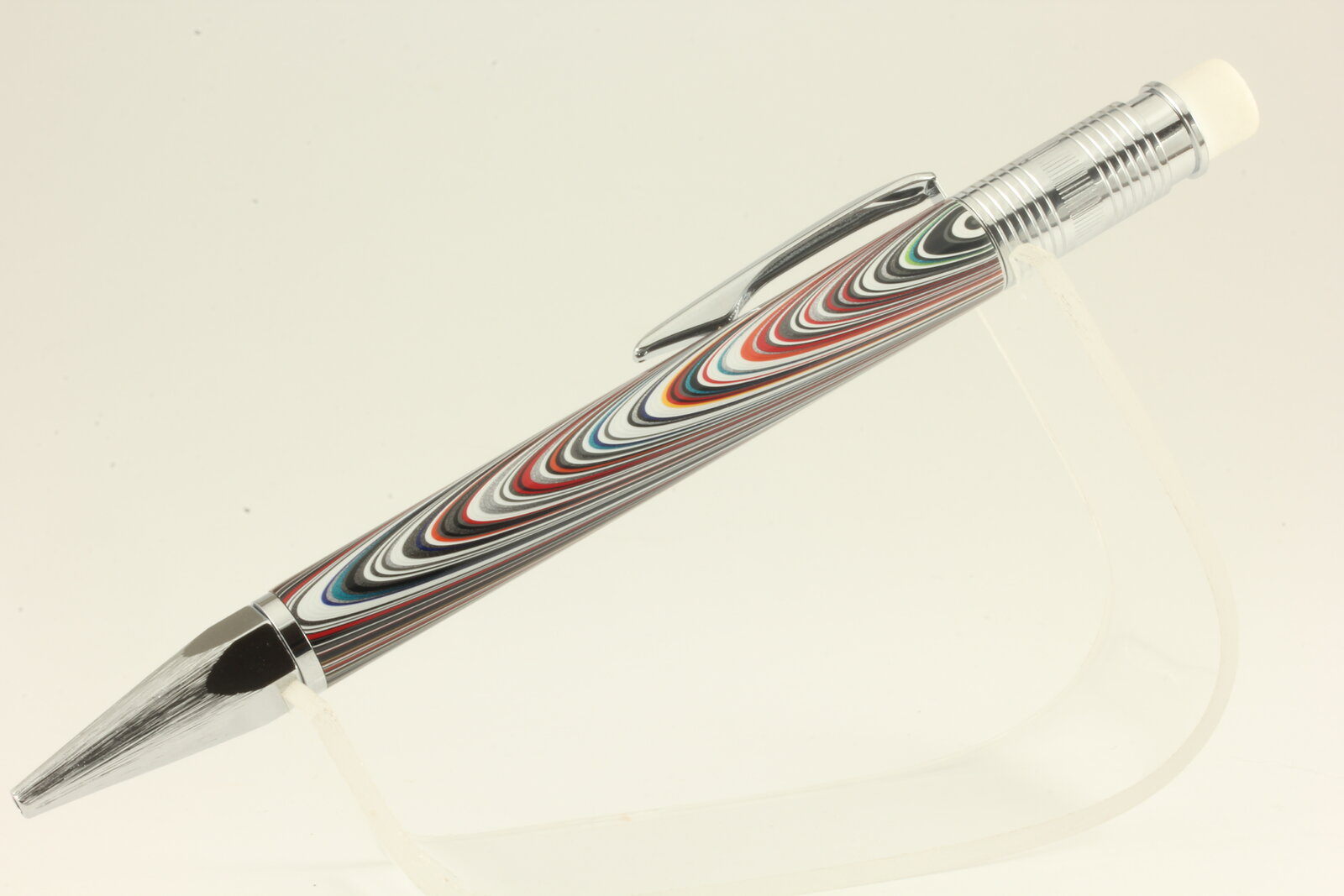

Mike, I can to the opinion that none of the .5mm kits seem as good as the old Pentels. I still have and use a few Pentels from the 1980s. I decided I like the 2mm kits, make quite a few of them.View attachment 240779View attachment 240777
I've been wanting to try those 2mm kits. How well does that built in sharpener work? Seems like it would be messy.
Sadly, they don't make many things like they used to. Unlike mass manufacturers, at least we take pride in our work rather than just profits.
Also, is that fordite!? It looks awesome! That stuff is hard to get ahold of. I would imagine it's very brittle, too.

The sharpener does not work well at all. I sharpen the way I learned when I took drafting a million years ago. I roll and rotate on a piece of paper.
#2 is fordite! Many people have nightmares with it. I started with a bench belt sander. When I did get it on the lathe all I used there was sandpaper, no gouge or skew. I have made 4 so far like that, all came out fine. No surprises. However that was a sweet piece, none have looked as nice as that one.
