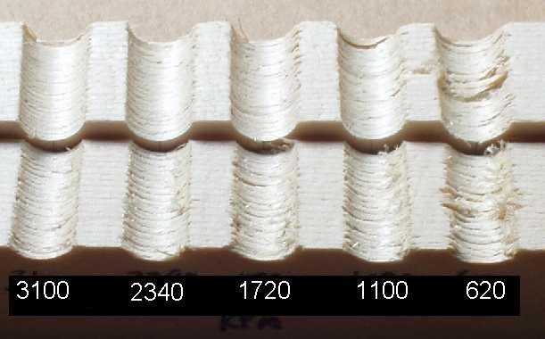

Without stabilizing them, you will need a VERY sharp bit. Some people will probably disagree, the the higher speed will cut through better than slow speed. Slow speed will allow a bit to catch, tear and shred the fibers, which will lead to a blowout. Since you will not have a lot of heat build up in a corn cob, it won't hurt to run the drill at the highest speeds.
Below is a picture of soft white pine and several drill bit speeds using the same bit. Notice how the slower speed tears the fibers. Tearing on the soft corn cob will lead to blowouts.
