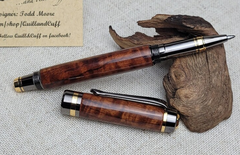

I really like this kit, especially the Classic Elite II, since it has a longer main barrel than the original. I don't sell a high volume on Etsy, but this has been pretty popular for what I do sell. Customers seem to agree that they are nice. The one below is also a testament as to why I love Granadillo.
Todd that is a beauty. The blank goes well with the kit. I will be getting some of these. May work for what I want to try. Thanks for posting the photo. Helped alot. Like that kit plating combo.
