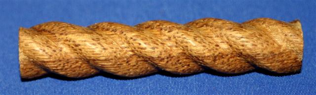

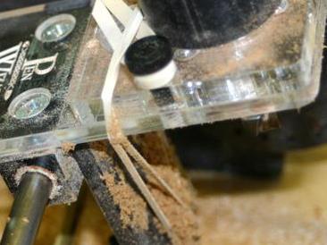

I finally set mine up and played with it last night for a while. It seems to be a pretty simple tool and I only ruined 1 blank because I forgot to do something. Otherwise, this thing seems to be able to do a lot of stuff that I couldn't do before and am having fun just playing with it so far.
I did something similar. I used rubber bands. Next time I'm moving the rubbler bands to go ever the front edge of the platform. Pictures below show the mod and the resulting successful rope twist.

I tried moving the rubberbands but they got in the way of both the cutter and the blank. I moved them back....used shorter and stronger ones. When I used them too strong they pulled the cutter into the mandrel and I have no more adjustment left in the screw. I backed off the tension (different rubber bands) and here is the result. Although I;m pleased with the performance and I'm glad I can do these spiral rope cuts, I don't think I should have had to modify the PW this way. The rope twist cutter may be the only one that gives this problem. Here is my next rope twist.

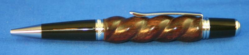

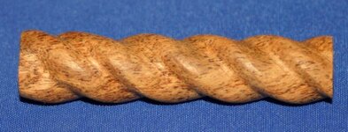

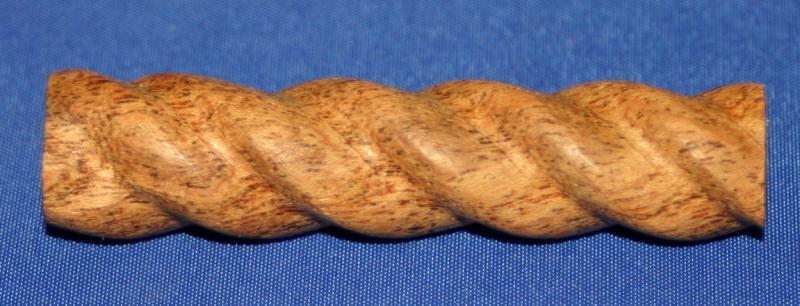

Don, that looks really nice. It looks like mango wood to me. I certainly hope JR Beall is reading this and will come up with an improvement to the mounting plate to permit rope twist cuts.
Steve
Thanks Steve. I think JR has been reading this thread. The first rope twist pic is mahogany and the second one is mesquite.
