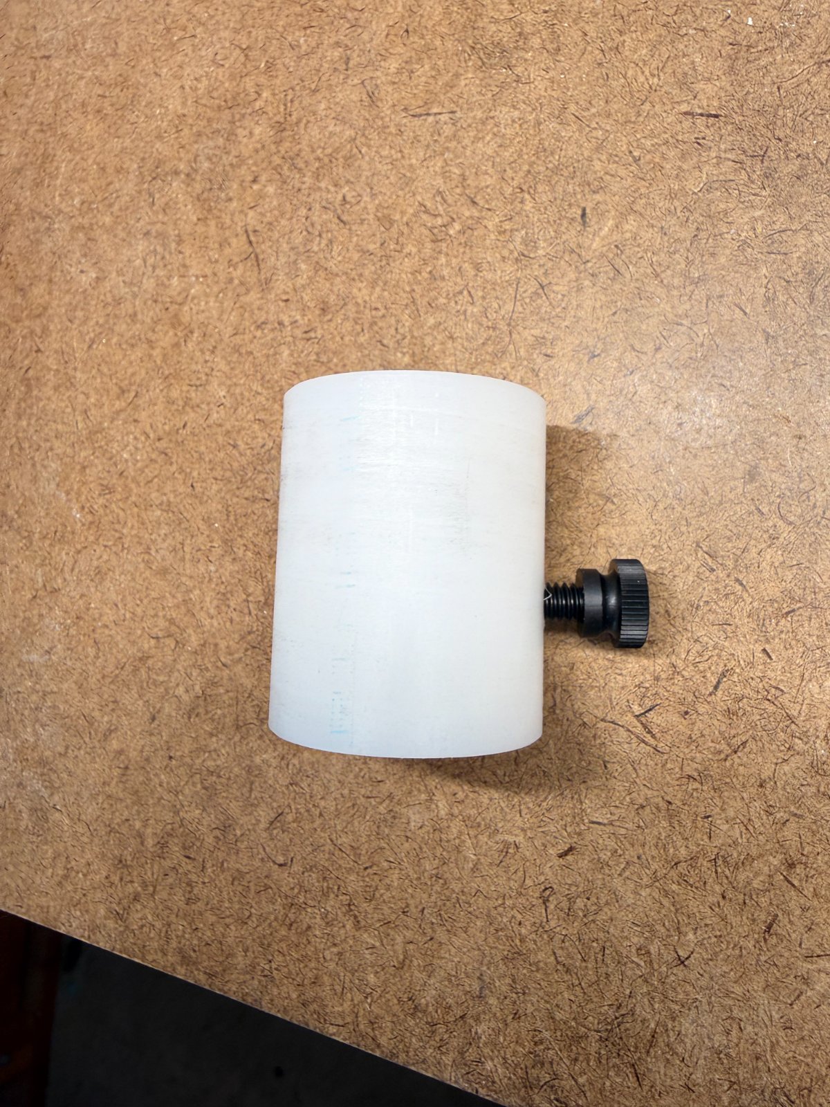

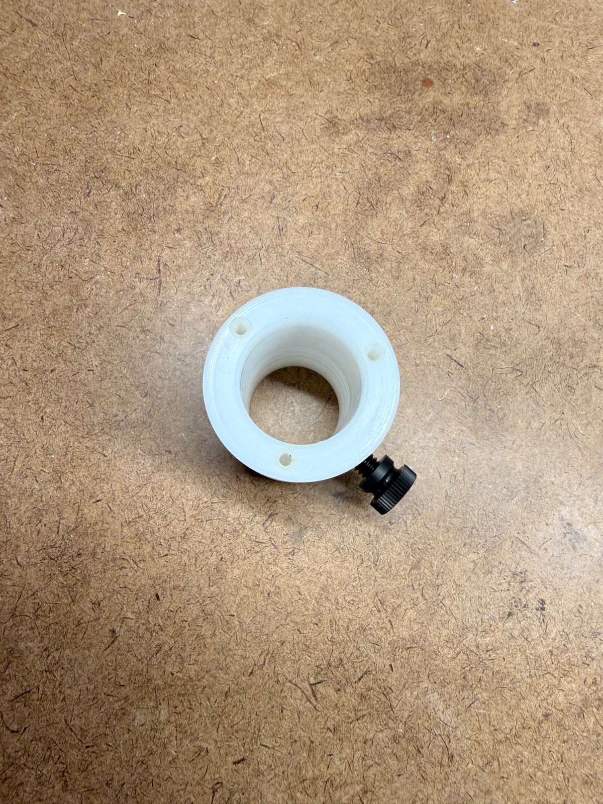

Hi Bob,
This may be the item you are looking for. The tube looks like it is made from delrin or similar plastic material. The OD is 1 5/8" and the ID is 1 1/64" and the length is 2 ". The hole for the black anchor bolt is 3/4" from the closest end. The three holes on the top line up with the three holes on the tool holder on the Pen Wizard. I hope this helps. Let me know if you have any other questions or need any other measurements. I bought mine a while back and have just started experimenting with it during the last few months. There seem to be a lot of possibilities.
Tim

Hi Bob,
Tim
Thanks so much.......THAT'S IT !!! That's easy to turn on the lathe and should work perfectly. Was mentioning earlier that I finally after 3 months of looking located what looked to be a nice Pen Wizard on Facebook Marketplace in Edmonton Canada. Yesterday as I was about to finalize the deal and send the money I was alerted this was a Scam by Meta Facebook. So now I'm back to square one once again looking for another Pen Wizard to purchase. So close, but so far away. Oh well, least I didn't loose hundreds of dollars and thank goodness I was alerted. Thanks for the pictures.....soon as I ever locate another Pen Wizard I'm hoping to build this. Really appreciate your sending this.
