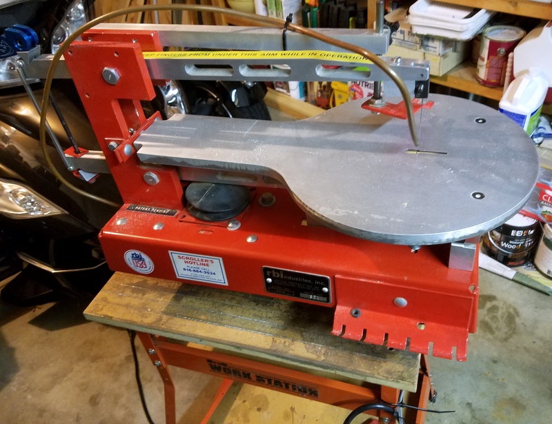

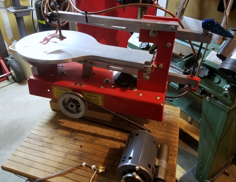

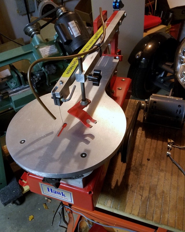

Here are photos of the ShopSmith scroll saw. Not trying to sell it on this form. Just for information for those who own ShopSmiths who might be curious.. I just motored it and used it that way. I used it as a single speed and it worked beautifully. I have since acquired a larger Hawk VS saw. Hawk is made by RBindustries a premier manufacturer of scroll saws.

Looking for pictures of one of those Hawks set-up on a SS. Looks like it is a SP that runs on the main/upper drive. You did some modifications to get it to run off a belt from what I am seeing. Just did a pulley or more?
