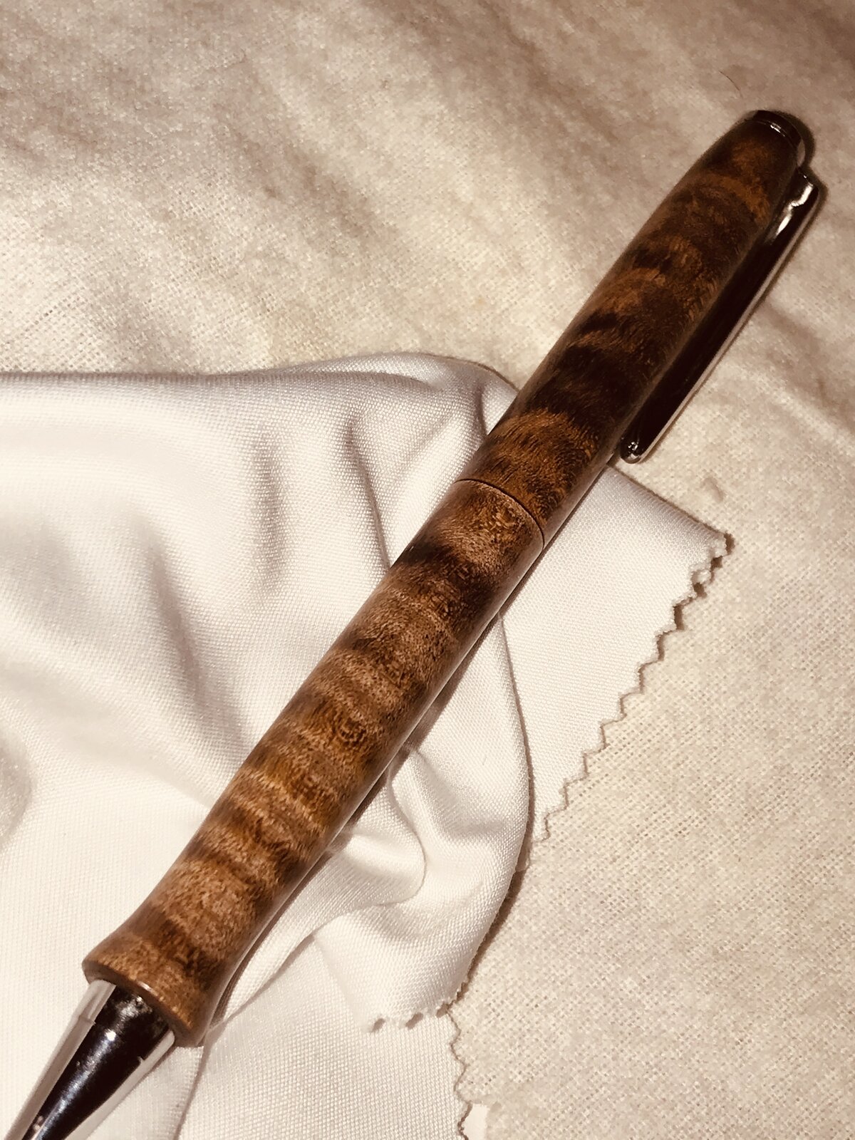

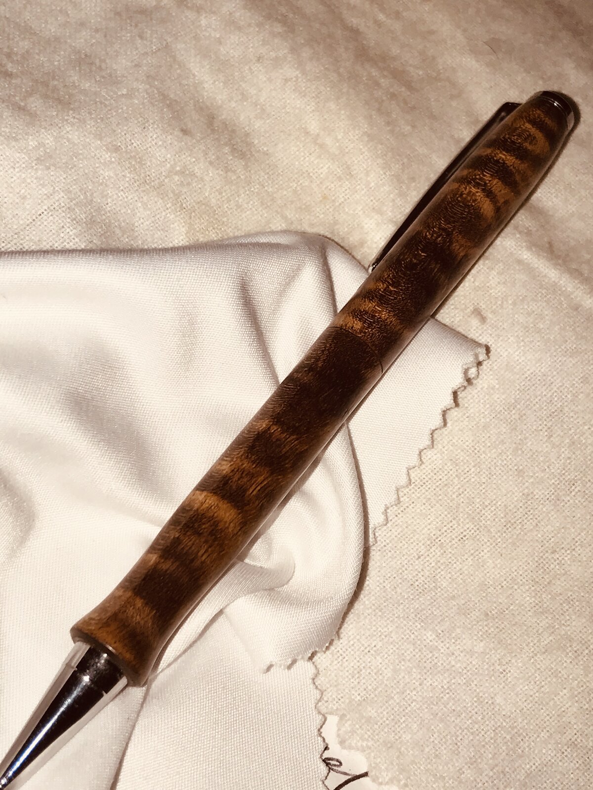

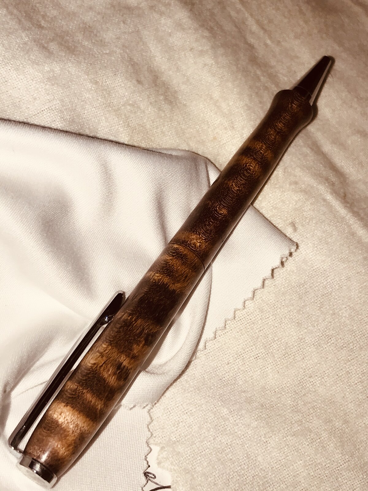

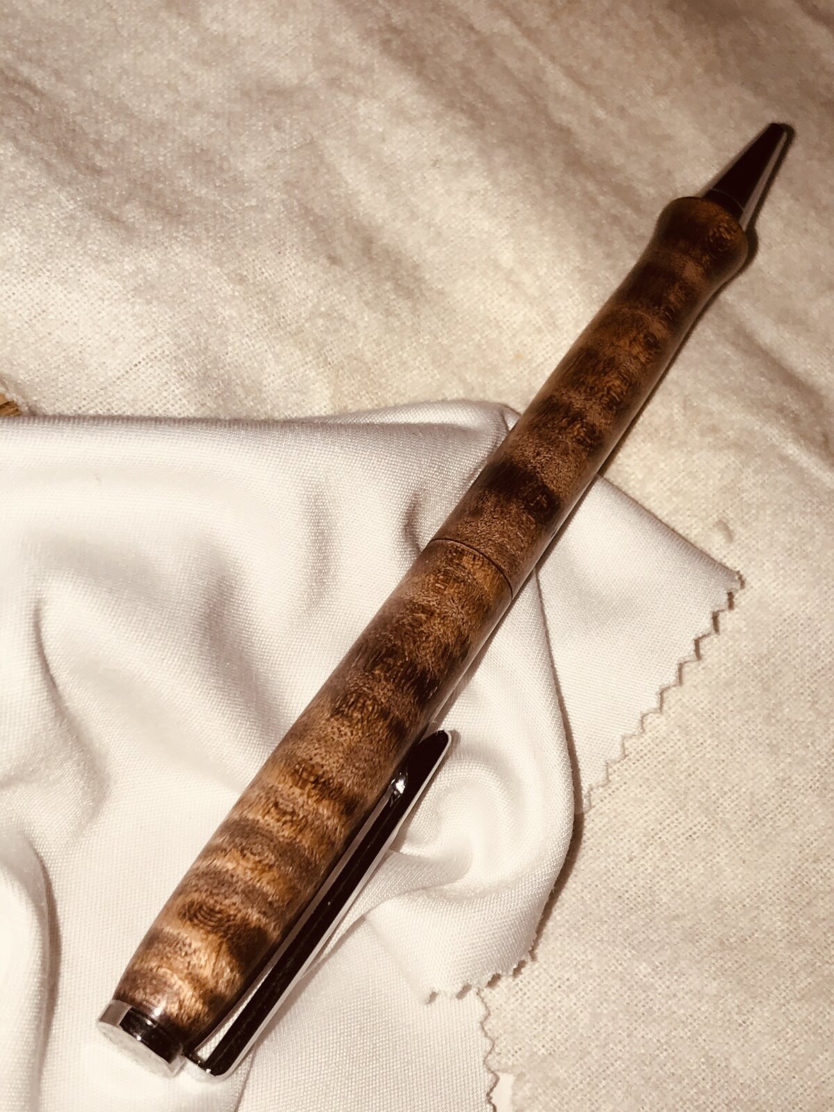

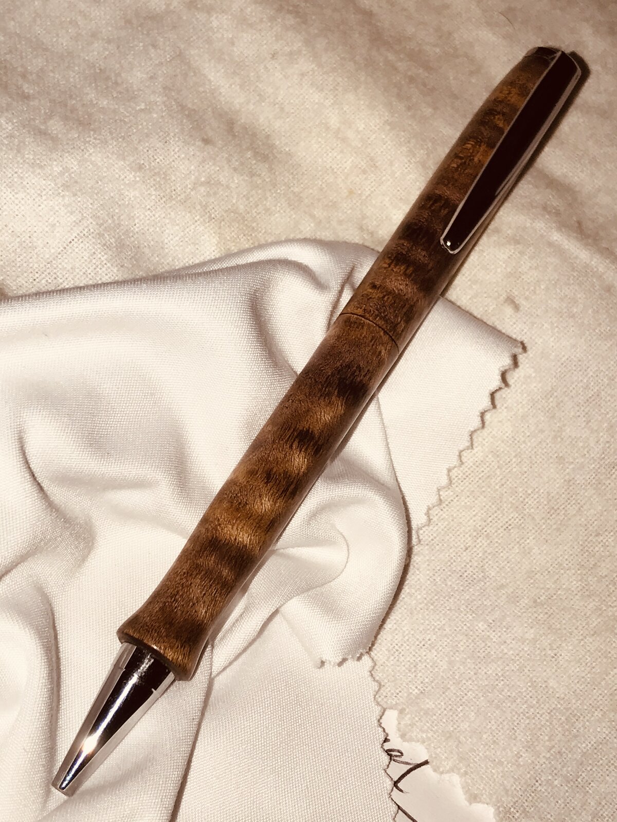

I started off with a non-descript blank taken from a box of of figured maple. If there was ever a plain vanilla pen blank, this was it. Anxious to try some of the help I received yesterday and this morning I launched into turning another pen.
This pen never left the lathe; following developing the profile with carbide tools, the lathe speed was reduced to about 700rpm - as low as I can go without changing belt pully configuration. Sanding was done dry, with a light touch: 320, 400, 600, 800, 1000, 1500. Next was a DNA wash, followed by several coats of a proprietary stain. In between costs of stain, was w DNA wipe down. After the stain dried, 2 coats Myland's Cellulose Sanding Sealer with buffing in between using Mirlon Tan/Gold - all on the lathe. The finish was 2 coats PensPlus followed by 2 coats Ren Wax. Between coats pen was lightly buffed with Mirlon Tan. The various pics just show the pen from different perspectives.
Thanks for looking! Comments are encouraged.

Sounds like a sows ear to a silk purse kind of thing. You have the magic to make plain wood come alive. Great pick on the kit finish. Beautiful and thanks for sharing.
