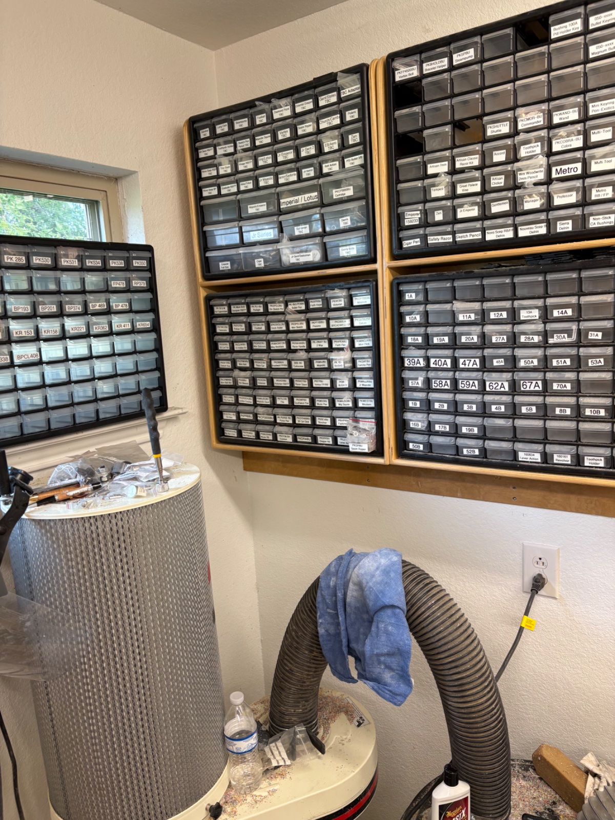

Here's my process. I just ended up with s lot of bushings over 20 years. Not worth my time to need to check for what "could" work.
