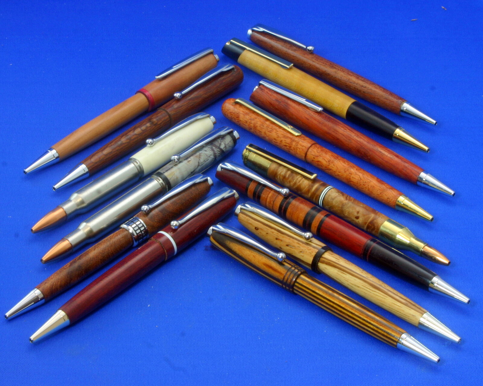

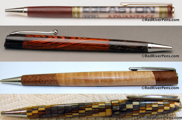

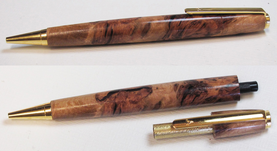

Thanks a lot...I appreciate the positive review. Here are pictures of what can be done with the "lowly" slimline. 1000003317.jpg

I contacted Easton about the 2213 arrow. It has an ID of 0.317. That was the only one that had the spec's as now they go by the flex of the spine. Don, I could use the logo area plus pieces from the camo area. Could get several pens out of one arrow. Yep, I'm cheap...so cheap, they have my picture next to the word in the dictionary.
To see more details and instruction on what Don has posted, you have to buy the book. Well worth it!
Those arrow instructions are old enough that the numbering system ma no longer be valid. The arrows I use are aluminum shafts and carbon fiber arrows are popular now. I have not used carbon fiber arrows.
One arrow size lends itself to gluing a 7mm tube inside. Others are large and I would turn a wooden sleeve with a 7mm tube and glue the sleeve inside the shaft.
Let me know if I can help. I may have some arrows if you need any.
Don, I have many old arrows that I could use. I need to "mike" the tubes and cut the arrows to get the ID. I recall the wooden sleeve in the book.
Arrows have gone from the 2213 and such dimensions to a number designating the spine which determine the flex for a certain draw weight of the bow. To me, the numbers are arbitrary. The new numbers are like 500, 400, 340, etc. Charts are available to match the arrow to your specific needs.
