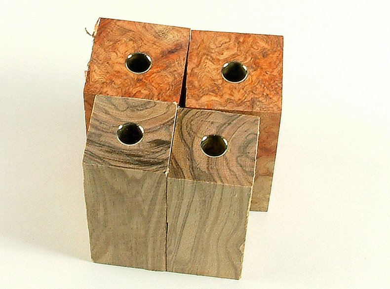

Steve this my Pen Mill best part of 20 yrs old now used to be the only pen mill when I started
made of high speed steel it is ground carefully please note how it cleans and champhers the entry, I use it from either end and square the blanks carefully beforehand on a 12 inch disk sander fitted outboard on an old Woodfast lathe. Please see the result on the pic. Also the last 90 blanks I prepared and glued 9 brasses were too small in diameter and chucked in the bin then by way of the Irish to be sure to be sure I checked from each end of the blanks two days after drilling another magic 11 refused entry through the timber so redrilled by hand drill in a hand vice..
I am never totally comfortable with any process now without checking beforehand.
How I discovered quickly I had made a brass stepped holder to hold the brass while roughing the bras no way would the nine bad ones fit on the first step so I have renamed it go no go guage.
Kind regards Peter.

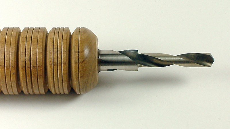

I bought a set of inexpensive drill bits from HF in every size known to man (except metric, had to buy those separately).
115 Piece Titanium Nitride Coated M2 High Speed Steel Drill Bit Set
I can find the right sized bit to fit inside any tube. I just slip it in and spin it gently by hand to remove burs and excess glue.
It also means I don't have to buy a bit every time I try a new kit.
Sharon
