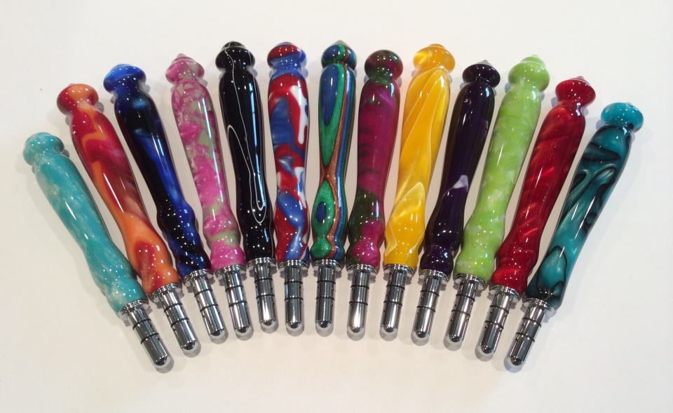

Here are some closed end seam rippers which are a little longer than the tube. They fit in the hand very well with little force required to grip them. These are a little larger but can be made any size needed. These are from Woodcraft and don't require a spring sleeve inside the tube.
