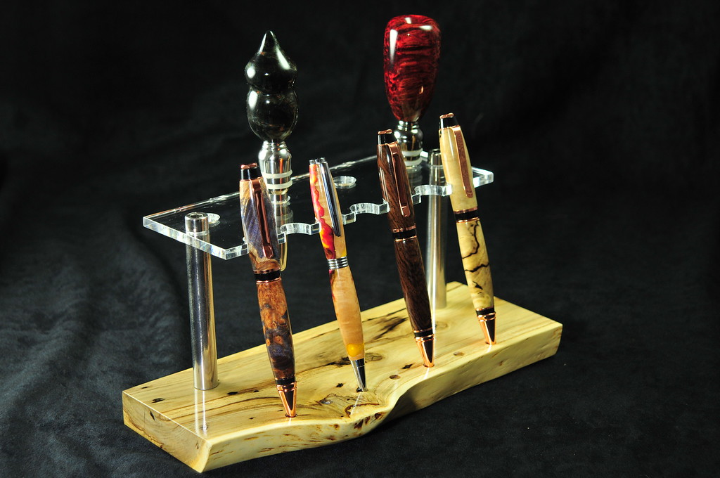

Made this simple pen & bottle stopper rack last week to show off my Son's work.
(Pen furthest to the right and the stand base came from the same tree)

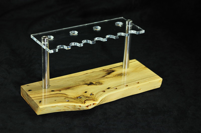

Looks nice. I'm intrigued by the two posts holding the acrylic. Are these commercial items, or did you turn those? It looks like the ends are caps that thread on?
It's just stainless steel pipe. (cut from an old cabinet handle). I machined aluminum inserts that press fit into each end, drill & tapped the them before press fitting. Allen bolts at the top are also SS, but had to polish them to match the SS tube.
