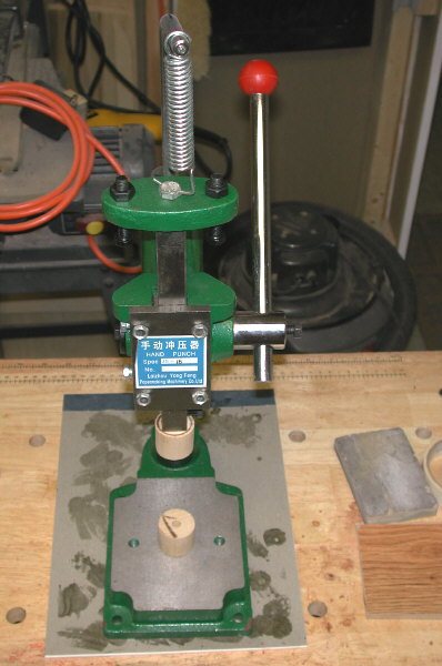

I, too had problems getting a "straight" incertion of the nub end. I ended up getting a 1/2 ton arbor press and it is just beautiful. Here's a picture:
<br />
I turned two wooden pieces; one to soften the pressure from above, the other used to align the pen parts during assembly.

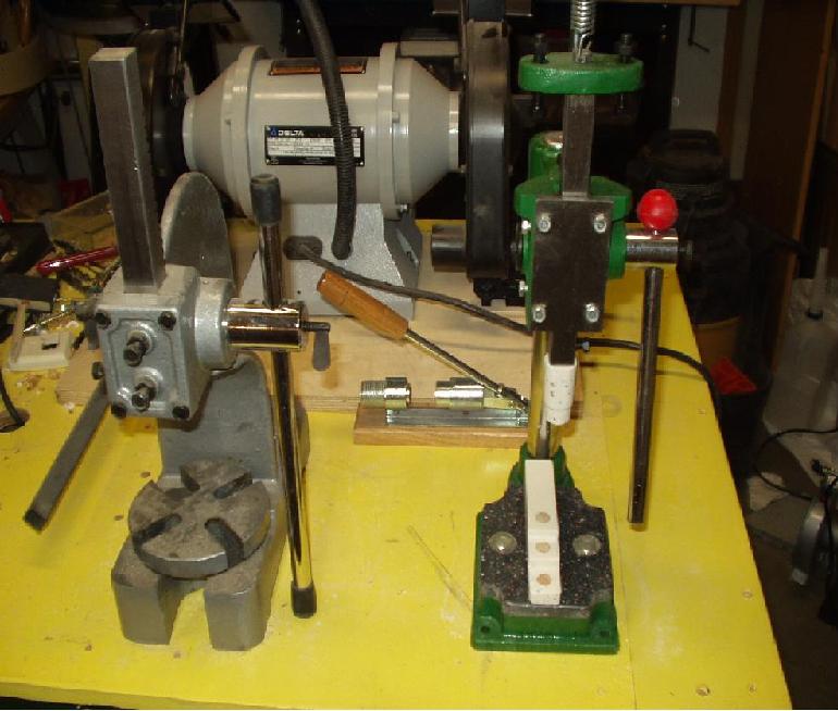

This is the Set-Up I use... [8D]
The Arbor Press is on the left... The Paper Punch turned Pen Press is on the Right. The "Pen Press" has a Bolt embedded in Corian. The bottom is recessed to align the Pen... Both Work... The Arbor Press is due an Upgrade...
